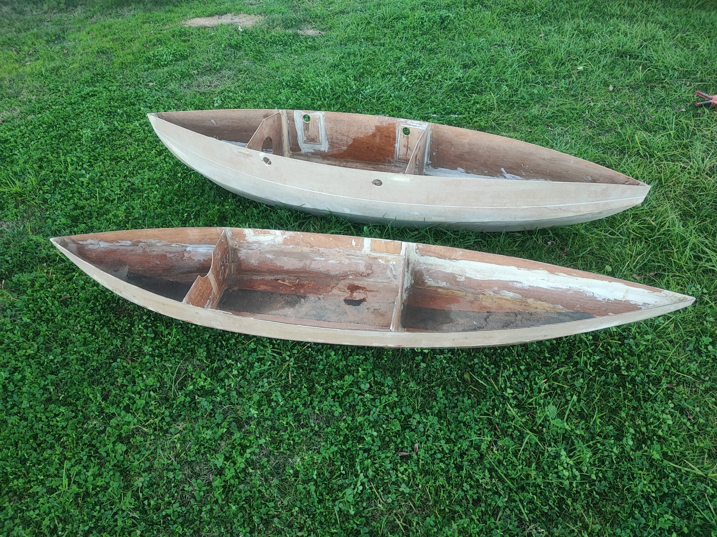

    IMG_20250726_175041.jpg IMG_20250726_175041.jpg IMG_20250726_175023.jpg IMG_20250719_133709.jpg
    Hello... After a rather disappointing epoxy application and just life getting very busy, the project got relegated to the rafters where it has gathered dust. I had come to realize there was way too much boat above the waterline. Initial tests on a windy day has the thing blowing all over the place. Not ideal as wind is no fun in a kick boat.
    So it's now mid winter and I choose now to get it down, man up, and just cut roughly 5 inches off the top of the hulls, and soldier on in a more freeform fashion. I did prior to cutting it, do a test with a bunch of exercise weights, 5 liter water bottles, a cooler full of water and a 20 liter bucket. Close enough to 95kg. Then took note of the waterline as a guide to how much to cut off. I also did a in use test and kicked around on it. It felt surprisingly stable and very easy to turn and propel even without flippers so that was very encouraging.
    So now it's onto glassing the insides, glueing on the decks, doing some inwales on the middle sections with tie down points, glassing the hulls outsides and figuring out how to attach the seat H frame to the bulkheads and make them a bit stronger. I have some ideas.
    Open to any advice... Thanks

    The rabbit holes we travel down.... My first thought would be to build foam strip hulls and heavily reinforce the keel strip. But with symmetric fore and aft hulls you could could make one half hull mold and cast four bits......
    Actually your project looks interesting and doable, the multi chine hulls with drop down ends are a significant improvement over initial design.
    Since you are now in construction, peel ply on glass work will simplify your life.

    Yes I'm using peel ply now! Did quite a lot of sanding . I have been building up the 4 bulkheads with some fairly heavy cloth and epoxy as they will transfer the weight down to the water. Still not too sure how I'll go about fixing the frame to the hulls just yet. Nor what to build the frame from. I'm wondering if just the glass tape and a coat of epoxy on the insides of the 4 closed sections will be fine
    Not too worried about strength. I'm not even sure I need hatches on the 4 closed sections. Perhaps just drain bungs.
