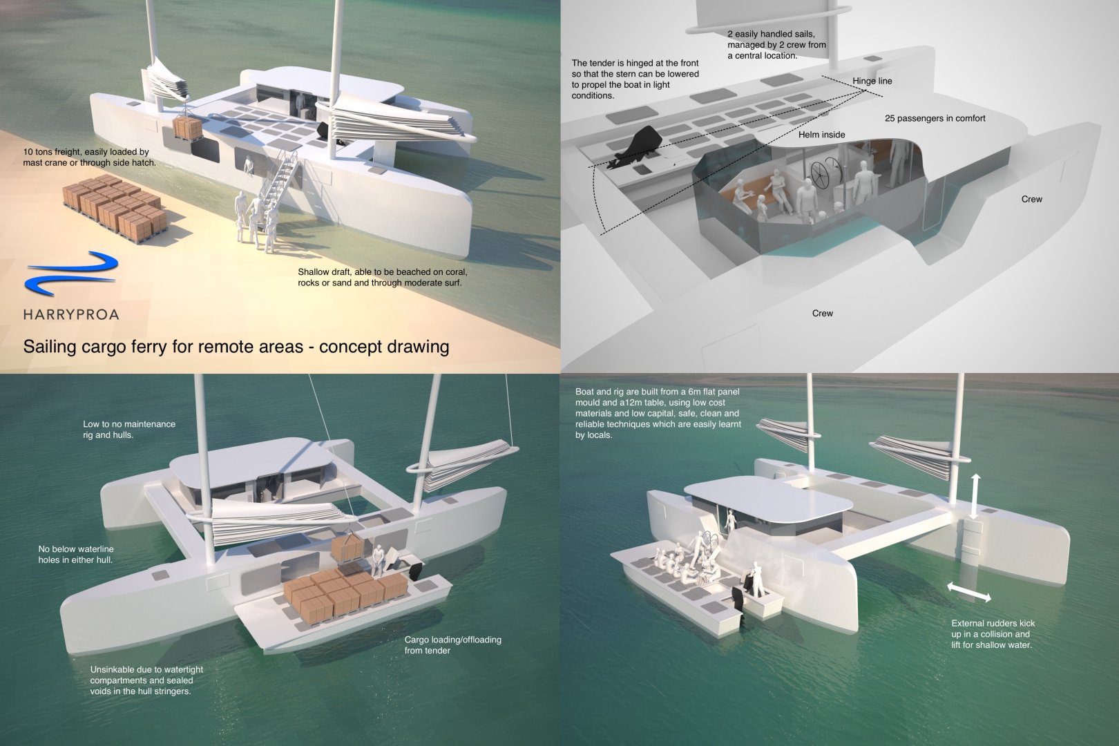

    A cat is a poor choice for a cargo carrier as it must be engineered to carry it's full load. ie, the rig and the beams have to be engineered to handle the fully loaded boat. Consequently, they are heavier than they need to be the rest of the time. A proa, on the other hand, carries the load in the lee hull, where it has no influence on the righting moment, and hence the rig and beam weights. This makes a significant dfference to the overall weight of the boat, it's cost, performance and it's handling. See below for some examples.
    The version shown carries 25 passenger on shortish routes. We have drawn a similar one for adventure cruising for 17 people for 2 weeks at a time for a client in Singapore. Accommodation for 8 people would not be difficult.
    It has 10 ton/22,500 lb payload as well as the passengers.
    55 gallon/200 litre drums are easy freight in terms of handling and stowage on the boat. On shore, not so much unless there are forklifts and trucks. Our research showed smaller containers were preferred by remote communities. Reducing the payload would allow a narrower, lower lee hull and smaller rig, which would be cheaper. I would not recommend going much shorter as length is easy speed, good seakeeping and low cost.
    The latest version of the cargo/ferry has been put through the design spiral a couple of times and lost a lot of weight and windage. Unfortunately, I cannot show this until the client says so.
    the deck space between the masts is 10' x 20'. The booms and the masts are used as a crane. The main halyard winch has an electric handle, so lifting and lowering is easy. Additional space could be added outside the beams, but unless your loads are large and light, would not be needed.
    The cargo ferry draws 500 mm/20" fully loaded, 200mm/8" empty. As the rudders are side mounted, it can be steered in this depth of water.
    Daggerboards make cats perform, but are easily damaged in a collision or grounding. The harryproa solution is oversized, side mounted rudders at 25% and 75% of the length, which kick up in a collision and can be raised for shallow water, off the wind sailing or in a storm.
    Most sail powered cargo boats use the sail as an auxillary. Consequently, they require a large deisel powered motor for light or head winds. The cargo ferry proa is designed to sail upwind, tacking through 90 degrees and to sail at wind speed reaching. Performance when empty will be considerably better than this.
    You would need a lot of solar panels to power 12,000 pounds of freight at speed in a strong head wind. Plus, if you need to sail at night, a gen set/fuel or a ton of batteries is required. The best renewable option for a boat is wind. And wind is only feasible if the rig and boat are efficient.
    It's unlikely you will get a foiler that will carry those loads, certainly not using renewables. We are backing a design exercise at the Australian Maritime College to check the feasibility of a solar powered foiler for a short route in flat water. With some tweaks to the layout, it flies, but only just. Add a decent payload and utility, and it wouldn't.
    The bigger the boat, the safer it is. Unstayed rigs are far safer (and easier to handle) than stayed rigs.
    Because the proa shunts, it does not need to maintain the high speeds and close windedness that a cat does if it is to tack without getting in irons. The result is the proa can sail slowly and safely, with miniscule sail up, whereas the cat will be at risk of being overpowered.
    Above 24m/80' the boat becomes a ship and the survey, equipment, crew and operating requirements become onerous.
    It is a good system if you can see the sails, the 4 corners of the boat and all around the horizon, the skipper can communicate with passengers and crew and move easily from inside to out, with the sheets reachable in both positions. A headsail or mast blocking visibility directly ahead is not safe.
    The cargo/ferry does this. It is unique, (with an obvious Pacific heritage), so attracts attention, is faster than anything except the dedicated race multis when empty and has plenty of deck space for the guests who will be in no danger under sail. There is plenty of room for dive gear.
    The cargo/ferry is designed to be built by local, unskilled labour under knowledgable supervision, which we supply. The machinery required is neglible. The first one has been costed at $AUS300,000/$US225,000 ready to operate. Email me at harryproa@gmail.com and I will send you some more recent drawings and information and we can discuss what is required to make it precisely fit your requirements.
    rob

    Truly, indeed. 5 tonnes on the back of a cat smaller than a superyacht would be a disaster.
    Deck storage on the cargo ferry is not a problem, the latest iteration has it. Drums are 600mm/24" diameter. 12 of them fit easily. Stack them, and you could fit twice as many, subject to the weight not exceeding the design weight. Equally, containing it in the hull if it was to leak is simple (the living and sailing is all done from the other hull) and better environmentally than losing it into the ocean.
    Speed comes from low weight, sail area and length. Performance, which includes upwind ability, requires decent leeway resistors and minimal air and water resistance. South Pacific/Hawaii is not an easy voyage, wind wise. Nor is Hawaii to the mainland. The boat should perform well upwind and in the squally doldrums.
    Diesel/electric is an option if money is not a problem, but will harm your green credentials if these are important for funding etc. Props on shafts or saildrives limit your shallow draft and drying out options. Folding props are required for sailing performance, but are not efficient for motoring. Making the props liftable adds complexity and cost.
    The cargo ferry has 37 sqm of solar panels and sufficient batteries for docking at night or in the rain. No fuel is required and on sunny days with no wind, you motor at 6 knots. When sailing or drying out, the prop is clear of the water. It is also easily reached for clearing plastic bags, ropes, etc.
    The laminate in that price is for survey purposes. Because the boat is novel and surveyors cautious, it is heavier than it would be for a private vessel. If your fitout was minimal and you removed the extraneous stuff for racing, the cargo ferry, built from foam and glass would be racing at about 6 tons. Sail area is 220 sq m/ 2365 sq ' This gives a Bruce number of 2.1. The Bruce number is a power to weight ratio. The square root of the sail area in sq' divided by the cube root of the displacement in pounds. Higher is faster. Compare it with whatever boats you are contemplating racing against. ie, Gunboat 66 weighs 18 tons/tonnes and has upwind sail area 2,232 sq ft / 207 sq m, downwind sail area 4,667 sq ft / 433 sq m, so Bruce numbers of 1.4 and 2. It is also 14'/18% shorter. The Gunboat mast is 28m off the water, the harryproa 24m. Build the harryproa from carbon, which is nowhere near as expensive as the Gunboat advertising would have you believe, and the difference is greater. Build the Gunboat to take an extra 5 tons of load (see my original post re over building cats for max loads) and it would be greater again. If you really wanted to race, add 4m sleeved topmasts to the harry and an extra panel to the bottom of the sails and you would give the Ultime tris a run for their money.
