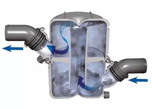

    Now that you mention it I'm not sure what the term water lock means. Anyway in this present design the muffler is supposed to accept the wet exhaust, spray it around inside the muffler chamber (hopefully in such a way to minimise hot spots) then expel water and exhaust gases from the lowest point. From all the water lift designs one sees I 'm thinking the pressure of exhaust is enough to lift the water up, along the hose and over the gooseneck.
    Hmmm - that's a head of water of about two feet - 600 mm. The back pressure generated by a 600 mm lift is about 0.9 psi or 6 kPa (15 psi x 2 feet/33 feet = 0.9 psi)
    Checked Yanmar specs - the max exhaust back pressure is 30 kPa - five times more than the 6 kPa water lift pressure. So if the 3 inch hoses don't cause too much back pressure this water lift system should be OK. It would be good to somehow have baffles that could be adjusted to optimise noise reduction.
    Now I just have to decide high temp resin or stainless - stainless seems safer

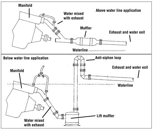

    Straight up from the muffler, over the loop and out the side would eliminate the belly in the line to the transom. (Per your drawing).
    I found a couple of simple drawings, I prefer the second illustration where the dry exhaust riser takes the hot gasses above the waterline, and only injects water where gravity will positively pull it away from the motor, and it cannot flood the motor unless the boat sinks!
    Ideally, the dry loop would be higher than the hull exit.
    A muffler drain is good to have, for emergencies and for winterizing. It could be plumbed directly to a small diaphragm pump, but would need a valve too, perhaps remote operated?

    @kapnD_ Nice illustration. Yes I remember there is a vent tube. That is to prevent vacuum lock. To prevent the engine (when it cools down) from suctioning the residual water into the engine block. It is very important.
    Attached typical cross section of waterlock.

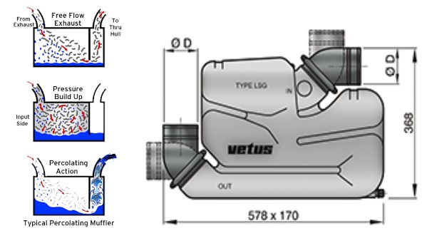

    Maybe Michael is just confused over the difference between a wet muffler and waterlock. Here is the configuration.

    OK I get the meaning of waterlock from your second sketch - thanks rxcomposite - water lock and water lift seem to be the same concept
    I am trying to make a custom water low profile water lock exhaust system
    Stepping back a bit let's define the water lift problem
    1. Yanmar want the water in the muffler to be 250 mm below the exhaust elbow
    2. The water left in the exhaust hose must not get back into engine
    3. Therefore some sort of bucket/muffler/water lock must be below the hose and accept all the left over water when the engine is cut
    4. The conventional Vetus muffler (thanks rxcomposite) is too tall - it will not satisfy the 250 mm rule - the engine is too low in the hull
    5. Yanmar also require the gooseneck at the aft end and it must be 350 mm above water line - so seas don't wash in
    While I could ignore Yanmar's rules it would be wiser to accept that they might know a thing or two

    You can also google images of Vetus and Volvo Penta waterlock design. Vetus and Volvo have low profile ones to base your fabrication on. volvo penta waterlock design
    The elbow is not a hard and fast rule. It is to keep the waves from entering the system, thus it is the height from the waterline to the top of the elbow that matters. A flapper valve can help mitigate this.
