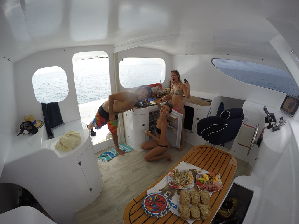

    i wouldnt go that way... id use the full thickness of XPS and then use thin ply of say 4mm either side of the core. So for semantics - 67mm XPS and 8mm ply gives you 75mm total core thickness.
    If you try to sandwich foam between foam you use up alot of resin in the glue line as the surface of the foam is very porous and so it gets heavy/expensive quickly... the resin glue line will be stronger than the foam itself - so no i dont think it will shear along the glue line. H80 PVC foam soaks up approx 300 grams / square meter of resin in the surface porosity of the foam...

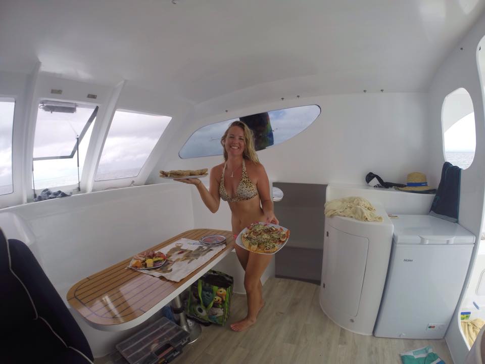

    said table shown below :)

    How did you edge finish the table? Is that ply glued to the foam on the edge? Sure would be tricky on the radius-maybe shrink wrap?
    Are the seams painted in?
    May I copy for my table?
    Did you do the same in the galley countertops?
    And thank you for explaining plywood. I am assuming you would glue the panels to the foam by hand and avoid the crushing problems of vac, or use vac with some means to support the panel edges? I bagged 2" foam unde 9" hg and it mashed quite a bit. I may not have had enough bag there either.
    Thanks for all the time posting. Is that your wife; she is lovely.

    i decored the foam edge with a router then back filled with epoxy/qcells mix, then painted it. im sure there could be other more effieint ways of sealing the edge tho...
    The teak plank timber "look" was created by masking off the plywood and painting the black lines with black paint before clear coating the whole thing. cloak and dagger stuff :)
    Yes the galley counter tops were done in the same way. Sure you can copy what ever you like on the internet :) For the galley counter tops i wrapped them in plastic masking tape and set them in position - then i back filled the edge to create a bull nose from solid epoxy and qcells mix. The counter top was removed, then the bullnose finished and faired into teh cabinets below - then painted - then the countertop glued back in position. THis way the plywood edge was not visible...
    I simply glued it by hand using some weights to press it together - no vacuum - after all were only bonding the cores here- no real benefit in tons of pressure... I make up an epoxy glue mix using silica and qcell and apply it with a notched adhesive trowel so there is lots of even thickness lines of glue all over - then press together. Takes all of 5 mins to do. If you try it im sure you will be impressed with the stiffness of the finished product. I think i used 25mm XPS foam between 4mm ply on this table btw.
