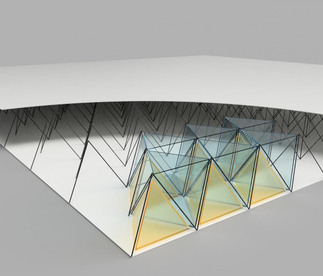

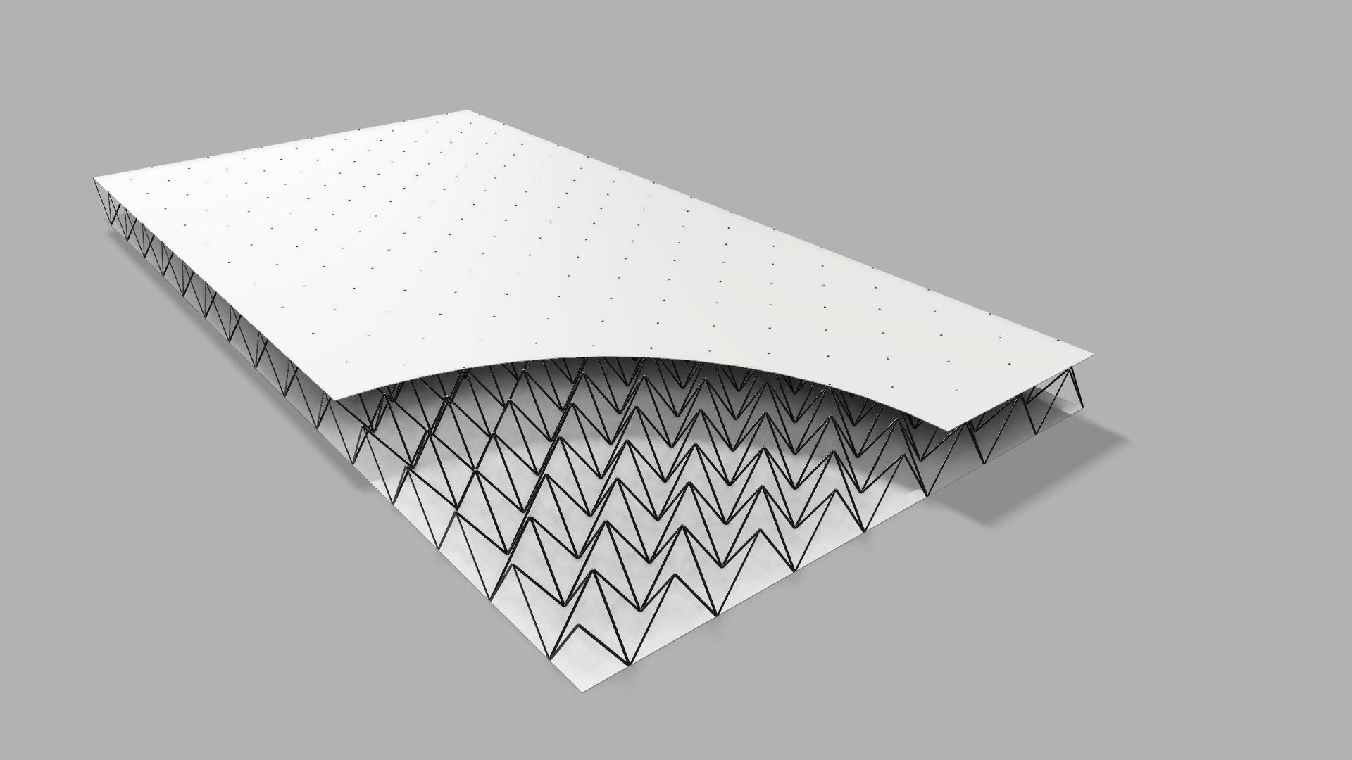

So apparently if those struts are 1mm in diameter it would only add about 100 g/m² for a 60mm XPS foam. But that would be with separated strands not a sewing pattern that connects them on the laminate side.
I've made another test with this type girder structure that would be sewn and creates triangles on the surface too. It's at 870g/m² with 1mm thick connections. So it should be better not to sew but just to punch holes and plug them with cut strands of fiber.
I mean theoretically a girder is the shape with the highest stiffness and strength for a specific weight right? At least compared to the same mass of material in a beam shape. And trusses and girders are not exactly new technology either compared to corrugations.
I'm wondering if it would be better if it was better for them to be thicker or to have more of them in a denser pattern. My guess is that there is some clever math that says that equilateral triangles are best because then only tension and compression is applied to the struts.
It would also work as flow channels to the foam so it could be kinda perfect for vacuum infusion. No flow medium needed. Except that you need to build specialized tool head to deposit these strands into the foam haha.

I do not think there is an expanding foam that is as light as XPS.
I think there is a problem translating the stresses to the corners of the girders to adjacent girders. Those interior corners have 12 sticks coming into the corner, right?
No 10. But I hate looking at trusses too haha. I think that is what I'm really talking about, a truss latticework.
But it doesn't really make much sense to have connections between the struts on the laminate, the fiberglass already takes tons of loads in that plane so it's just wasted weight. So if you remove those connections you only have 4. And you'd have surplus fibers there from the fringes of the roving so it should be reinforced, although somewhat unevenly.
Ok so carbon roving costs about 50€ / kg. Going with that estimate of 100g/m² in laminate about 60% of that would be carbon fiber. So add some added length for the fringes and you'd have maybe 100g again in carbon fiber so that would be about 5€ / m² plus some epoxy.
Of course all that assumes that 1mm sticks of carbon laminate would actually be enough to take the forces to turn XPS into a higher performance material. For example could you have a 3 meter long ceiling span just supported with the laminate and the carbon truss in XPS.
I have no clue how strong carbon is in compression. Would it buckle or just sort of smush the fibers together?

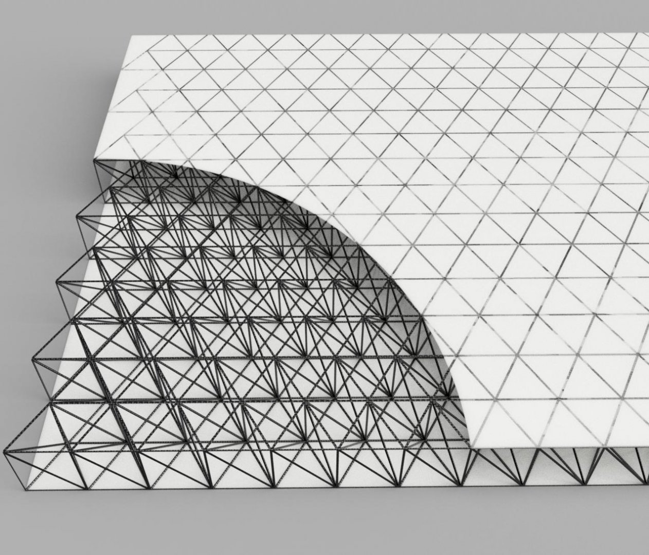

I modeled a proper "octet truss" and the connecting struts with 1mm only have 55g / m² in carbon - compared to 100 for the pyramidal for the same 60mm XPS sheet (plus fringes). So you could "afford" to use carbon.
I probably should do the math but I like to see things visually:

Your last image reminds me of where I was at in my thinking on a stitched tow panel.
here is a modern lockstitch
And, my guess on how to stitch your panel
To stitch S1 the needle tilts backwards and toward the viewer and shoots through the foam to the shuttle, positioned at the bottom of S1 and said shuttle catches the thread. When the needle withdraws that stitch is done. The shuttle moves forward to under S2 while the needle pivots to the forward angle to shoot S2.
As it gets to the end of the first row we now have to stitch all the 'away from the viewer' stitches in the first row, so it needs to come back up the row shooting those stitches, which I call row1.2.
It might be that siz zag shooting is more optimal, where you shoot all three legs with the needle and zig zag the shuttle, before moving on to the next top point. I don't know.
That seemed kind of complex.
It required the manufacture of a an imaginary machine with no known analog to crib from.
Composite fibers are very weak when stressed around corners like stitches do.
It seemed hard to get a good fiber ratio and save expensive resin with the stitches, as the hole would not put good pressure on the fibers.
Then I thought to just cut the foam in the triangles and lay in cloth. Which lead to trapezoids and other shapes.
The reasons;
This was simple and well known tech.
The fibers are strong in this profile, assuming sufficiently radius corners.
Natural top and bottom compression of the foam allows for good FVF.
One can vary the corrugations to match the needs of the panel.
Thanks I looked at that diagram again. I don't understand enough about impact strength and toughness, but you're probably right, thicker fiberglass would be cheaper and tougher to absorb impacts. But it's nice to know that due to the low material use carbon could be an option, maybe for a large roof span.
And yeah a type of foam filled honeycomb would be an alternative. I could imagine that being automated as well. The corrugation idea could also be automated too of course. But I think both require more material than space trusses. The main ideas we're discussing is that thick XPS foam can be used as a former during vacuum infusion and provides a cheap alternative and insulation value.
Just in case I didn't explain very well how to avoid the stitching:
The way I imagine the deposition of individual strands or towing into the XPS foam is with a hollow needle that could get heated to 100°C to easily punch through XPS. You have a strand of carbon or fiberglass inside the needle and push compressed air through it. So you can punch / melt through the sheet, spool off towing that get pushed out with the compressed air, then retract the needle and pull the strand into place. Stop the compressed air for a moment, then cut the strand.
I don't know of course how well this would work. But it seems much easier to build and tune than stitching. It's possible the strands would fall out, or that they get stuck by melted XPS. But hopefully you don't need a complex sewing machine, just a normal CNC retrofitted with a 2D tool head. It seems relatively straightforward to build and tune. The tool head would have one rotational "yaw" axis (the other angle would always be 60°) and one linear axis to push the needle into the foam. Plus a motorized spool, a valve for compressed air and an actuated cutting tool.
During vacuum infusion these holes would hopefully work as flow channels since they are all interconnected. So you'd need less consumables like flow medium.
They would also compress since the gas in the XPS foam cells would expand under vacuum and the foam is elastic. So I'd be less worried about the struts not getting enough pressure rather than them blocking the flow of resin to the laminate.
