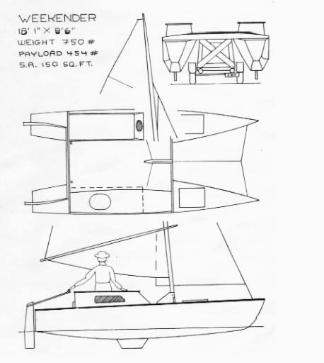

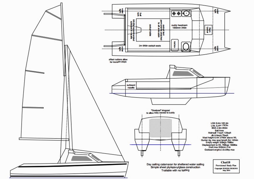

    I have been considering a small, easily-trailerable (so about 8’ beam, no unfolding or extending) catamaran for daysailing four or occasional overnighting for two.
    Right now I am looking at Chat 18 by Richard Woods and Weekender by the late Thomas Firth Jones.
    Any thoughts on the pros and cons of those two boats and/or suggestions of other designs to consider?
    Cheers,
    Matthew
    PS—I would actually prefer a cat rig with just one sail and I am open to other styles like spritsail or standing lug.

    Think payload. The Weekender has only a little more then half the payload of the Chat (about 205kg vs 380). So if you want to day sail 4 adults at say 80kg each, on the Chat you still have some spare for an anchor, cooler, outboard etc and stay within the designed payload. On the Weekender you would be well over the payload allowance of around 205kg. Safety considerations aside the extra weight on the Weekender will likely effect its sailing ability - simply it is not designed for the load you intend to carry.
    The Chat has a sit in cockpit and will be a more comfortable boat to use. A jib is handy on a cat as it facilitates tacking. If its on a furler you can operate it from the cockpit.

    I am partial to Woods and biased as hell. What I like about him is he will critique his own designs; help you tweak a dislike. I'd email him if I were you and ask him to compare his to others here. Richard has been patient as hell with me and I am not sure if he should get the title Sir or Saint.
    A foam build will take a lot longer; just be aware. Ply is much faster.

    That's a coincidence! For the last few weeks I have been trying to decide what our next boat should be. And I have now decided that a Chat 18 would suit us well. Ideal for day sailing, no racing, in Plymouth Sound in the summers.
    It will be a bit of time before I can start as we are still wintering on board a 36ft catamaran in St Augustine Fl and we need to sail it back to its owners before I fly back to the UK end of March. When I startthe build it will be partly to develop the kit boat so I expect it will not be before the end of summer before its finished. (A Dutch homebuilder took 5 months to build his, mine will be built quicker)
    Thanks Fallguy!! Your comment shows it always a good idea to use a designer who is still active and can reply to questions
