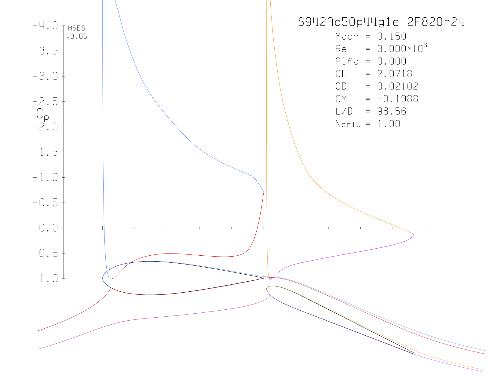

    You're looking at a wingsail (the world's largest) with a jib. The wingsail worked best when it had a substantial flap deflection.
    Qualitatively, what matters most in determining the amount of lift is the angle of the flap to the apparent wind. You can think of the forward half of the wing as being a leading edge device for the flap, even though most of the lift is actually carried by the forward element.

    "The wingsail worked best when it had a substantial flap deflection. "
    That kink down the middle looks so unaerodynamic. Doesn't it create all kinds of drag? Wouldn't it work better as a smooth curve and if so why didn't they do it?

    it works the same way a flap or aerion on an aircraft wing. Yes the gap can incraese drag vs. a surface without a gap, but the idea is to defelect the air flow to generate high lift. when a large aircraft is coming in for a landing it has both leading and trailing edge devices depolyed to generate the most amount of lift (to keep the landing speed as low as possible), but it also generated a lot more drag in that configuration. You will not be at the best L/D with large flap defelctions, but you will be at max total lift. As pointed out above, there are times when you you will be sailing off of best L/D, and there are times, like when sailing down wind, that the drag also contributes to the forward motion of the hull. consider that the maximum lift never occurs at best L/D.
    Best lift to drag ratio (L/D) is beneficial in some sailing conditions or points of sail, and max lift (not best L/D) will be beneficial in others.

    What looks like a kink was actually two symmetrical sections in tandem, with a slot between them. The attached plot shows a typical cross section shape, the predicted pressure distribution, stagnation point streamlines, and the thicknesses of the boundary layers and wakes. The flow is coming from the left, parallel to the main element. The flap is deflected 24 deg from the chord of the main element.
    A smoothly curved single-element section would not work as well. The slotted flap section has a much higher maximum lift, and the profile drag is not much more, if any, than for a single element section designed to similar requirements. The structure and control system needed to get a smoothly curved single element section to change its curvature for the opposite tack would weigh more than the simple hinge used by this two-element design.
