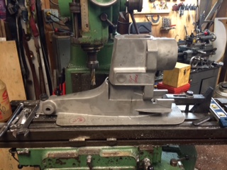

    Okay, so my other project is a 16' Donzi "hot rod" of sorts... I'm playing around with some of the modifications racers use to increase performance. But before getting out my tools and just hacking away, I'm considering alternate methods to achieve the same goals.
    Many performance boats raise the x dimension to reduce drag and gain speed. A common practice with this modification is to also to add a "standoff box" or an extension of some sort to the drive to compliment the higher X. Pretty easy with an outboard... not so much for an I/O.
    I'm not an engineer, NA or even a technician... just a backyard hack :) . My little Donzi will be running an Alpha One I/O drive. Alpha drives once came in a 2.75" shortened version called an Alpha SS to mechanically raise the X. Unfortunately, these SS drives are no longer available. Further, I have never seen a standoff box made for an alpha, although there used to be a device called a "stern jack" but, these devices have issues of their own and are also NLA. (extension boxes are also a HUGE $ investment)
    So, I have shortened a regular Alpha drive casing 3" to emulate an Alpha SS and effectively raise my X. Now, I'm looking to recreate the effects of a standoff box without re-engineering one. My idea to do this is to notch the hull at the transom which in effect extends the relative distance of the prop from the functional transom/bottom edge of the boat.
    Work is already being done to the hull (transom/stringers replace) and I was thinking of adding a PAD on the hull which is a different issue, but modifying the hull is very do-able when the boat is in this state.
    Question(s): Am I crazy? Will this work? What handling characteristics will be affected, if any?
    Thoughts?
    Note** drawings not to scale

    The longer housing (and therefore longer shaft) flex too much under great torque. The shorter version does not. I'm told, it is also possible to retro fit larger bearings etc. Most of these issues are from not coming off throttle while airborne.... Well it happens but, probably not often the way I drive (like the old guy I am) :) .

    If I move the x up 2-3 inches I need to build a "dog house" on my engine lid and it also raises the cg.
    I have decided to change hulls (for other reasons).... I'm looking at a Formula Jr. or, a scratch build from wood to my specs.
    The drive is coming along well. However, I will not be able to really tell until it is installed and wet.
    It's a project... and not a cookie-cutter at that. These things take time :)
