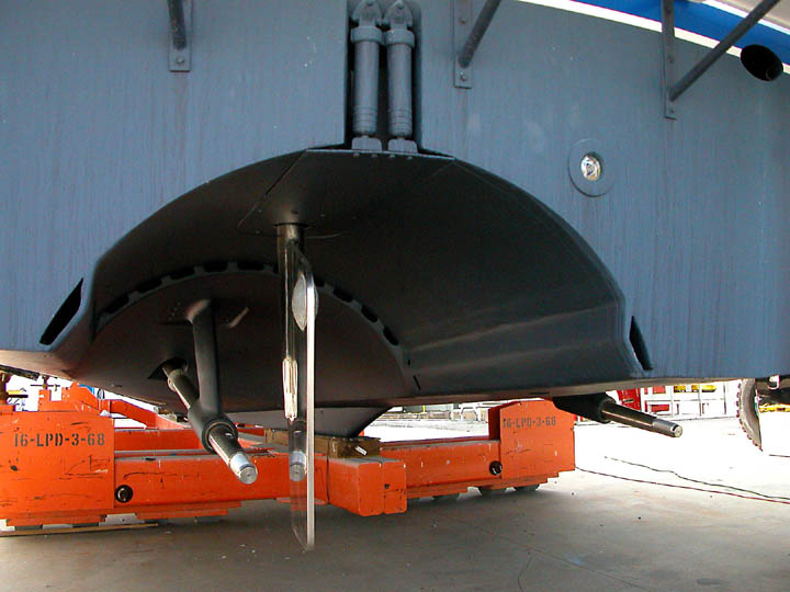

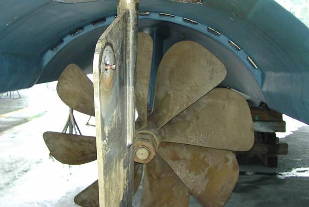

    CDK retired engineer
    With a shrouded prop under the boat shallow water operation is limited to the prop diameter plus shroud and clearance, say at least 18" for a 14" prop. The angle of the boat changes a bit because of the diesel and gearbox, so I estimate the shroud will touch the seabed in a little over 3 ft. of water.
    If that isn't shallow enough you have to put the prop behind the transom and build something over it to keep the air out. With my tunnel drive the prop protrudes approx. 4" under the bottom, but my experiments show that the tunnel length must be between 3 and 4". If you are an experienced metal worker you could make a stainless extension 2" long, flanged to the transom and a small cutout in the bottom, between 1 and 2" long gently sloping downward. On top of the sloped part you can weld flat strips to connect the two beams that must be cut to make room for the tunnel.

    In my experience I have seen only two ventilated tunnel type.
    On Hatteras boats it is used behind the propeller to reduce the propeller pressure pulsation on the hull (see the enclosed picture) the ventilation is on the side down on the water except during the hump when the boat need high thrust.
    Other use was for surface or cupped propeller see the following patent Power Vent Technologies, Inc a normal propeller can have reduction of thrust or vibrations because of suction side intermittent ventilations.
