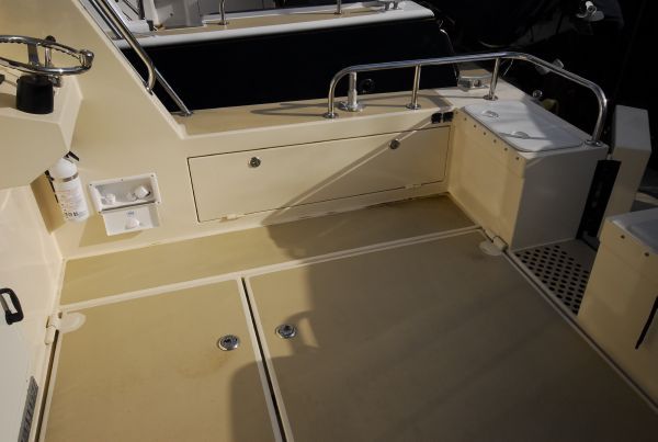

    Attached are two flush deck hatches for an aluminum boat.
    Note that there are large hinges on these doors and are supported by gas cylinders to aid in opening.
    The hinges are out of the way against walls and hard to trip over. I would not recommend a hinge set up for your boat (unless the hinges are also recessed) . Rather 4 of the recessed T-handle latches would be a better set up.
    Under each joint is a channel that is about 2 inches wide by 1 to 1 1/2 inches deep that is scuppered out of the boat.
    A more recent build that we did had 3 inch wide by 2 inch
    deep channels as it was a much more open boat ( more like yours) and there was a possibility of a faster ingress of water so we wanted to shed it as quickly as possible.
    If you have small channels and a lot of water, the channels can overflow the edges into the bilge rather than get it to the scuppers

    Barry - I really appreciate the extra clarification, and pic. I agree that 4 of those locking handles would be best in my case. I have not placed nor cut my scupper holes yet, but I had planned on having them a bit more outboard of where the channel would run around the hatches. Do you think it may merit separate dedicated suppers for these channels and perhaps larger ones more outboard for the draining of the floor i.e water that sheds off main floor and does not fall in the channel?
    If I were going with juts one set of scuppers at the corners of the hatch channel, I think it would work from the sense that a larger diameter hole would allow the channel to drain at the bottom and the main floor to drain up a couple of inches (where the scupper would be the widest). Of course, I would need to weld around the channel so no water could pass below to the bilge...

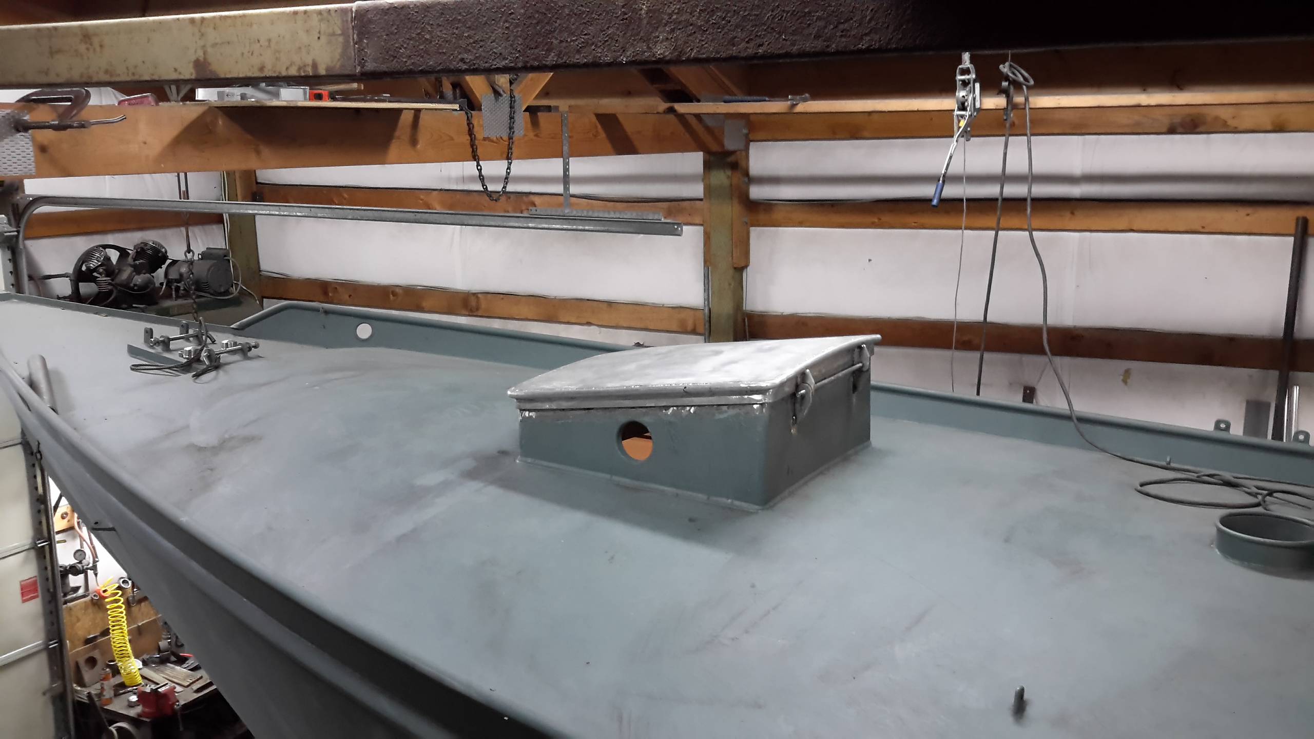

    I just finished a couple hatches you guys might want to look at. Now I have to do a sliding hatch not quite sure what I'm going to do it there any ideas?

    Often starts and stops with welds will leave a high point.
    Pferd makes a Polifan curve which is similar to a flap disc but will radius an INSIDE filet extremely smooth

    I probably would not worry about running extra channels down the side of the boat where the deck meets the side. The boat will never be horizontal either front to back or side to side. The water will move to the transom and out one side or the other.
    So I would place scuppers in line with the channels for the hatches and a couple of scuppers in the corners.
    That being said. If all of the channels are common with each other and the last channel is against the transom, as in the picture, you might as well run the channel to the edge of the side of the deck.
    If all of the channels are common, you can run a single scupper. In the picture you will notice the holes where the transom door is. This is a single scupper for both of these large hatches as the channels were common.
    You will also notice dirt in the stbd corner of the deck. (port as well) This corner did not have a channel to serve this corner and only when the boat was on land, we would get a small accumulation of water in the corner that would not drain. In the water, the corners would pretty much drain due to the movement of the boat.
    Obviously, the scuppers must be as high above the waterline as possible so in a following sea or a fast stop, the water does not rush into the back of the boat. There is a 4 foot wide swim platform on this boat which minimized water coming over the platform and into this single scupper. The more scuppers, the more water that could get past them onto the deck

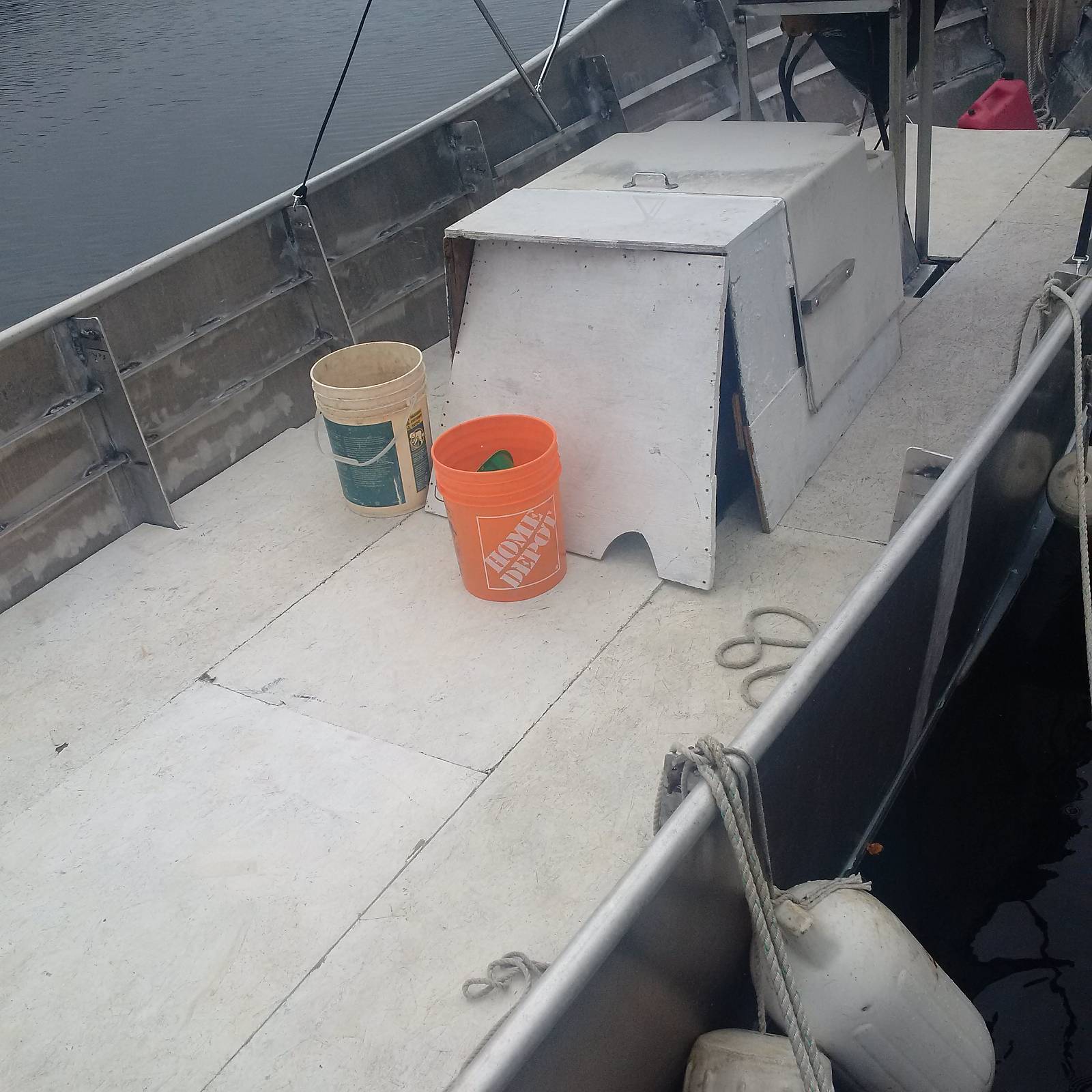

    Barry - I was thinking that I would make up two fairly large access panels (as opposed to one very large one..) so that I could take either or both off for access to the middle of hull, aft of engine box.
    As you can see in this pic, I even cut the aft middle section of the temporary wood floor in two pieces, for this purpose.
    It would be nice to be able to lift either up, without having to lift off / tip the engine box, so I am thinking there would be a small, perhaps bolted on piece where the aft end of the engine box sits, and then two large access panels aft of this, with channel under sides and in between the two panels, all leading back to the scuppers.
    Note - engine box in pic is only temporary... will be looking at forms / styles, methods later to build one out of aluminum, most likely having a few bends done by press brake to improve looks and reduce warping from long welds. Open to input..
    Note - the white engine box in pic is only temporary... will be looking at forms / styles, methods later to build one out of aluminum, most likely having a few bends done by press brake to improve looks and reduce warping from long welds. Open to input..
    I would incorporate a few (recessed) drink holders, but the one in the other pic is one of the few I have seen.

    Boat will be coming out for the season, in a week or so.
    While it was in the water, at rest, I decided to put a level on the temporary floor panels to see if rain water would drain to aft scuppers, at rest, if I were to weld in aluminum sections, where the wood ones sit now.
    Result - floor sections are pretty much level as is, and therefore I don't believe rainwater would run aft to scuppers, once installed.
    My dad is a plumber..and I remember the old rule of 1/4" rise per foot needed for pipes/ drains....but I am hoping that I can get a way with less than that as even for the aft 20 ft of the boat, I think having an incline that rises 5" over the 20ft would be extreme...
    So, what kind of rise do you think is common to achieve self-draining at rest?

    An eighth inch per foot I think would be plenty. I'm trying to eliminate all the wood I can. Water pooling around wood will rot for sure metal not so much if painted or better yet aluminum
