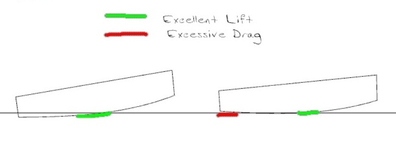

    There are no simple rules of thumb: the subject is too complicated. Most of the the time the things we compare are approximations. And there's a whole world of difference between "Given enough power and low enough weight almost any hull shape will plane" which is really as far as we've got here and "this is the optimum hull shape for this sailboat, which includes the ability to plane on some/all points of sailing".
    Rocker for example. If you make the hypothesis that the dynamic support necessary for planing is most efficient at a certain angle of incidence with the water then a hull with much surface that can be trimmed to that angle will produce more lift and "plane" earlier than one with less. Rocker is a definition of that angle on the centre line, but it doesn't tell you how much area of hull is actually producing that lift. If the buttock lines further out are doing very different things to the rocker line there may be low rocker and not much lift at any angle of trim.
    All else being equal a hull with less rocker may tend to plane more effectively than one with more, but all else is not equal. If a lower rocker hull shape boat has so much drag at low speeds (maybe its low powered and heavy) that it never gets up to a speed where dynamic lift kicks in then it won't plane. A 70 foot inland waterway barge in the UK has a flat bottom and next to no rocker, but they aren't seen planing. Tow it behind the Nimitz and it will probably plane just fine.
    Conversely a lighter thinner higher rocker hull may slip through the water more readily and get up to a speed where dynamic lift will kick in and plane.
    So if you want a rule of thumb it has to relate not only to rocker, but also to buttock lines, prismatic coefficient, section shapes, available power, displacement, all the stuff that goes together, and it ain't a rule of thumb any more...
    But if you restrict your problem to a small subset, maybe the class rules of a given class of racing dinghy where all the boats are fundamentally similar then sure you can generalise that a boat at the low rocker end of the design space will normally plane earlier and faster than one with more rocker, but it will pay a penalty at speeds where the disadvantages of greater wetted surface and form drag dominate the advantages from dynamic lift.

    gggG, just to clarify: if a boat has 10 degrees of rocker (at centreline), then it would need to trim bow-up at 10+ degrees in order to plane? I've re-posted your previous sketch to illustrate this principle.
    Am I understanding this correctly?

    Nope, re-read the post. There is more to it than just trim angle or rocker angle at a specific point. As ggg has said (sorry for paraphrasing ggg) it involves Section(s) , Cp, waterline plan lines, buttock lines etc etc. and then the power input
    You may need a 10 deg angle of attack on some craft but that would be a one off, specific most likely for that craft only. Forgive me but some craft almost no angle of attack on the bow to midship rocker ie a straight line will do and it will still plane - under sail power (no kite either). But there will be rocker behind this point to let it all behave correctly. The hull will still be generating lift to achieve planing mode with reasonable power.....;)
    You will be aware of the curve of areas and the sort of distribution for decent displacement shapes, and even in planing mode one needs the CB, CG etc so that it (the hull) can be trimmed around these axes.

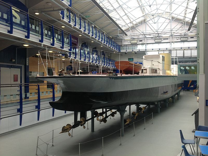

    'Tis true Mr E. Anyway although I've been referring more to sailing craft of relatively small size generally, here's a link to a classic motor craft from the C19th - Turbinia. One reason I have put her here is the large aft rocker (partly for the 9 props on three shafts) which SP seems to believe can inhibit planing....

    SukiSolo, your examples are so random that I suspect you are digging deep to prove your case. I've lifted the pix from the Wikipedia site. Turbinia is definitely trimmed bow-up in the cruising photo. And, there is so much sucking and blowing with those 9 propellers that I'm not sure that the hull shape is to promote planing or to prevent starvation and cavitation at the props.

    Turbinia was built to prove the turbine engine as a power unit, which she did. In fact her props which had to be redesigned, are so good that even modern CFD tools could only improve them by 2 to 3 %. She is also at a very early stage in the development of fast powered vessels, so bear that in mind.
    All my examples do, is to demonstrate (I hope) that there is no single solution to planing for all craft. Primarily it is a power to weight exercise, but right on the margins, especially with sailing craft some shapes work better than others even when length, weight and power are equal. If I sat at the transom of a small dinghy, say less than 4.5 meters, to attain a 10 deg bow up attitude, I'd be last in every race.....
