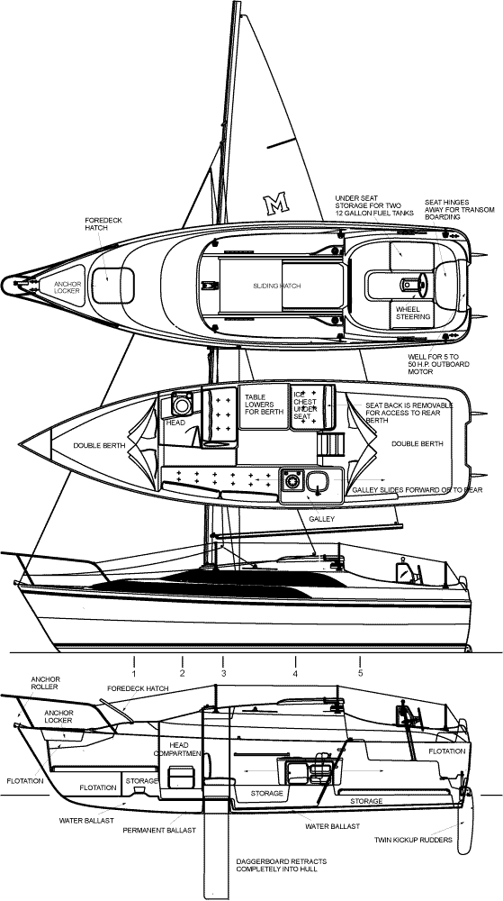

    This hull is capable of planing. What are the features that identify it as a planing hull?
    Has it ever planed under sail power?
