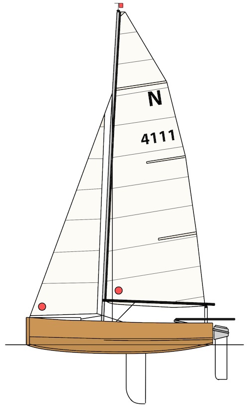

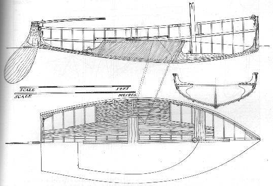

  4. SuperPiper
    Joined: Jan 2003
    Posts: 380
    Likes: 6, Points: 18, Legacy Rep: 58
    Location: North Of Lake Ontario
    SuperPiper Men With Little Boats . .
    Whoa, slow down. I'm having trouble keeping up with you guys.
    I've attached a diagram of Uffa's N-12 with lots of rocker. I was expecting that heeling this boat might have presented a flatter surface to support planing. But the sheer profile in plan view suggests that at any angle of heel up to 90-degrees, the rocker would be the same or MORE. I'm having a hard time imaging this boat planing.
    Can any boat plane? I thought that a displacement hull was more likely to become a submarine if it was driven (towed) too fast.
  5. SukiSolo
    Joined: Dec 2012
    Posts: 1,269
    Likes: 27, Points: 0, Legacy Rep: 271
    Location: Hampshire UK
    SukiSolo Senior Member
    Those Uffa Kings are pretty tippy, I've sailed a couple of them. There's even a new one been built recently see the link, but so was the much later Design 6...
    http://www.national12.org/cgi-bin/Blah/Blah.cgi?m-3541/
    They will plane, just there is quite hump ie forced mode before it will pop up on the plane. Pretty rolly on the run as they are so narrow on the beam, but not too bad in displacement mode.
    You will find the later Proctor Mk8 was a lot quicker to plane, then the March Hare, China Doll, Bouncer, Baggy Trousers, Feeling Foolish, Dead Cat Bounce etc which kind of brings us up todate.
    Don't forget that dynamic weight ie crew have a big influence on trim. Note that things like 2.4 Meter keelboats (as an example) tend to nosedive because the crew has to stay in a more or less fixed position. Note also if you get very fine in the bow it exacerbates the nose diving, you may find a picture of N 12 Subversion, which soon got called Submersion.....

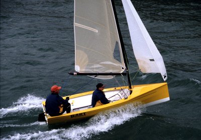

  6. SuperPiper
    Joined: Jan 2003
    Posts: 380
    If this boat was planing level, supported by the hull at maximum beam, then the transom would be elevated above the water. Only the rudder's bottom tip would be immersed.
    I'm going to conclude that the boat assumed a significant bow-UP pitch in order to plane. It was planing on the rocker (see photo).
    I could believe that.

  9. SukiSolo
    Joined: Dec 2012
    Posts: 1,269
    Super Piper - The 12 you show would have some trouble planing on the rudder only BUT it may be possible as the 12s' now have T Foil rudders and IF you could get both crew aft of the transom it is technically possible!!! but I doubt anyone has done it yet.
    On these relatively short two man boats they are very sensitive to fore aft trim. Your picture is also in a wave situation, probably a sea venue. Different in flat smooth water, but you would still be aft a little. Very design dependent, I've sailed some that were great and others which were a lot more tricky. Yet to fully go down the mine in one though....;)
    Planing is leaving the wave train created by the boats own length behind. Somewhere around 1.34 X square root of the Waterline length of the craft. I personally don't believe you need to change the hull angle at all to get in a planing mode, the hull will lift dead level in some circumstances. However in many cases it is better to use the hull shape by trimming to help the lift, especially in waves where the momentum of 'dropping down' a wave can promote an early break out into planing mode. Often on a really quick plane the boat will in fact run pretty level, just a bit elevated, regardless of the hull rocker IF the boat is correctly designed to plane. Very very wide sterns, simply for example promote nosediving because the crew cannot get far enough aft to prevent the bow being depressed on a puff.

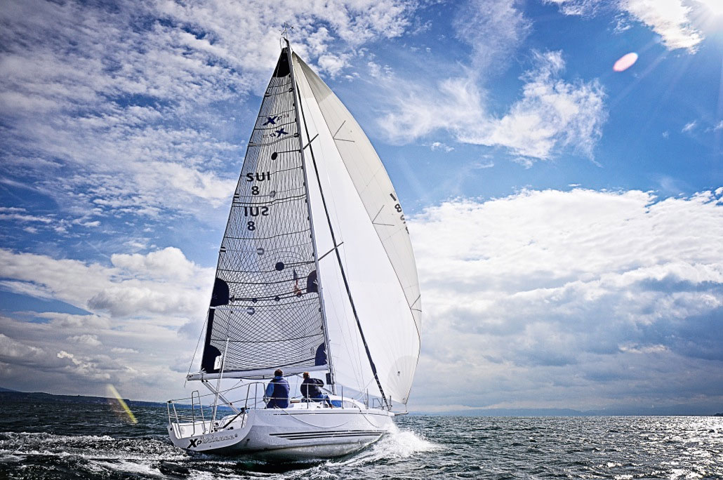

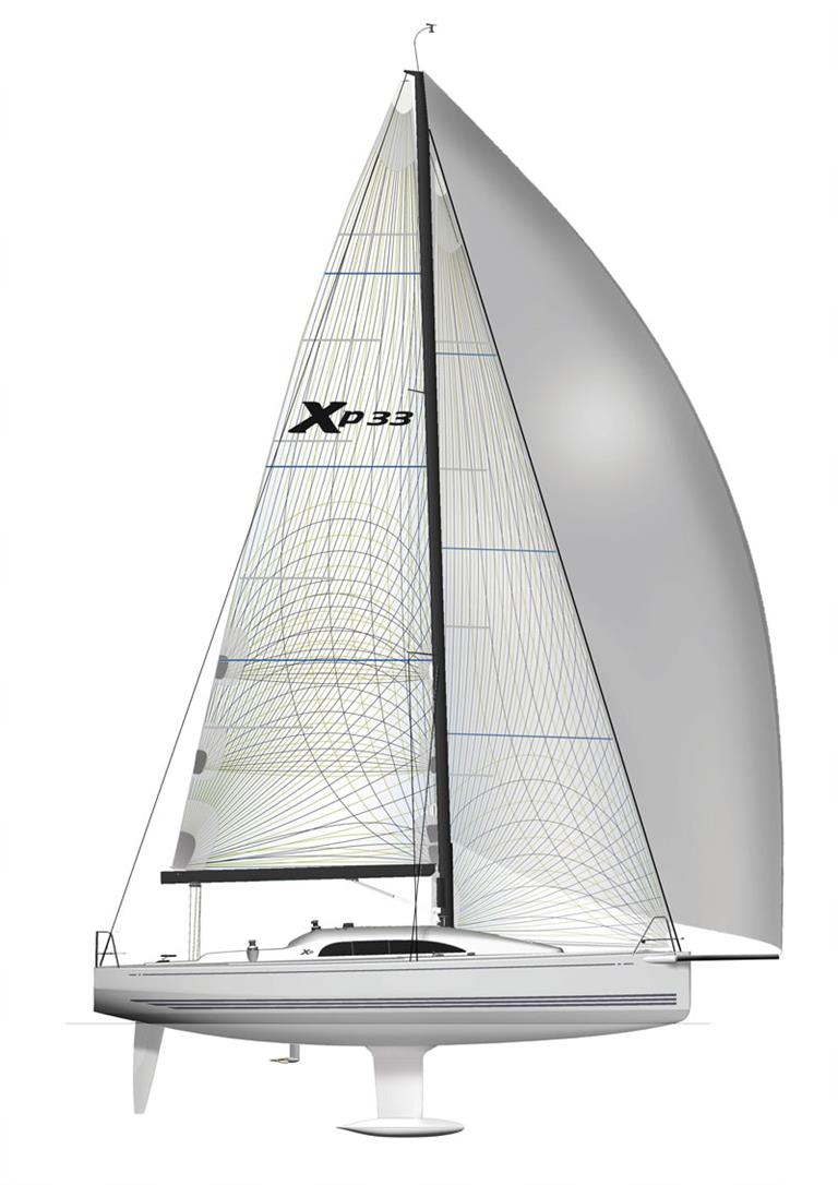

  12. SuperPiper
    Joined: Jan 2003
    Posts: 380
    Great video, SukiSolo.
    Here is the link to the XP33 website:
    http://www.x-yachts.com/range/xp/xp-33/
    And some pix from the website are attached below.
    This totally upsets everything I thought I knew about planing. The transom shot shows the water releasing from the rockered hull forward of the transom. I absolutely did not realize this was possible.
    Can someone help explain this please?
  13. SukiSolo
    Joined: Dec 2012
    Posts: 1,269
    Don't fret about that photo, most likely she's not quite planing or the wave pattern (presumably Swiss Lake) is just doing what it does. Water won't always go to the end of the boat if it wants to find it's own level before reaching that point. If you have ever capsized in about 1 second to windward on a run in a small boat, you'll know there was NO water supporting the hull at that point....;)
    even if you were planing....I've had to straighten the odd bend in the mast from a couple of these incidents.

    The Xp 33 hull just looks typical of many production hulls. What characteristics allow this boat to plane?
  15. SukiSolo
    Joined: Dec 2012
    Posts: 1,269
    Aaahh now that is what you have to learn...
    Not all reasonably current boats are the same shape, lots of things define how they behave as well as the SOR ie cruising, racing, ocean crossing etc. But small dinghies allow lots of cheap experimentation to try ideas. The maths is fairly straight forward on these small boats so you need a 'feel' for what has worked before and where things are going as well as fluid flow. That is what the pros have - many years of experience and knowledge a lot locked up in their heads. I'd suggest sailing as many boats as possible, especially of the length similar to ones you are interested in.
