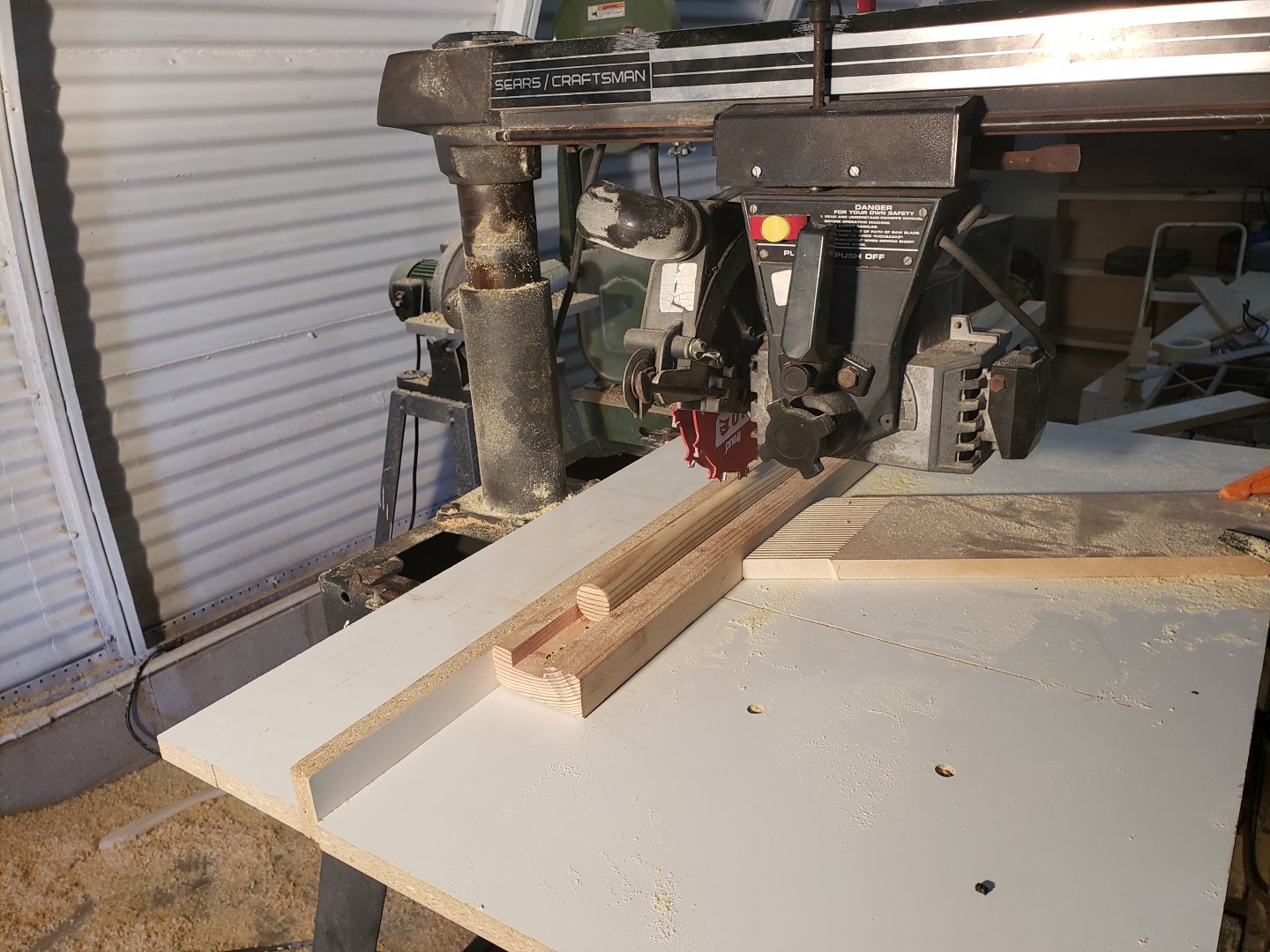

    This isn't specifically about boat building per se; it's more of a general woodworking tip. But it might be a handy trick for people finishing out wood cabin interiors to know...
    A friend of mine named Mark built a shelf unit out of nominal 1x12 pine, and wanted to cap the sides with wood closet pole stock (1 5/16" diameter Douglas fir). But he had no idea how to cut the necessary channels. So he handed the problem off to me, with a promise of some good craft beer in return.
    I was stumped for a bit. Part of the problem is that like most closet pole stock, the pieces he supplied were a little warped. I got around that by using a piece of 2x4 to support them the entire length.

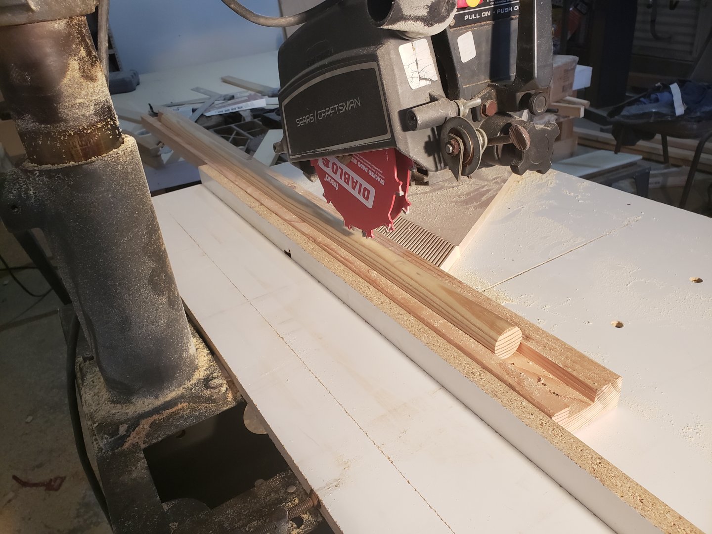

    First, I trued the 2x4 with a jointer and thickness planer. Then I used a dado stack in a radial arm saw to cut a groove in it to wedge the pole stock tightly into. I handled the warp by turning each pole until the ends were rising, clamping them down, and toenailing them in place with small screws set below the depth of cut.
    I set the dado blades to the exact width needed (I have a good set that includes shims), clamped a feather board in place to hold the 2x4 bed firmly against the fence and keep it from kicking back, and cut the channel in each piece. It should go without saying that I made several passes, instead of trying to dig that much wood out in one fell swoop. I used a push stick to keep my hands out of the action, and set a roller stand to support the work past the saw table.
    Things worked out very nicely. Mark got to finish his project; I had fun coming up with a workable solution to his problem; and we shared some very nice Russian imperial stout. I didn't take pictures during the actual job, but I'm including one with a piece of scrap dowel set into the 2x4 bed.

    Another picture of the setup from the other side...

    Good stuff Troy. I'd have done pretty much the same but on the table saw instead of the radial arm saw. I suspect
    that the table saw would have been safer but what the hell, you did get the job done.

    I didn't use a table saw because I'd have had to box the dowel in deep enough for the 2x4 bed to ride on the table. I would also have had to use at least a little downward pressure to keep everything from rising up as it passed over the dado blades, which is a potential invitation to trouble; I don't have a hold-down on my table saw. Whereas with the radial arm saw everything was held between the fence on one side, the feather board on the other side, the table below and the dado blades above, and it was going nowhere but straight through. Also, having the dowel and dado stack in plain sight made centering the cut a lot simpler.
    I think people have gotten a little over-fixated on how 'dangerous' radial arm saws are for anything but cross-cutting. I've been around them my entire life, and definitely respect them. But if you tune a good one properly so there's no slop or play anywhere in it, use feather boards to prevent kickback, and use push sticks instead of stuffing your hand into the blade, they're reasonably safe - and very useful for this sort of work. Like most power tools the basic safety rule that applies to them is, "don't get stupid..."
    The saw in the pictures is a 10" Craftsman that I put together this summer out of two vintage basket cases, and it's rock solid. I also have a 9" DeWalt, circa 1955, that I've owned and loved for almost forty years. I've been given younger, 'modern' radial arm saws twice in the past, and threw each of them away as soon as I could politely get away with it; they were garbage.

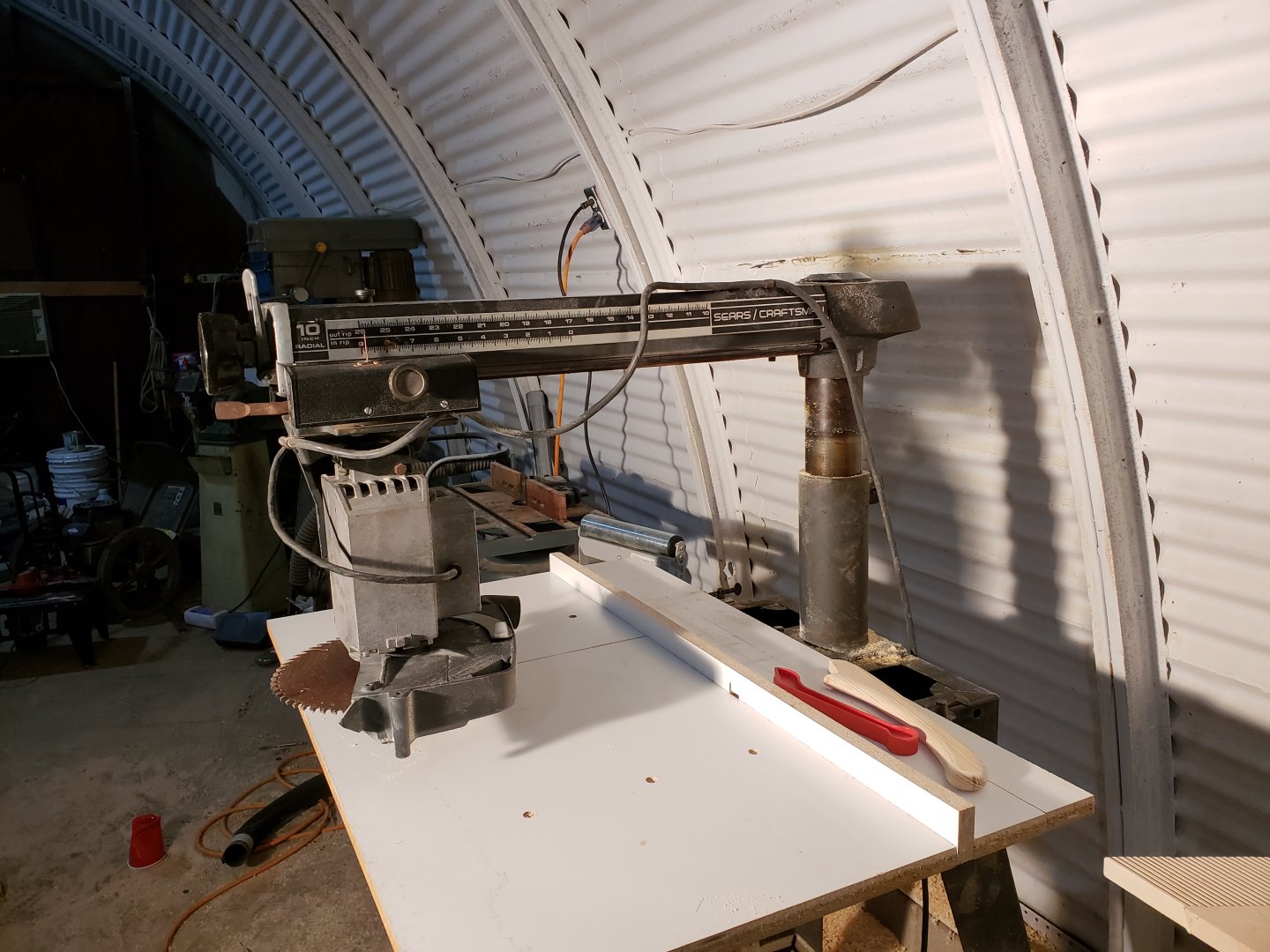

    I was still moving the part. The powerhead was locked in place on the arm, and I was sliding the dowel on its bed. But having it captured between the dado stack and the table was similar to running a board through a thickness planer instead of a jointer.
    I'll admit that initially setting up and truing a radial arm saw is a royal pain, if you expect any precision from it. The Craftsman manual I downloaded for my vintage model has a 6-step process for doing so on a new saw, with each step being useless unless the procedure before it is done correctly. And unless there's enough cast iron and steel in one to make it rigid, you're wasting your time anyway.
    By the way, I have an old book around here somewhere that portrays radial arm saws as the Swiss army knife of power tools. There are scary things in it; the author got carried away. For example: in one picture the powerhead is at the end of the arm, with the exposed blade turned flat a few inches above the table. The guy's cutting a full sheet of plywood by leaning it up against the saw on end, and sliding it along the floor. I kid you not.
    I set my Craftsman up like that long enough to take a pic, in case you're having trouble visualizing it. But I drew the line at digging out a sheet of plywood and turning the saw on. I may be nuts, but that doesn't necessarily mean I'm stupid.... :p
