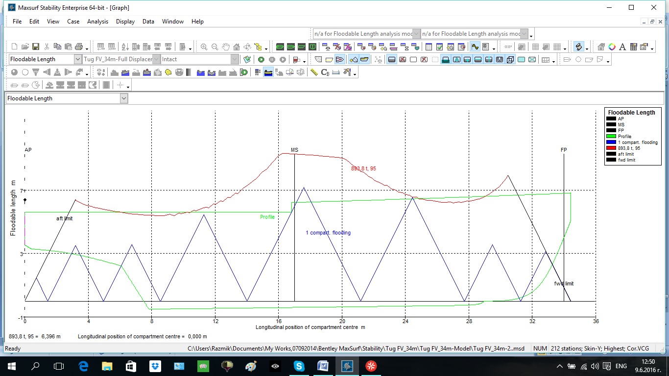

    It is possible to test with the function „Floodable Length” of the program Maxsurf Stability:
    1. In the List „What to do” we must select „Floodable Length” – see Fig 1.

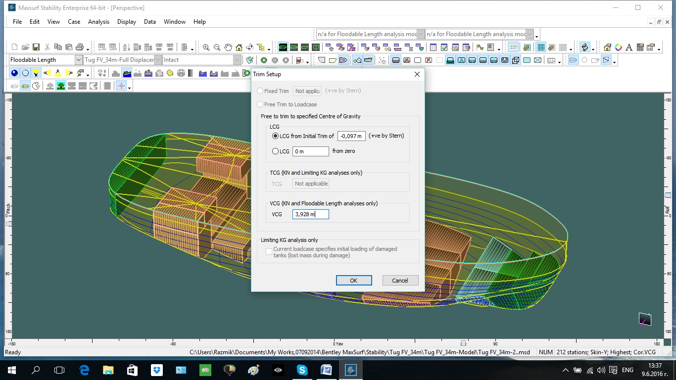

    2. In Trim Setup for Load case Full Displacement we select Initial Trim = - 0,097m and VCG = 3,928m – see Fig 2, how it is received in Specified Condition.

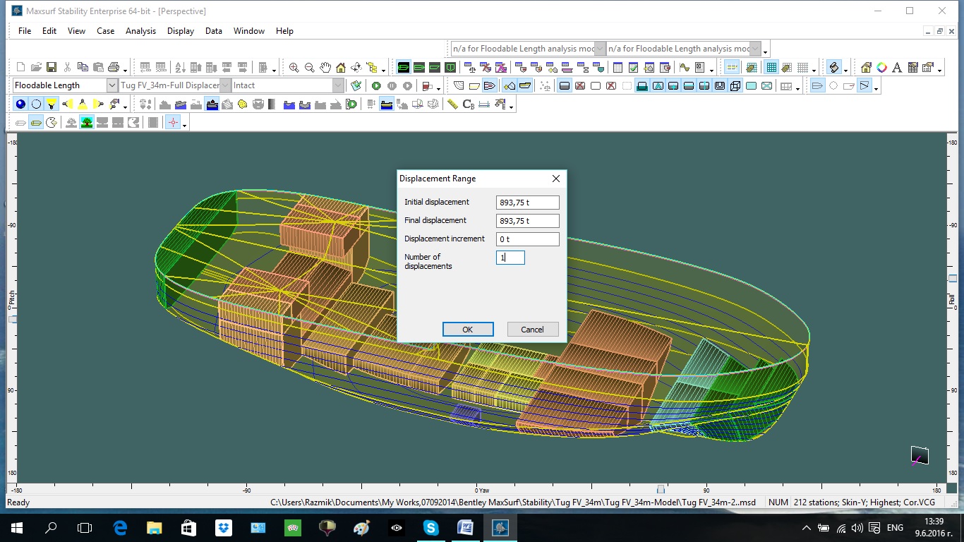

    3. We calculate Floodable Length only for Full Displacement – see Fig 3.

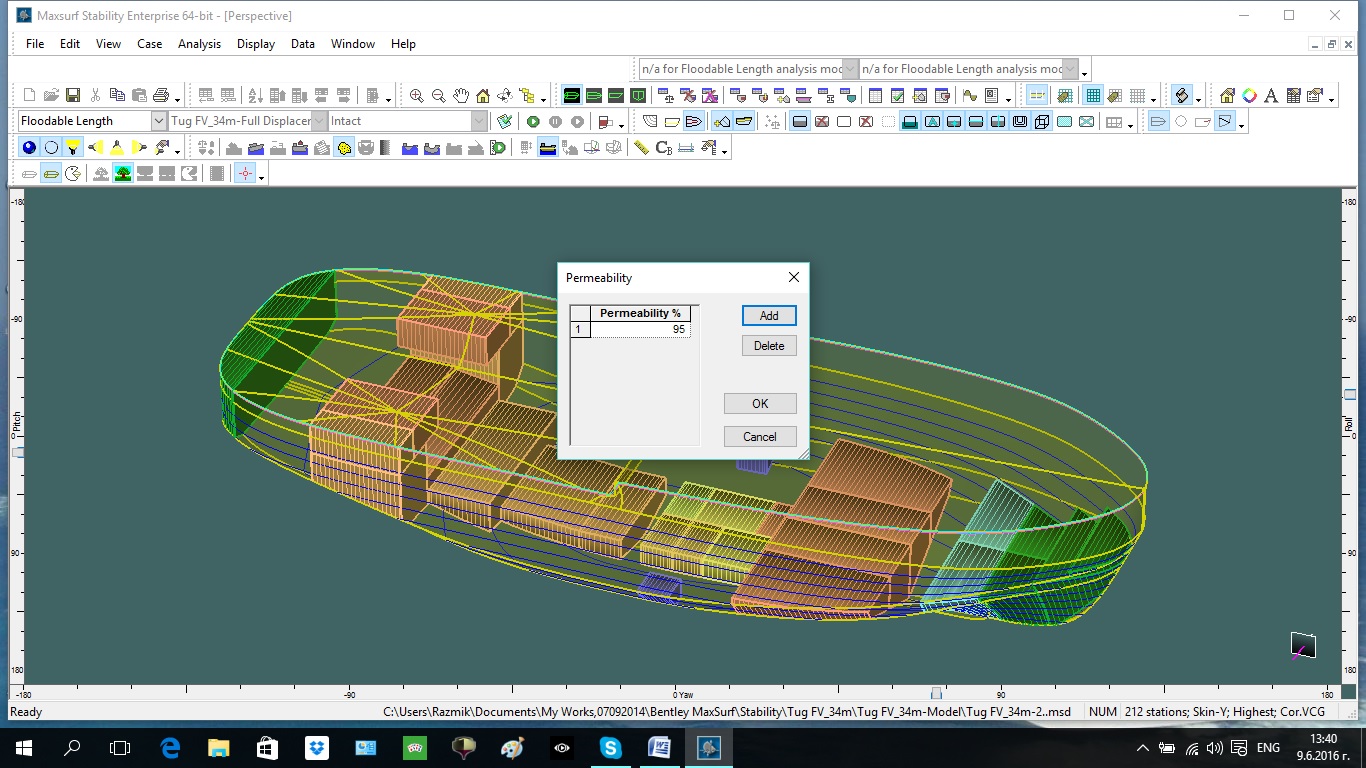

    4. We select Permeability factor = 95% for all compartments in the ship – see Fig 4.

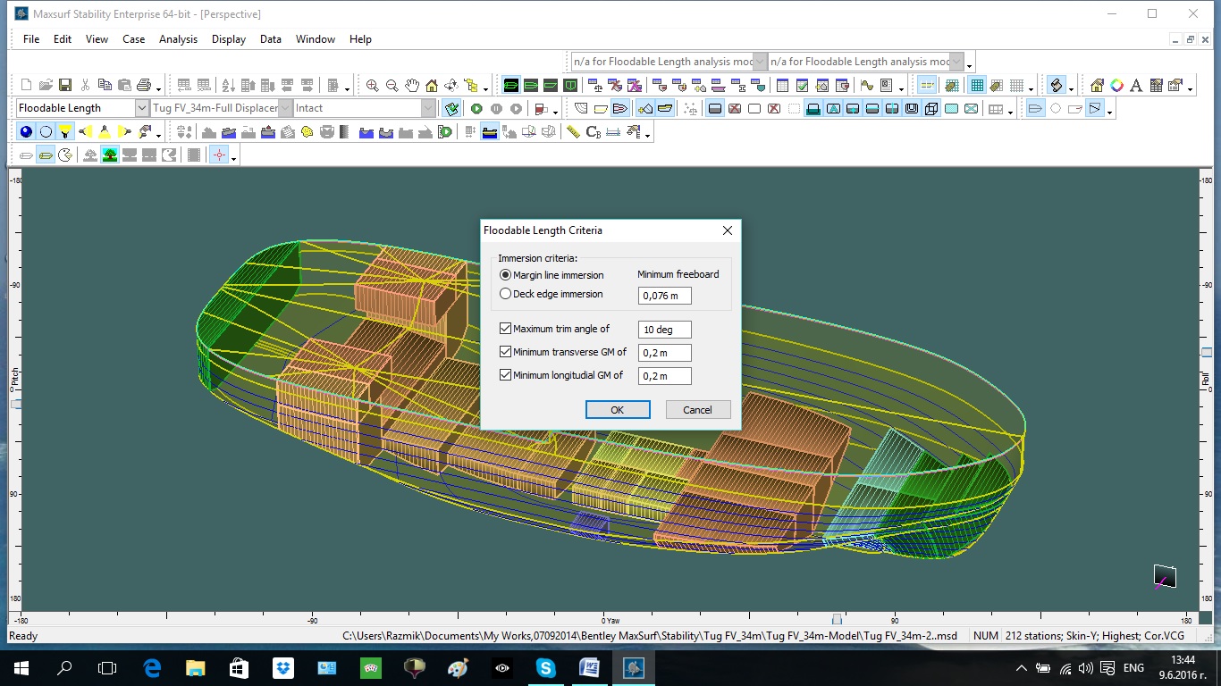

    5. We select wave profile – see Fig 5.
    6. Must select Floodable Length Criteria – see Fig 6.

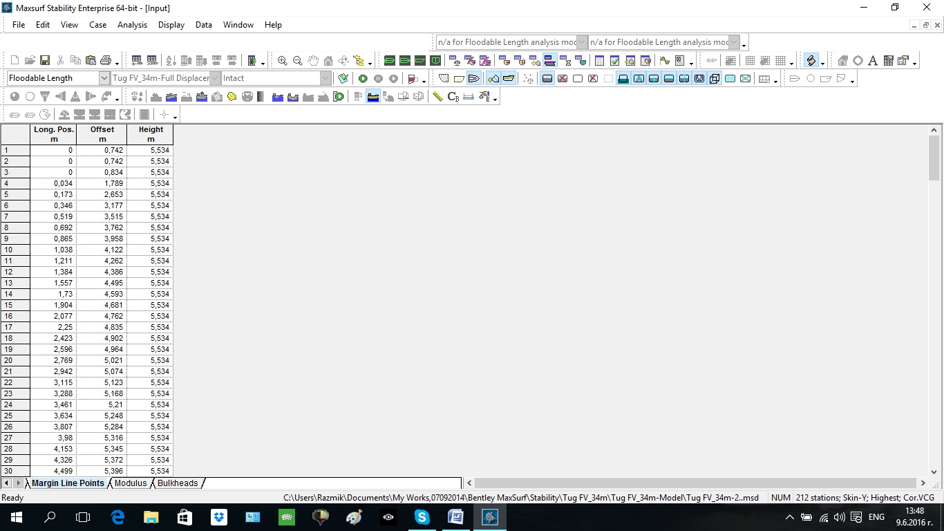

    7. Margin Line Points are visible automatically in the program – see Fig 7.

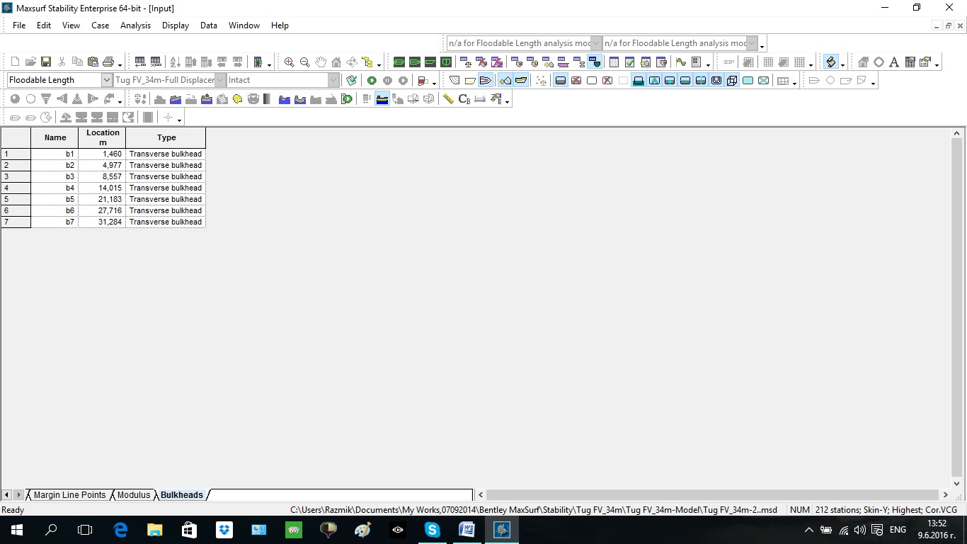

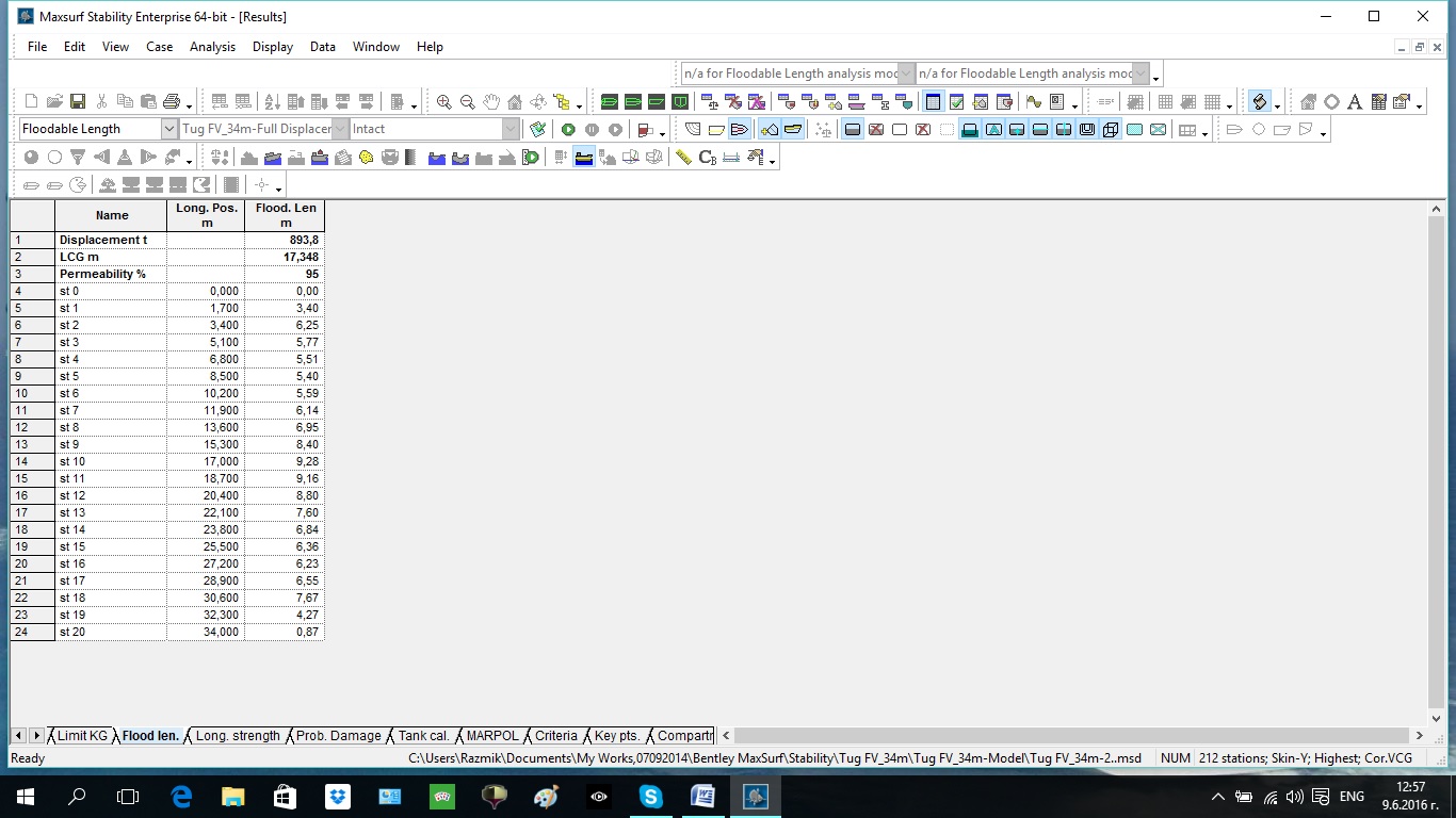

    8. In the table for transverse bulkheads we point Name and Location – see fig 8.
    9. After Start Analysis the Results for Floodable Length we can see in the Table – see Fig 9.
    10. The Curve of Floodable Length we can see on Fig 10.

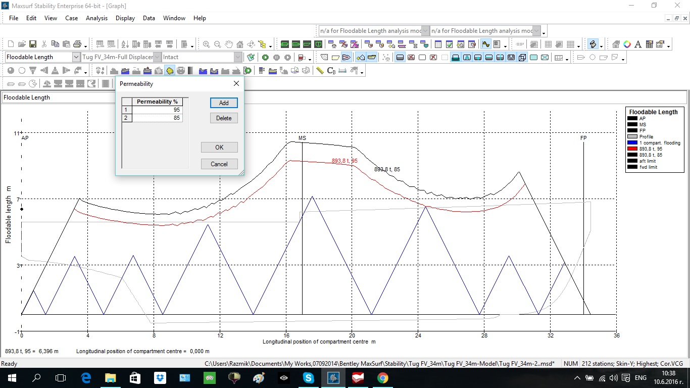

    Never the ER of the ship at accident it is impossible to fill with water 95 % from theoretical volume of the compartment. For that the Rules of the Classification organizations indicate 85 % Permeability for ER.
    How to apply it in the calculation Floodable Length with program Maxsurf Stability?
    For this purpose in the Table for the Permeability must to add one more - 85 %.
    The Results we can see in the jpeg file.
    Endways from the program it is possible to make Export dxf file.
    After correction in dwg file we shall receive the final output - on length ER Floodable Length it is shown for Permeability 85 %, for all remaining compartments- 95 % - see dxf file.

    Maxsurf allows the user to enter whatever permeability he/she likes and plots the floodable length curve for any of those permeabilities on the same graph. It does this with the option of ploting the actual compartments on the background for the user to check against. There is no limit from the software's point of view. Dependes on the class/flag requirements you can use for example 85% for engine room and 95% for other compartments or anything else you like. Plots can be for one, two, etc compartment hulls depending on your requirements.
