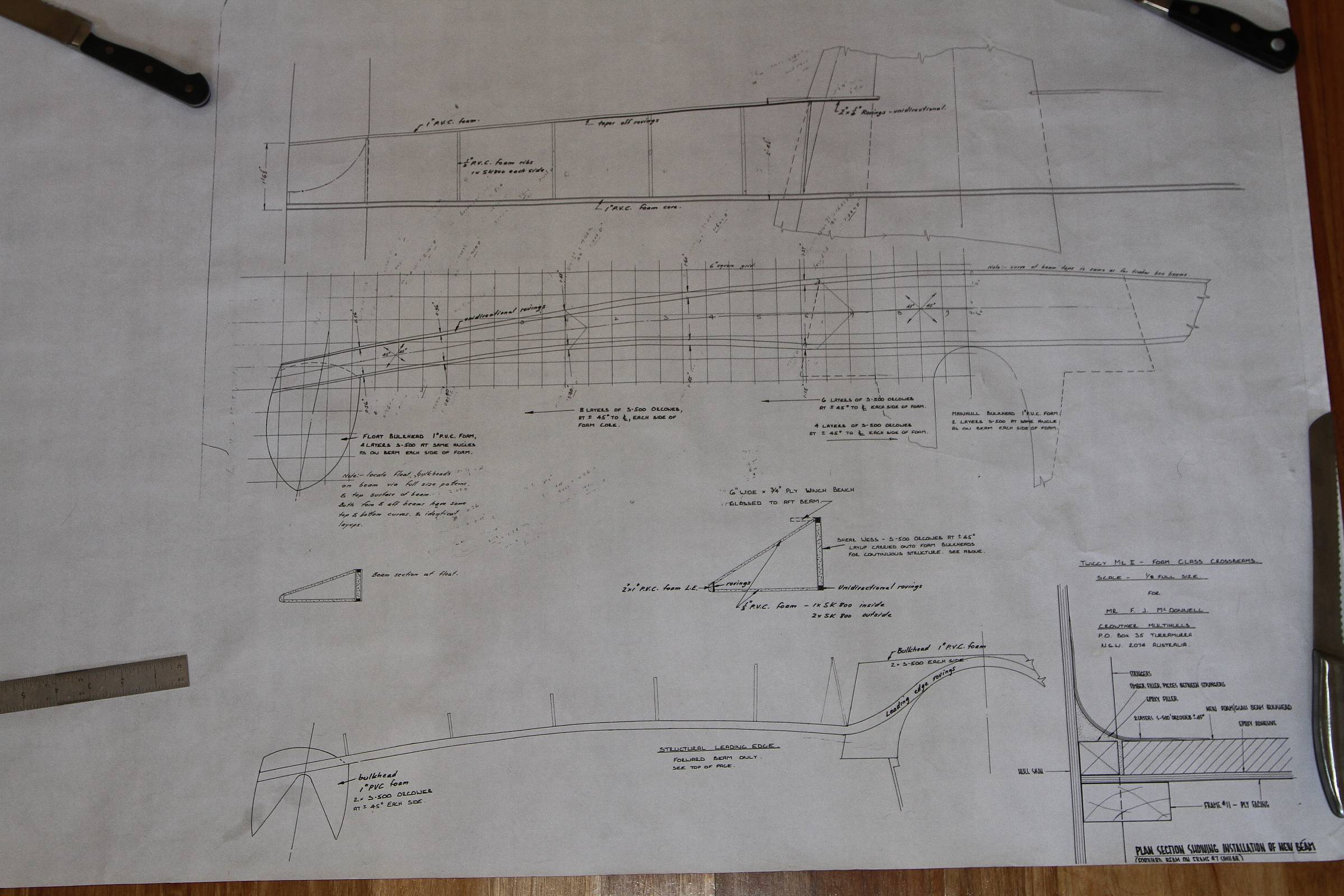

    Sad to hear Mike. Owen, if you are interested I would seriously think about putting the Mk2 beams on. That way you can cut out some of the forward bulkhead so you can get forward easier. Also you get a lot more cockpit room.
    Best of all, they should be HEAPS easier to build than the ply box beams.
    I seem to be having trouble getting the images I took for Mike to attach to this post. Email me if you would like all the shots of the old and new beam plans I have.

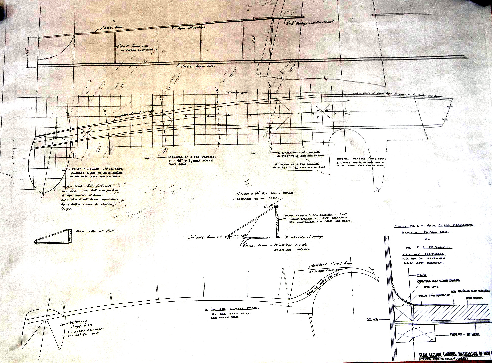

    Cleaned your image up a little, catsketcher Phil.

    Simple beam
    Thanks for posting and also the "cleaning" :) Have the foam twiggy beams proven reliable? It looks like a fairly simple beam to build.
