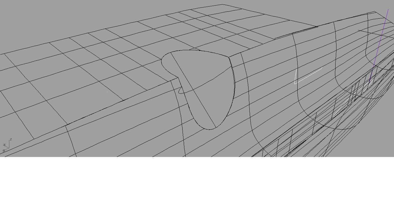

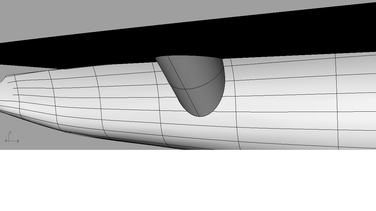

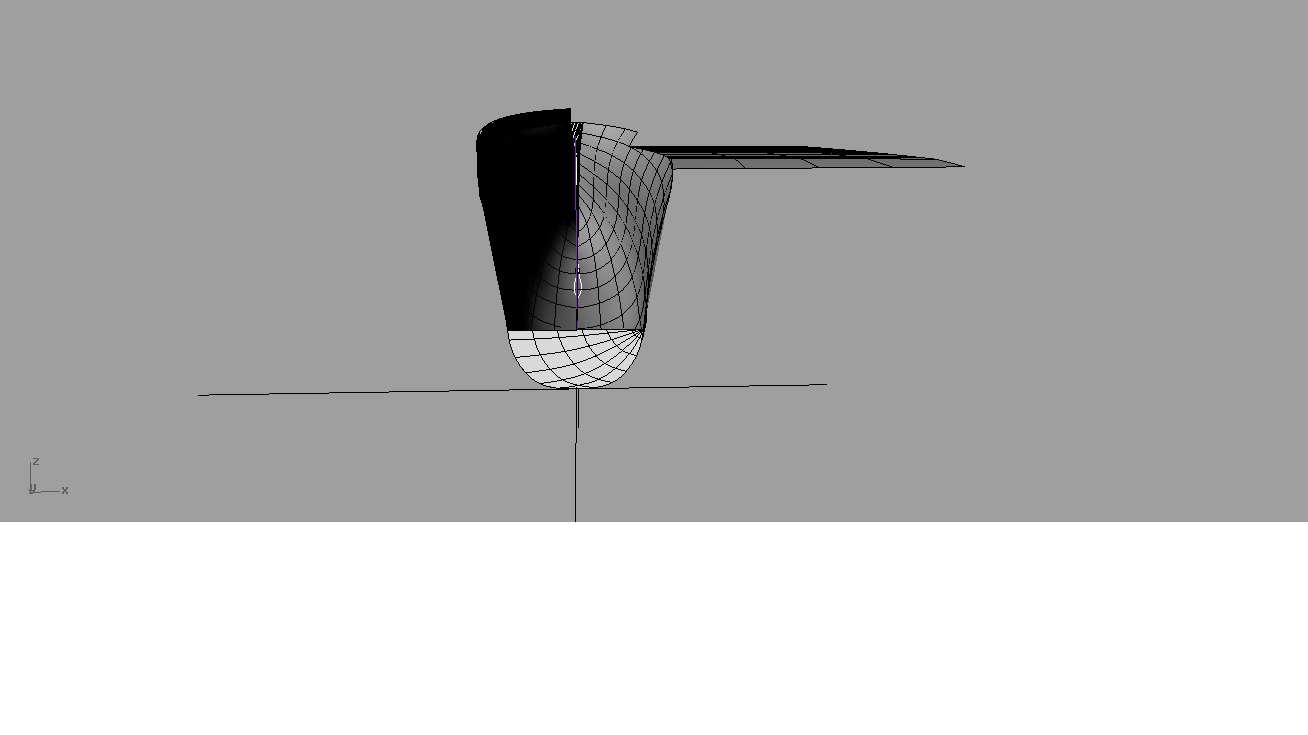

    A quick play around
    Cleveland
    I have drawn what I would do with the steps. My 38ft cat has boxy type ones of these but I would make them this way as it is stronger, easier to make and less drag in the water. I have not drawn the steps inside the blister but I can do that if you can't see where they would go. I would make these from 2 layers of 600gm biax over 12mm foam. Moulded over a tube of about 350mm radius. Start scoping out round rubbish bins, kids toys, anything that might be a good mould for the blisters. They will change the way you get into the hulls.
    I'll check with the owners and get back to you on contacts.
    As for cabins - yours is pretty terrible and has one of the major issues that people who don't think a lot include on cabins - headroom all the way to the front. On a boat like yours you want headroom but not everywhere. You want headroom between the hulls for a while and then you duck anyway so you can reduce headroom at the side of the cabin. At the front of the cabin you are getting ready to sit down again so you can reduce headroom again. Somewhere tall to stand up in at the middle/back of the cabin and less around the edges. So I would attack the cabin so that the new cabinsides are wider and overlap the blister, reduce height forward and make it moulded looking with the headsail sheeting to the cabin and use composite over the top pulley to get the sheet back to the deck.
    cheers
    Phil

    I just remembered that there was a Spindrift that put a blister on deck as well. This is the easiest way to get the extra headroom - a blister underneath and one above it on deck. Make them at home and put them on at the boatyard.

    Cleve; a chamfer panel is an angled panel from the hull to the underside of the bridge deck so imagine a panel on approx 45 under the bridge deck faired out front and back into the hull lines. Look at Schionings Radical Bay, most of them have them.
