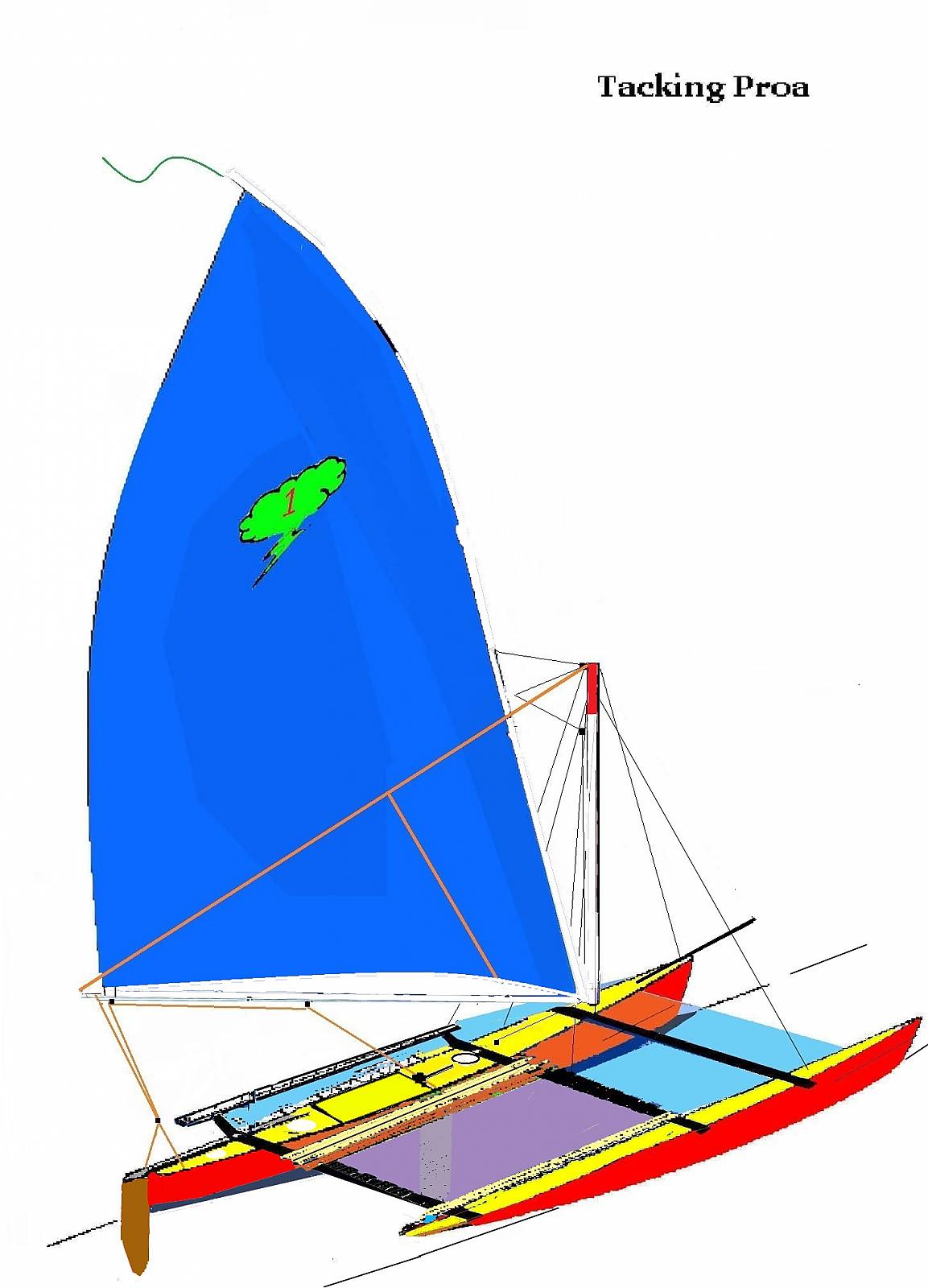

    Well, I might have a plan. I am having a fellow here rip two 2x4x9 long Douglas fir into 1/16-inch strips, if I do not go with shrouds.
    Plan to epoxy two 2x2 sections of the strips with strips of carbon tow between each strip, clamped...and while wet, tape to one side of hull from dagger case to the step to match hull shape.
    And use strip of s-glass along keel-line and will fasten the strips through hull every meter or so and also tab it to a stringer extending from each side of the dagger case. Will run similar shorter version from step to bow also.
    May add vertical s-glass at anchor points also.
    Each of the four strips will be anchored to the step using 3/8 dowels.
    Not much weight added, decent stiffness and length to spread out the stresses.
    The carbon covered sections of the step itself will need to be screwed in place (screws make it easy to replace if needed).
    But, as I have been advised, shrouds are easier and likely safer.
    Any comments etc will be welcome. I figure I have invested too much time in this project etc, to let it go...not to mention the T-6 tubes etc. If I hit upon a winter work place, will jump on it and proceed...but small town and not much available but will ask around. You never know.

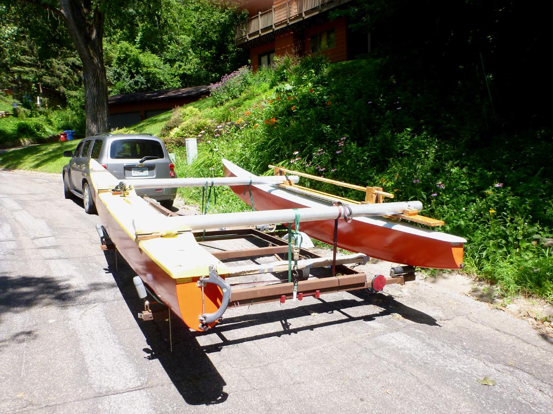

    Major deviations...shrouds and forestay, instead of planned unstayed stubby.
    Added carbon stiffening in main hull
    Full mast step all T6 from base to above deck (have not figured out cover for when on trailer.)
    Also dumped the gas power for electric...all up 400 lbs needs not much push and the elec troller motor no stink, easy to raise etc ...
    Here are prelim pics...not wet for day or so. Waiting on one job and have to add hook and loop luff to sail...will add more pics later. Last pic is plan at this point...so far it is close.
    Rudder assy not on yet, might need to extend tiller and extension, motor mount for stern elec trolling motor still under advisement and tramp is in mail...
    Should be wet in day...have to be certain it floats...and sailing within the week (how many times I thought that and...)! Re orig rig plan, save shrouds and fore stay, fairly close...
    An adventure...

    What I ended up doing is set stays up to support the stubby, which is stepped in circular AL section in hull, on the advice received. The stays take pressure off the foam Hobie hull and works fine so far.
    Will post detailed pics from other computer later.
