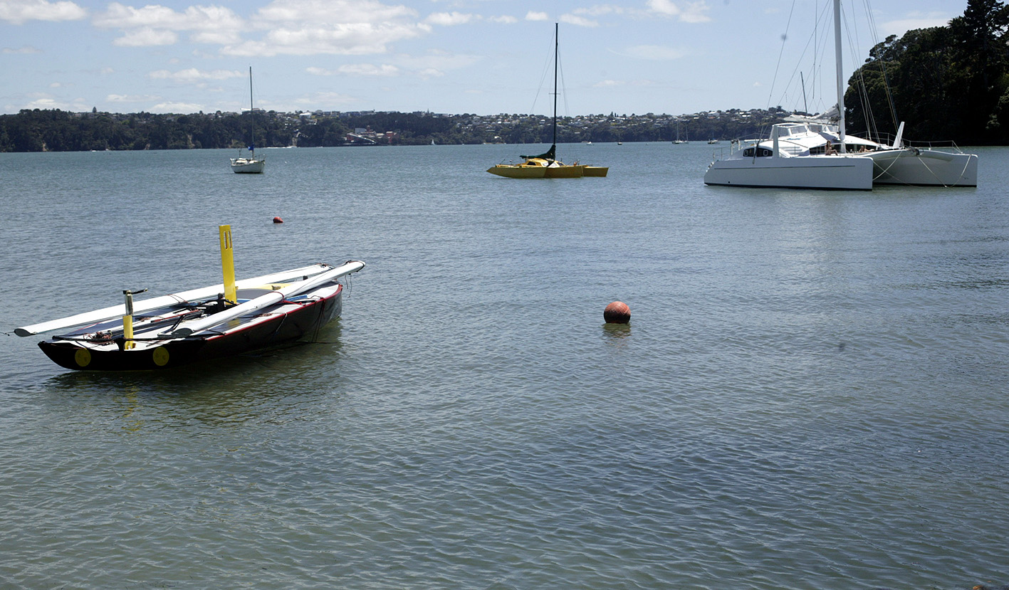

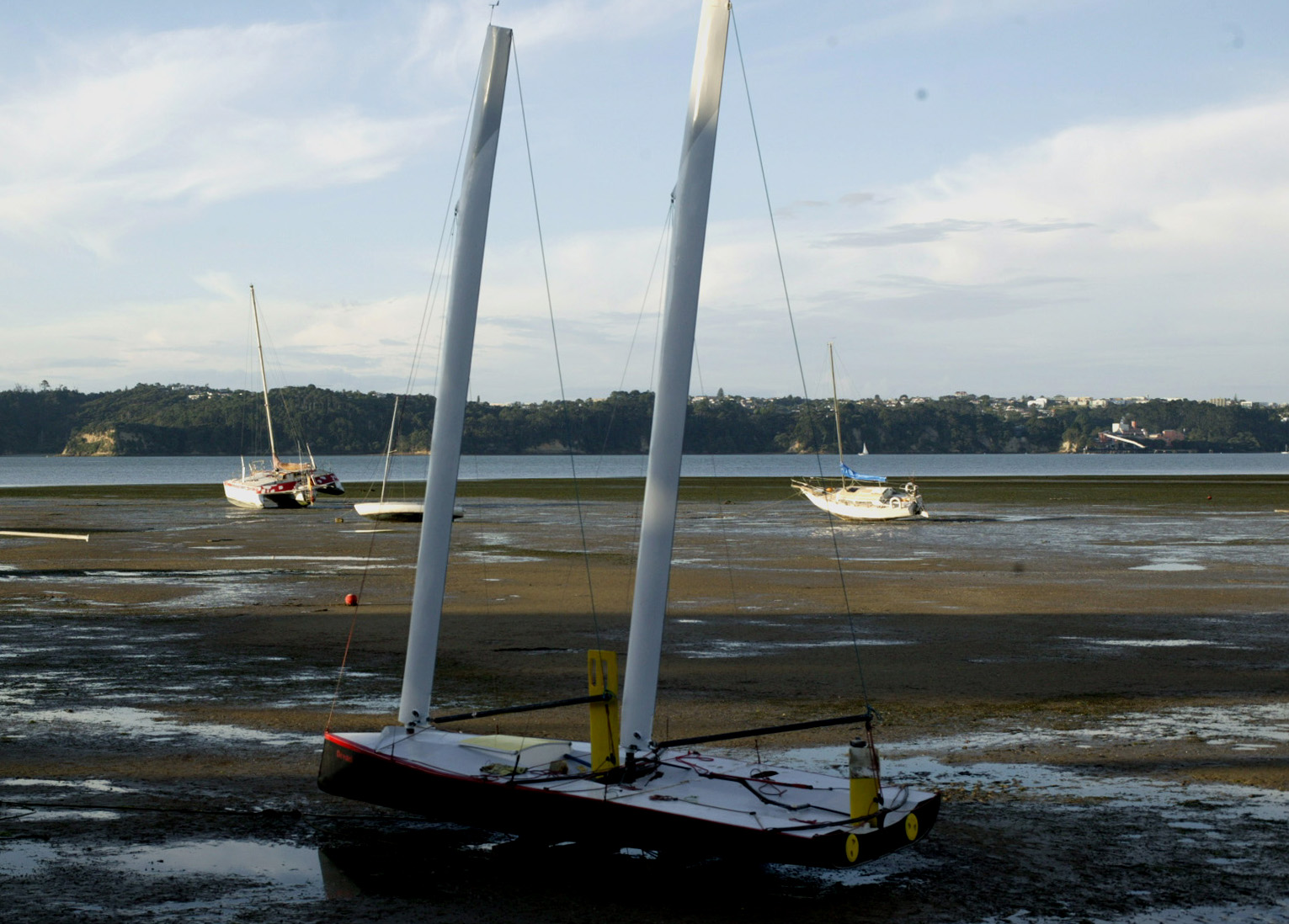

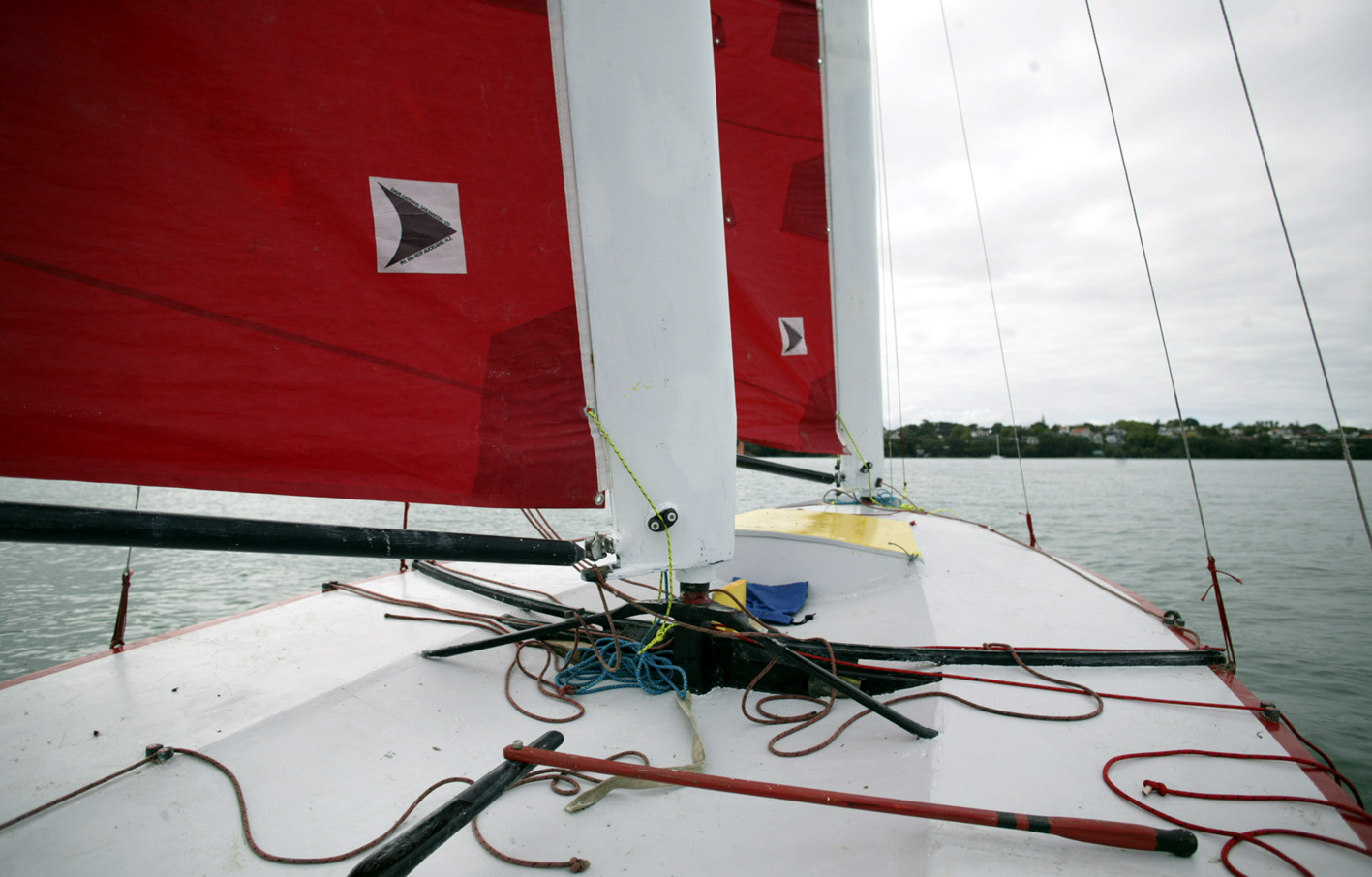

    Cox's Bay Skimmer looking much lighter and moored with some of the Cox's Bay fleet; got the fore mast up later but had trouble with the main mast, four stays a little difficult to handle when solo; will finish job tomorrow - with maybe another set of hands.

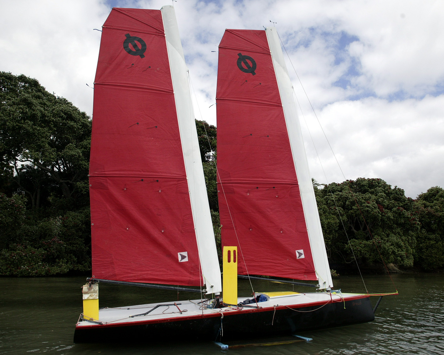

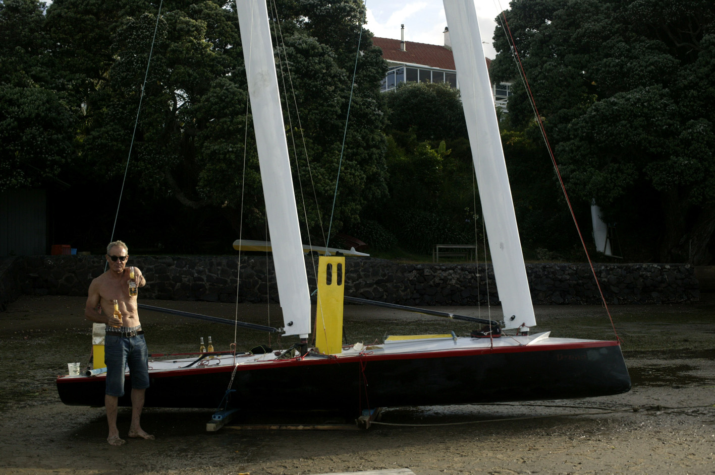

    Got both masts up; Jacques gave me a hand with the main mast with the tricky four stays then we sank four Mexican beers with lemons. Tomorrow will laminate the bow sprit on. Cheers.

    Solo on Skimmer today in light winds, never stopped moving - which is understandable when you look at the rig size. Breeze came up later and the boat, well, it skimmed. The shallow cockpit and close to deck booms makes you contort when tacking/gybing. Will shorten the tiller to give a fraction more room.

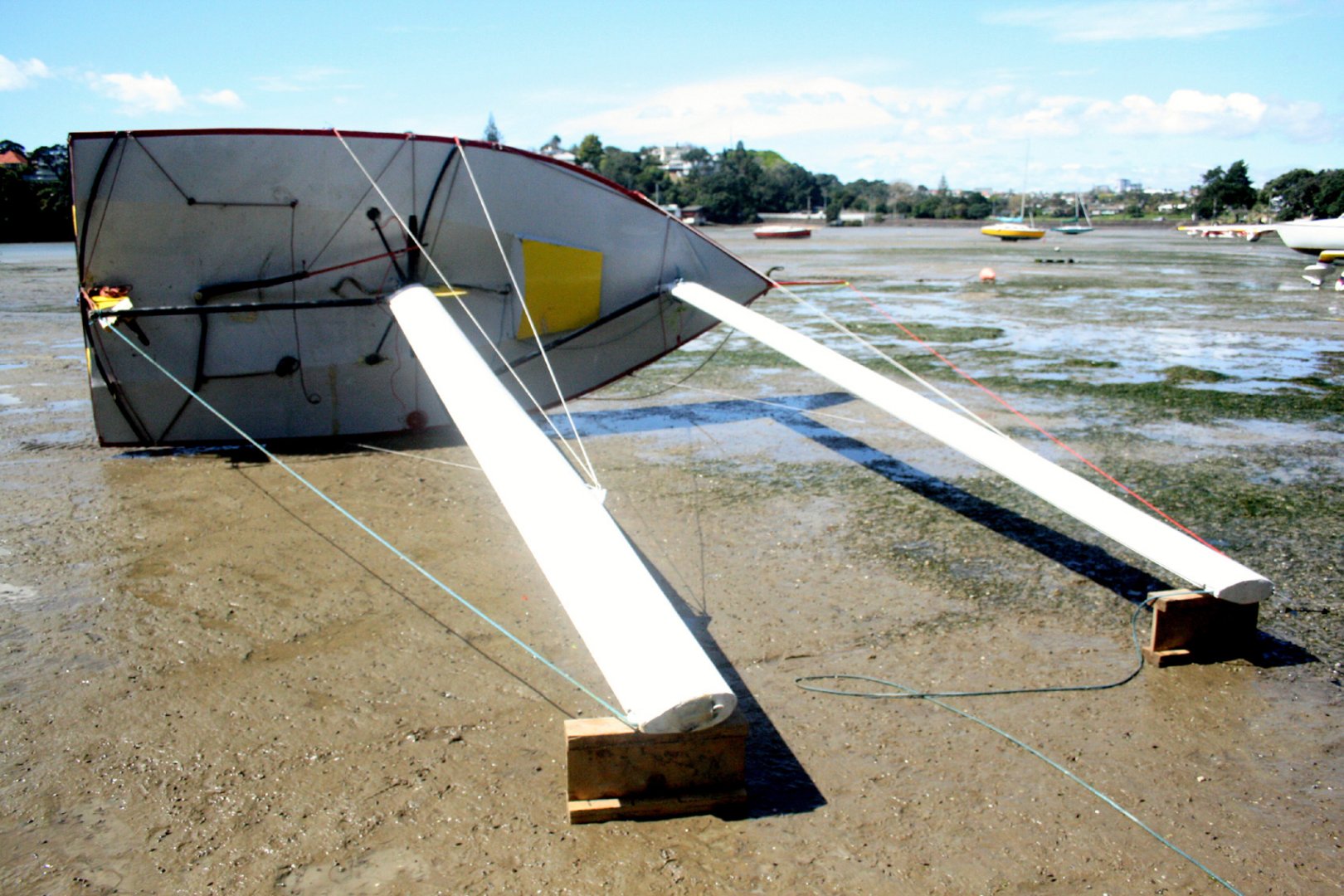

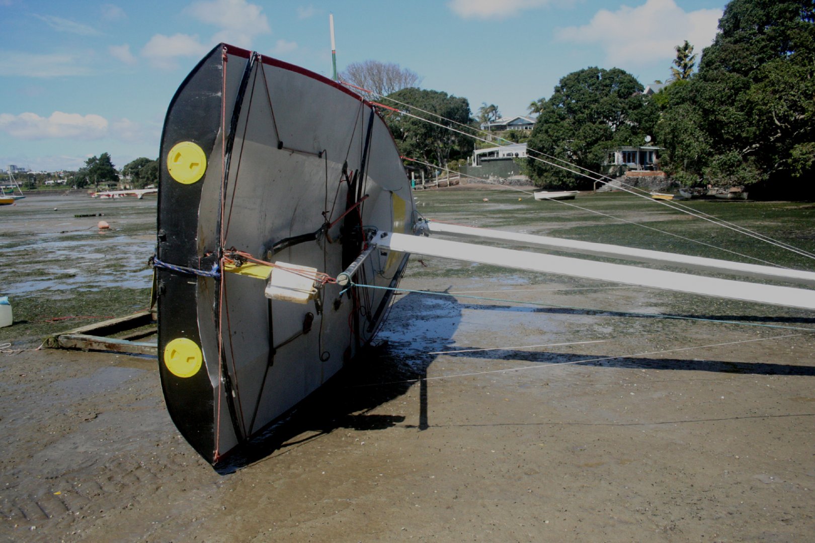

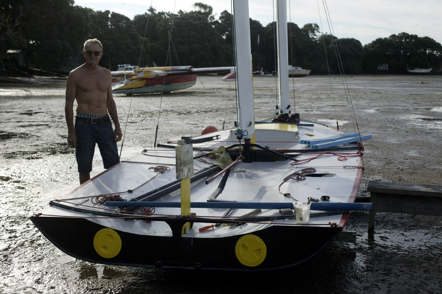

    skimmerside copy.jpg skimmermastscopy.jpg skimmermastscopy.jpg Poor Cox's Bay Skimmer, moored and untouched for months and so has produced a heavy crop of oysters; got a into g and cleaned the poor thing - which is now skimmerside copy.jpg rubbed down and polished but took some time to achieve.

    Skimmer foils; eat your heart out, Douglas; notice immaculately cleaned hydrodynamics - this was not the case 6 hours earlier.

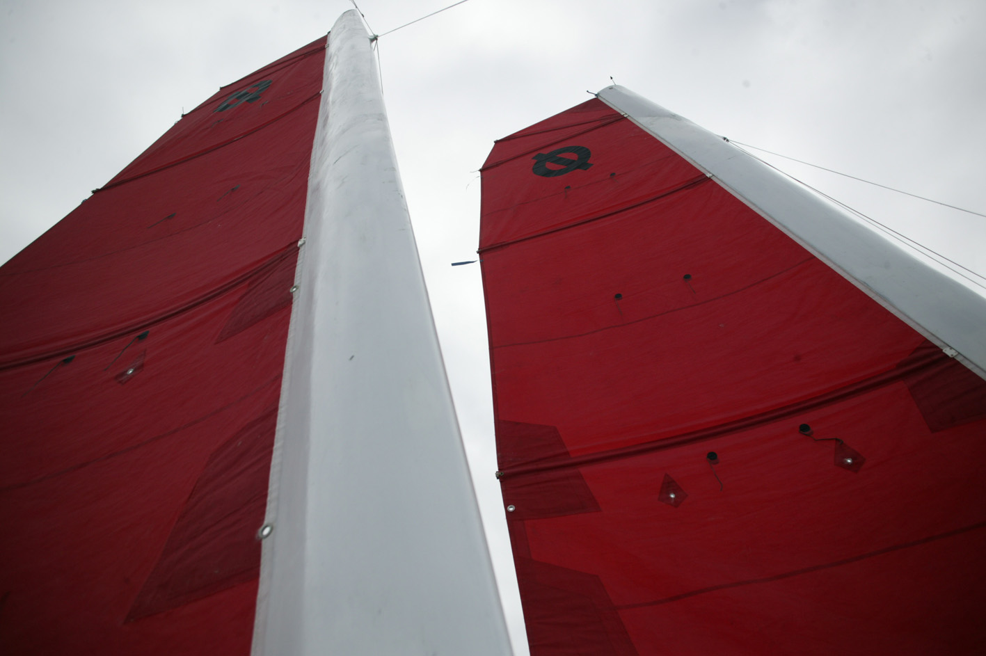

    Skimmer is a mess at moment; recent savage NE blow which caused chaos with Cox's fleet and elsewhere, flipped it and heavy cradle over, smashed masts and main dagger board/foil top and filled hull with sediment. So, but not hurrying, will change wing mast chord (have already repaired the inner alloy tube sections which were spliced above hounds) will reduce mast chord to 200mm, was around 300 originally, just too much windage if caught abeam with boat on tide out hard, this plus the boat being much lighter than original water ballasted setup. Thought the heavy waterlogged cradle would have stopped this - but was wrong.
