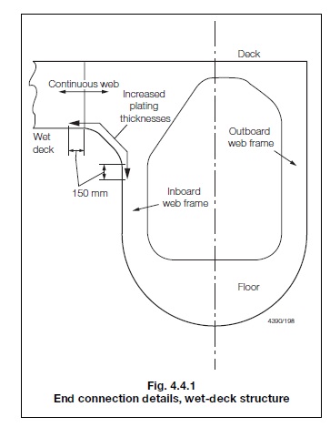

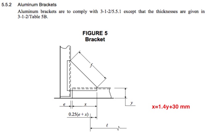

    Again, another question about cross structure of a catamaran. I think now I realize how to calculate the scantlings of the members of the cross-structure(cross beams+plate thicknesses) from guideline of the ABS High Speed Craft Rule. But, I'm still unsure about the two things.
    1. The connection joint of each demihull (ama) to the cross-structure (aka). I'm not sure how to design it. In ABS rules there's equation for calculating the bracket sizes to support structural members. ( in attached photo 2, bracket size 'x' is associated to the 'y' size of the member which is to be supported) In this case, too, can we assume that this joint is the bracket which is to support a cross deck beam and a transverse frame in the demihull.
    2. In the attached photo 1, what are those holes called and how do we add them? I have a rough idea that they might be lightening holes. If so, how can we design them?
    Thank you.

    It is actually very straight forward.
    For example, let us also imagine that the hull has a force applied at the half the draft. What happens to the hull? It bends. So what is required to prevent the bending..stiffness!
    So look at your item 1, if the hull butted directing into the raft section like a square, is this a good connection? Obviously not…why??..because the butting hull into the rfat is a square connection, in other words it is a stress concentration. The applied load, lower down in the hull must be transferred to the raft structure. The way to achieve this without increasing the stress, is to add a smooth transition…a large radius. Just like that shown in no.1
    However you don’t want a large panel of plate between the hull in-board side the main deck (raft), because 1) it adds weight and 2) it is prone to buckling. Solution…split it by adding a lightening hole.
    As for no.2 These are called lightening holes. You can place them wherever you like, just make sure you have sufficient shear area available and that they don’t create any localised stress oncentrations.
    Simple…

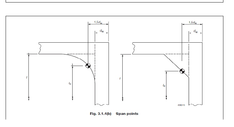

    Not the radius you are looking for but the proportions as shown from LR rules. The computations are shown in the rules.
    The curved inboard side shell connecting to the crossbeam is called "haunch" and is usually curved (and reinforced) following the curve of the shear stress.

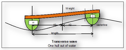

    When the twin hull is hit by a transverse wave, one hull lifts up, the other displaces down and in effect creating a cantelever load diagram. Like a fishing rod with a fish caught in the other end, the reel side (connection side) is thick and reinforced.

    The first two images are from LR. The third one is a teaser which would lead to analysis.;)

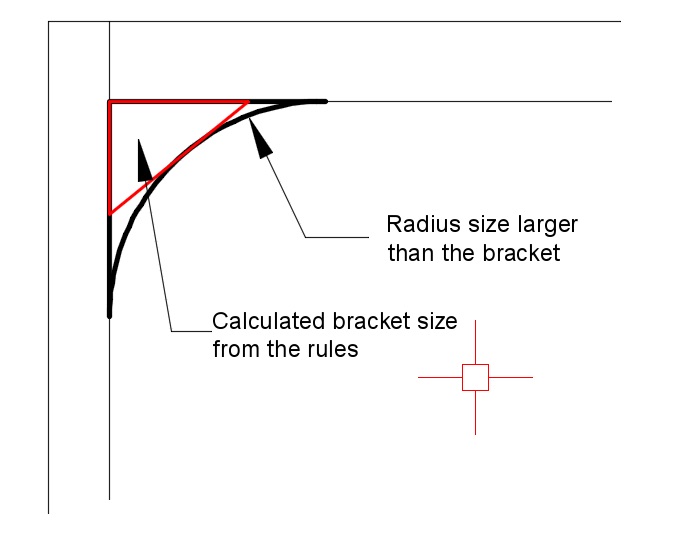

    Thanks RX,
    I suppose your images (viz. LR) give the bracket size to support two structural units, which is similar in concept to that given by the ABS in my picture 2. So, should I conclude that the radius should be larger than this bracket size? Please correct me, if I get it wrong.
    [P.S- As I calculate the bracket size from the rule, the two structural units in this case would be Cross beam and the Side Frame of the hull.]

    rxcomposite Senior Member
    ktimg- Well, not exactly. If you look at the LR guidelines, the intersection of the length effective of a bracket or gusset is 1.5x the frame/beam and the center of the diagonal is much farther. Thus, the bracket is more than 1.5x the frame depth. the center of the diagonal coincides with the radius end. ABS is more precise.
    Any major structure must be bracketed.
    When a deck beam or crossbeam is uniformly loaded, the greatest shear is at the end connections. If the beam is sized correctly, a simple gusset works as an insurance but creates a stress point due to abrupt termination at ends. This what AH is saying. A curved or radiused bracket will ease the stress concentration.
    In the case of a cantelever load where one end sinks vertically, the vertical shear stress is much greater as diagrammed. The shape is more parabolic rather than linear.
    If you look at the diagram which has been subdivided into sections, you will see that it is the web that supports the vertical shear and the flanges receives the tensile/compressive stresses.
    So what radius? It depends on the design (I am repeating AH again). The web, to be of the same thickness must be able to handle the vertical shear. The flanges, as it moves further away from the neutral axis receives less stress so it can be thinner. Max Stress= My/I. As long as the web and the flanges satisfies the designed stress for a given radius.
