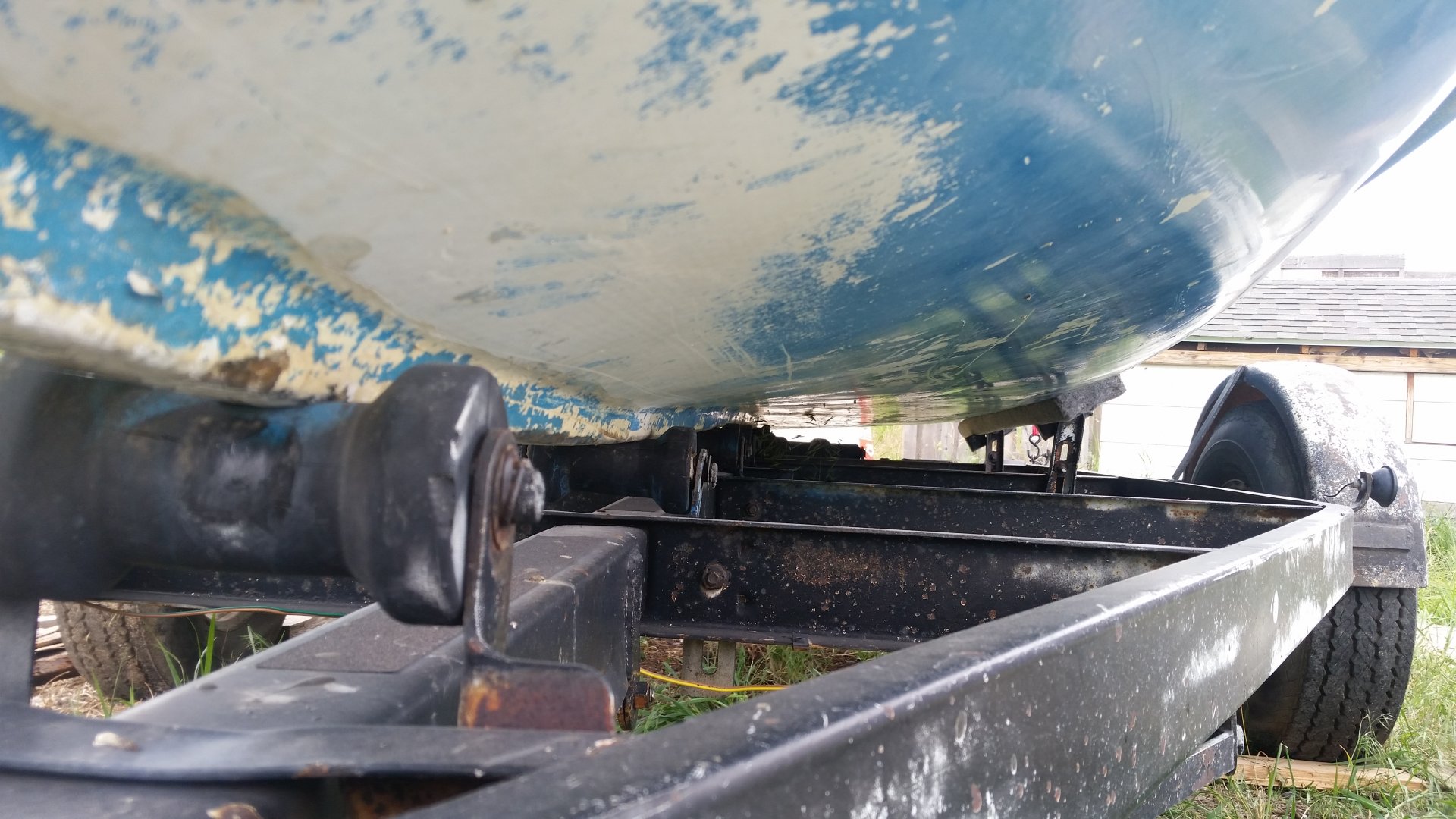

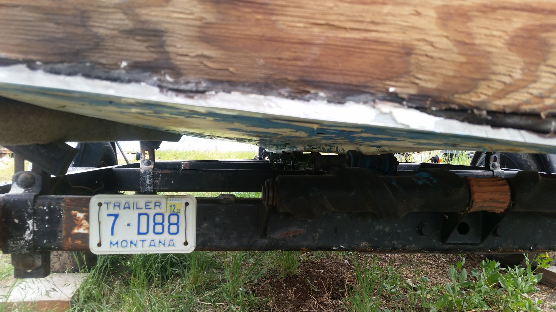

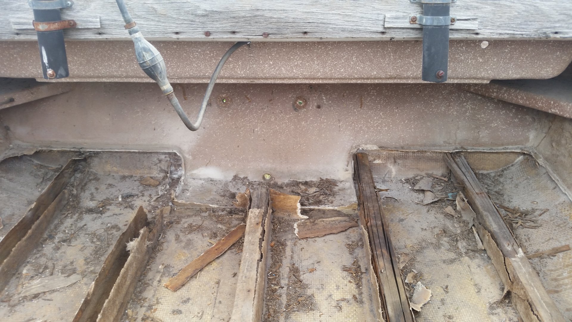

  14. Qbonez
    Joined: Jun 2018
    Posts: 73
    Likes: 3, Points: 8
    Location: Montana
    Qbonez Junior Member
    Front profile back profile and interior of transom
  15. fallguy
    Joined: Dec 2016
    Posts: 8,745
    Location: usa
    fallguy Boat Builder
    Well; for starters you are asking and that is good.
    I think you ought to pick the boat up at the transom and put some boards under the transom like 2x4s around the length of the boat beam. See if it drops from that alone.
