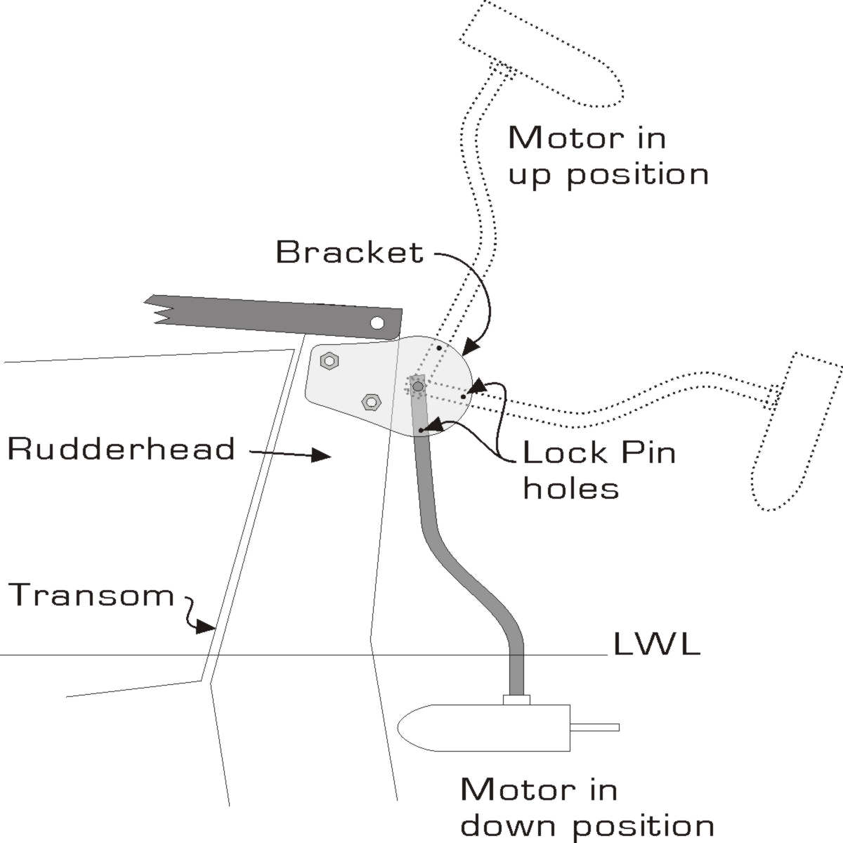

    "An electric trolling motor can be installed in the aft edge of the rudder. It can slide up and down."
    Gonzo, does that mean retaining the whole trolling motor or removing the propeller head from the shaft, and fixing it to the rudder?

    The trolling motor attaches to the aft edge of the rudder. One of the advantages is that you steer with the tiller.

    I posted my version for a trolling motor/ rudder mount in an earlier thread. The benefit of my rig is it is retractable and also removable from inside the cockpit of the boat. On a small sail or rowing craft I don't like the weight hanging off the rudder all the time. There are times when I don't want the thing mounted at all, other times I want it available, but not in the water. The slider thing works, but it's only easy to get at on pretty small boats. With mine the boat can be much larger. It was listed in the "jet Power ..." thread, here's the drawing.
    http://boatdesign.net/forums/attachment.php?attachmentid=1018&stc=1

    Thanks for the replies, but Gonzo I find your warnings about dories a bit dire, considering their long history on the open ocean. Did I mention that I'm a canoeist? I'm planning to use it well-loaded, as a camping boat. Thanks for the thread reference, PAR, I'll follow it up.
