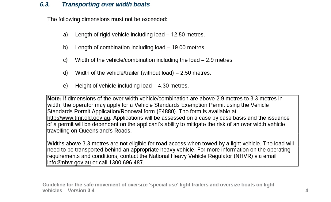

    I was actually thinking the Bertram/Caribbean 25/26 would be a good choice, were it not for the 10' width limiting trailering ability. If a short trip to the ramp, daylight permit will cover it.

    Yes you are right there but I found this arvo that you can get an exemption for light vehicle oversize to 3.3m using QLD TMR form F4880 as long as trailer/load doesnt exceed 12.5m length.
    See attached screenshot from light vehicle oversize guidelines. This allows you to tow in the smaller category of regulations with larger load via exemption.

    That's interesting, I will keep that in mind.
