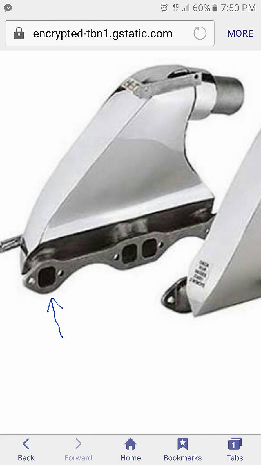

    Ok so i took the boat out today and the patch job didn't work and blew out
    The hole in in the position on the exhaust riser shown in the picture but it's in the exhaust port on number 8 not 2 in the picture
    It on the under side of the round section I'm thinking this is where salt water sits if the engine is not flushed with fresh water
    My question is the engine was running fine at low revs to get back to the boat ramp but if I tried anymore revs than 1300 rpm the engine stopped
    Is this
    Caused by the hole or is this telling me there is another problem ? ?
    Thanks
    Mike
  12. PAR
    Joined: Nov 2003
    Posts: 19,126
    Location: Eustis, FL
    PAR Yacht Designer/Builder
    A good welder can braze the hole closed. JB Weld (epoxy) and similar products will not work for very long (minutes).

  14. Barry
    Joined: Mar 2002
    Posts: 2,048
    Likes: 643, Points: 113, Legacy Rep: 158
    Barry Senior Member
    Are your manifolds aluminum??
    Judging by the shine, they could be
    If so, you can have someone tig the weld BUT any dirt, moisture, oil ANYTHING in the hole can cause the weld not to take AND if moisture can blow open the weld as the water expands.
    Before I would risk welding this piece, and I have done a few, I would get about a 1/2 inch steel flat bar by 3 inches wide. mark out the holes on the exhaust manifold or use the gasket as a guide and make this piece capture all the bolt holes, You obviously must leave enough room to get the tig torch in to make the weld so you can cut out a relief there.
    The reason is to try to limit the distortion when welding up the crack/hole. If you do not, the flanges can get out of line and perhaps the gasket will not seal. Then you will have to machine the surface to get things flat
    We used Brakekleen to try to get rid of any junk in the crack/hole. Use it outside and let it sit about an hour after you clean the spot. Brakekleen and an arc ( if it is a trichloroethane base) is hazardous to you health
  15. gonzo
    Joined: Aug 2002
    Posts: 18,284
    Likes: 2,386, Points: 123, Legacy Rep: 2031
    Location: Milwaukee, WI
    gonzo Senior Member
    If an exhaust manifold is corroded through, it is time to replace it. The leaks will start on the inside, sooner or later and fill the engine with water.
