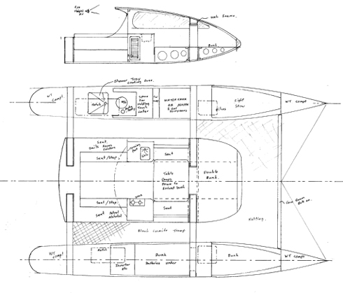

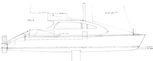

    Guzzi3 just a suggestion. Kerry Thomas is a NZ guy who describes the design below as: "The Altair ClamCat 28 was designed for a client who wishes to cruise and occasionally race locally in Florida waters." Construction plans and instructions are aimed at home builders. Yes it folds like a bigger Sango but a talk to the designer may make it into a solid crossbeam foam glass design. Jpegs below. I do not know if he is still active.
    guzzis3 likes this.

    I found the Altair website archived , a catamaran 860 was designed first before designing the folding system , explained by Kerry Thomas here in I think 2008 . There is contact info on the archived site , might still be good .
