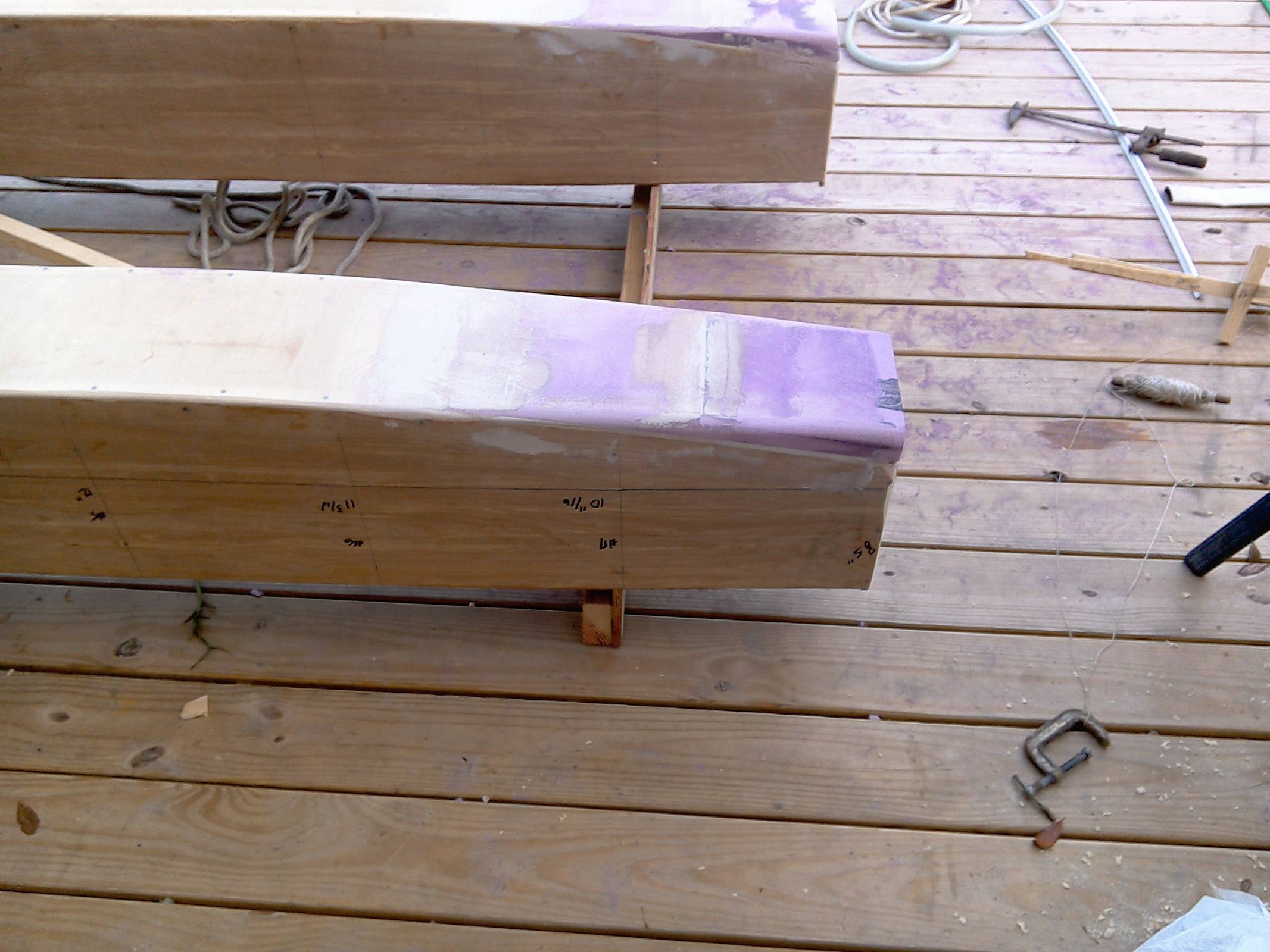

  5. Boatguy30
    Joined: Dec 2011
    Posts: 113
    Likes: 1, Points: 18, Legacy Rep: 13
    Location: St Augustine, FL
    Boatguy30 Senior Member
    I added this foam fairing to flatten the run a bit aft. Amazingly it is now 10% slower so I guess ill go with the original hull shape. Wakes, etc seemed to be about the same.
  6. Manfred.pech
    Joined: Apr 2010
    Posts: 596
    Location: EU
    Manfred.pech Senior Member
    Your experiments are very interesting. May be the flattning is working better with higher speeds and sharper chines to reflect water down and to prevent it climbing up the sides for more wetted surface and thus more frictional resistance.

    I did get the 4ish horse running. It's about a 1969 motor that had been sitting for abut 20 years. Full power we achieved rarely as constant attention was needed to the high speed mixture needle.
    But I did manage 7.2 knots with the foam removed with little more wake than at 5.5 knots. So I'm going to go with the 11' model. Will start building in August or Sept, unless something else comes along.
