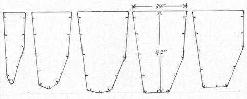

    I have bought six or eight books and searched this website for information on attaching beams to the hulls. There is just not much written about it. I doubt that I will get to build my cat but, I am having fun trying to work through the different problems as I design it. I like the looks of small 24' to 36' sailing cats but would prefer outboard motors.
    This is what I have come up with to attach the beams. Will it work??

    It is hard to tell from your sketch, but i assume that is a plan view on a single beam?
    You need to identify the load path..in this case it is all vertical. Thus the webs of your beam are the members that transfer the load. Therefore proper attachment of the webs to the hulls frame/WTBs and also to the inboard and outboard sides of the hull are the areas you need to address.
    The odd looking bits sticking out that you show, will fail quickly. It creates out of plane bending on short members rather than the pure vertical load path you need.

    Those are blocks I would glue to the beams and bulkheads to lock the beam in position. Two straps would hold it down. The only good picture I could find was on Woods website showing a beam joined in about the same way without the blocks. It was on his Shadow model boat built by one of his customers.
    So, if I remove the blocks and just clamp the beam down it would be better? I don't want to glue it because I would need to take it apart to transport it.

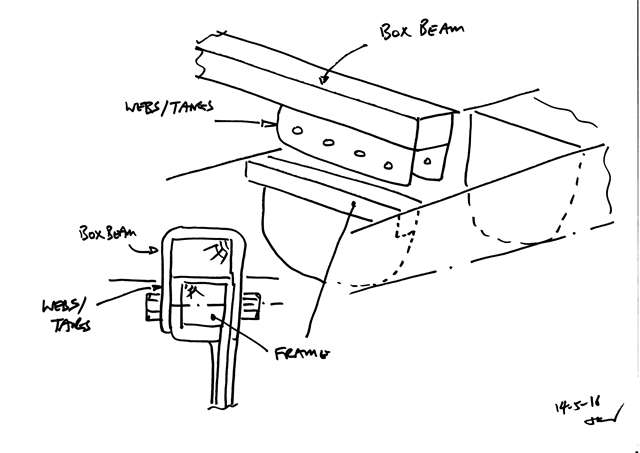

    From your child like sketch it perhaps appears so. Thus, on THAT assumption:
    Just glass in thick webs either side of your box beam. Then have a complaint frame that matches the thickness, with equally glassed up webs and then through bolt them.
    Make sure you do the calc's to work out the required bolt size, torque for the bolts, their min spacing and glass thickness for the beams and frame webs to transfer the load adequately etc.

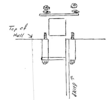

    John Perry, I will post a better sketch of how I planed to do it. I spent 35 of my working years as an aircraft toolmaker so I do understand shear and tension. What I don't understand is why there is so little usable information available on beams and hulls for catamarans. I also seem to have the ability to make people mad when I ask questions and I know that to those of you who have spent a lifetime designing and working on boats that my questions, and sketches are child like.

    John Perry, here is the end view of the beam without the blocks that I drew on the first one. There is a line on the sketch running parallel with the bulkhead that was added by the scanner

    El Gringo - OK, so the bolts are vertical, not as I first imagined. Presumably each beam to hull connection has four bolts, two of which appear in your section sketch. This arrangement looks fine to me, in principle anyway - so what is the problem?
    For selecting the bolts and designing the other parts remember that the beam will be loaded mainly in bending. Contrary to what some people think, multihull cross beams are not generally subjected to high torsional loading. Consider the simple case of a catamaran with just two cross beams and a stayed sloop rig. A severe load case occurs when the boat is close to a diagonal capsize with high rig forces and the lee bow digging into a wave. The structure is then being twisted, the lee hull trying to pitch bow upwards due to the bouyancy force on the deeply immersed lee bow and the windward hull pitching stern upwards due to the tension in whatever stays support the rig - i.e. the windward aft swept shroud and/or backstay if it is a typical multihull sloop. At the same time that this is happening, the mast compression is bending whichever cross beam(s) supports the mast base. A somewhat similar situation could actually occur on dry land if a boat yard chocks the hulls up unevenly, or if the end of each hull is supported on one of four chocks, then one of the four gives way, although in that case the mast compression would probably be less significant. Considering such twisting situations, if the hulls and cross beams had comparable torsional stiffness then both the hulls and cross beams would carry comparable torsional moment. However, because cross beams are usually much smaller cross section than hulls, it is likely that the torsional stiffness of the hulls will be very much greater than the torsional stiffness of the cross beams. For that reason the hulls are forced to carry much larger torsional moment than is carried by the cross beams but the cross beams are required to transmit that large torsional moment onto the hulls which means that they are subject to significant bending, this is in addition to any bending caused by mast compression load. So, I would suggest that a safe way to design the bolting arrangement shown in your new sketch is to assume that this arrangement should be able to transmit onto the hull the full bending moment that the cross beam is capable of withstanding.
