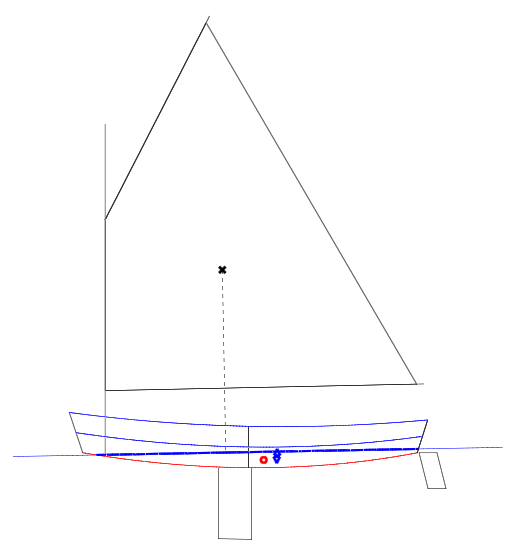

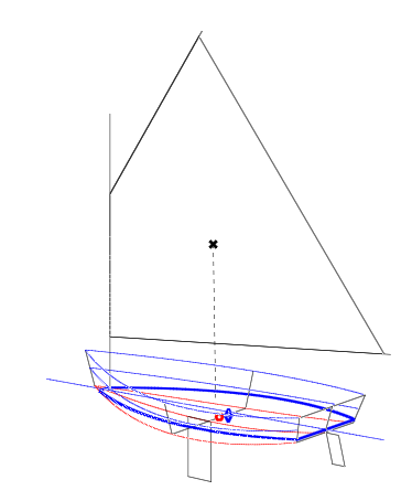

    My daughter is 2 years old. In terms of displacement, I'm sizing for myself at 150 lb, plus a 50 lb 8 year old. Not completely unreasonable for a beamy 8ft dinghy. Below is a picture of what I've got so far. It's a flat bottom, 2-plank lapstrake skiff. It's very similar to an optimist in terms of size, it looks a little nicer to my eye. I think my hull weight estimate is conservative at 120 lbs. I assumed fir plywood, but maybe I can get lighter with okoume. I'll need some kind of system to get it on and off of the roof rack, but that was kind of expected. I'd like to put a little deck and coaming on it to make it a little prettier. That will probably bring the weight back up on me.
    In the images below...
    black X = center of effort
    red circle = center of lateral resistance
    blue triangle = center of bouyancy
    inverted blue triangle = center of gravity
    The waterline shown is based on 200 lbs of human payload and my estimated weights for hull and rig. Looks OK to me. I was thinking about finding a sail that's close to this size that I can order. Anyone use sailrite.com?
    sailarea=35 ft^2
    LOA=8ft
    beam=4ft
    displacement=328 lbs
    CE 12% forward of CLR

    Looks OK. But the Boom seems a little low. Remember, this is an 8 ft boat. Do you plan on sitting on the very bottom? If you are, I wouldn't advise it. You will be sitting in a constant puddle of water. This was one of the characteristics I liked the least about the Super Snark(r) I once owned. In the boat I am building, I will be sitting about 5 inches above the bilge. Your Boom looks too low for even bilge sitting. I would allow at least 2.5 ft (30 in) clearance.
    I'm not sure the lead you drew is a good idea. Far better to end up with weather helm than lee helm, as long as it isn't ridiculous. With too much lee helm, you may never get out of it. The board so dominates the Effective Lateral Area (ELA) that no matter which way you trim the boat, the lee helm will stay. This is especially true with a deep board and a short rig.
    You will almost certainly want a double halyard for your sail, but it could be quite simple. It could be a dumb sheave for the throat and a dumb sheave for the peak. The peak halyard could simply lash to the gaff somewhere near its mid-point.
    You may be able to get away with 3/16th or even 1/8th inch plywood for the side panels to save a little weight. The gunwales will need a little beef. You could go with a double timber gunwale or a double inwhale with spacer blocks. These, along with a short fore-deck and a short aft-deck, will certainly add considerable rigidity along with plenty of potential hand-gripping and tie down points. The decks need not be thick if you don't sit on them and as long as you put a mast partner block in the fore-deck.
    I think you're off to a good start.

    I’m confused. Are you saying my CE is too far toward it too far aft? This thread started off with CE and CLR. The reference rwatson provided (Sail Balance https://www.diy-wood-boat.com/sail-balance.html#Center_of_Effort) says to place CE forward of CLR to achieve weather helm. I was targeting 10ish% lead.
  6. sharpii2
    Joined: May 2004
    Posts: 2,282
    Likes: 346, Points: 83, Legacy Rep: 611
    Location: Michigan, USA
    sharpii2 Senior Member
    I'm saying the CE may be too far forward.
    One puts Center of Effort (CE) forward to reduce weather helm. On beamy boats, weather helm is often a big problem, especially those with a long Bow taper. This weather helm is caused by the change in the bottom shape as the boat heels. It is also caused by the CE of the sails moving to leeward also as the boat heels. So, a boat with a very tall rig will have more weather helm than one with a shorter rig for this reason. Being that your boat is a dinghy, it will probably not be allowed to heel enough for the weather helm to get that bad. Another thing to keep in mind is that your boat will have a relatively deep 'board which will dominate the effective CLR, because it will produce its maximum lift at a much lower angle of attack than the immersed hull profile will. And your boat has a short rig, on top of all that.

    Your freeboard looks very low, you will dip a gunwale at very little heel which will be catastrophic.
    Your boom is far too low to get under during a tack. Also the aspect ration of your sail is a bit low to my eye.
    Dragging the transom will kill your performance, but equally you already have quite a lot of rocker. Can you not increase length a little?
    Finally you won't be able to get anywhere near the mast to raise and lower sail, so you will need to run all the lines aft.

    Synopsis: You can build that boat, as drawn for no more than 60 pounds. Use Ocumee not fir. Select any and all stringers carefully for weight and grain consistency. Move the board forward or you will suffer dangerous lee helm. Increase the rocker at the transom so that the bottom is above the design waterline. Make the mast taller so as to get some space under the boom. Increase the height of the sides to at least 16 inches...You are going to have kids in this boat, right? Make the stem higher and let the sides swoop down in a salty curve. Use minimum deck area. That is too small a boat to have much of a deck intruding into the people space. Most of all make the boat longer, ten feet at least. The extra length will make a lot of difference in trim and it will not increase the weight by enough to make a difference in loading. A longer boat is often easier to load on cartop than a shorter one.

    As sharpii2 has pointed out, a daggerboard or centerboard will tend to dominate the CLR. Each square inch of board will provide much more lift (i.e. force opposing leeway than a projected square inch of hull area. Furthermore, the lift from the hull will vary a lot depending on heel angle, displacement and speed. It may be a good,idea to allow for adjustments to mast rake or position, at least at first.

    Spent a little more time on this. I reduced the lead I had before and now CE is 5% forward of CLR. The daggerboard is now fully forward of the CE, so if that really becomes the hinge point, I should be OK. I decided to pick an existing sail design. It is the aft sail used on the Herreshoff Coquina. That pushed the boom up, so hopefully it's more realistic now. It's 47ft2 of sail area, so I bumped my boat up to 8'6" LOA. I played with the lines to make it prettier - borrowing a little from the friendship cat. I raked the transom back and added a coaming. The stem is a little higher now. The rudder is meant to look more like a Beetle cat. Freeboard was meant to be on par with an Optimist. I'll probably use inflatable bags for floatation. The deck adds weight, but I plan to have it double as the mast support. I'm sure I'll have to make some kind of rail system to load it on and off the roof rack.

    So far so good except that you have not gotten the bottom, at the transom, raised clear of the waterline. The barn door rudder along with the steeply sloped transom will tend to lift the bow when tacking. That might be helpful in certain circumstances. On the other hand you can gain some waterline length by standing the transom to vertical or near so. The big rudder will add weight at the end of the boat where it it is best to avoid excesses. You might consider a kick up rudder or perhaps a cassette type.
