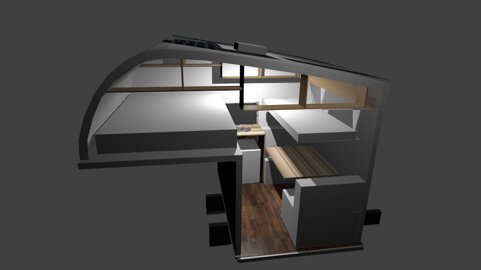

    What I am wanting to build is a cabover style truck camper for my commercial medium duty truck with leaf spring suspension. It has to be strong enough to last for hundreds of thousands of miles at highway speeds and the impact of a stiff spring suspension hitting all manner of bumps and pot holes without breaking apart.
    I have attached a rough sketch I attempted in Blender. The outside width is 7-7.5 ft. Length of the main floor is 60" and cabover about 60" long also. Not shown would be a cutout in the front wall below the cabover section for a pass-through into the truck cab to avoid having an outside door. Also would like to have two small windows either in the sides or front of the cabover and two more windows in the side walls for adequate ventilation in all climates.
    I was considering using 2" Dow Foamular 250 XPS foam board as a core as this is the highest compression strength(25psi) stocked locally, the 40psi and up would likely cost 3 or more times as much with the minimum order requirements and shipping costs. And skinning the foam with okoume plywood(4-6mm?) and perhaps 1"x2" 's in the corners and across the span of the floors for a frame.
    Will this idea work and can it be built under 500lbs?

    I wouldn't use the foam for a core inside a plywood skin, but rather just skin the foam with epoxy and an appropriate amount of fabrics. Frankly I don't think you need the foam. You could do this as a single skin GRP or as a taped seam plywood job. Both would likely be under 500 pounds, probably by a good bit. A single skin GRP could use cheapo foam, that's serves to form a male or female (preferred) mold. You toss your fabrics in, of course after making the mold, wet them out, roll out the air bubbles and let it cure. The foam would be covered with a release agent, polyethylene or other materiel to prevent the goo and fabrics from sticking to it. You just pop it out, finish as desired and bingo, Bob's your brother.
    Plywood would save the bother of a mold, though some shape limitation would be necessary, so you can bend in the plywood. Boats are built like this quite commonly and it's strong and light too. Basically, you cut and hold the edges of each panel where it needs to live, cover the edges with goo and 'glass tape. When this cures, you go back and reinforce all the seams (both sides) with more goo and tape (if necessary), then finish as desired. Given the quite annular structure you have, plywood seems well suited, but it's your call. The internal furniture can be added afterward or done at the same time as the outer shell.

    The reason for the foam is insulation. I will be sleeping in this in climates from -10F to 100F with my wife and kids and minimal climate control. Since the foam has to be there anyway, my thinking was why not make use of it as a structural element?
    Was I underestimating the strength of a thin okoume plywood over foam core for this type of structure? Maybe no wood framing but only some inserts where it will mount to the trucks frame and to give something substantial for mounting cabinets and the fold-down berth? A couple of layers of mid-weight glass on the inside of panels, epoxy and fillet the panels together and then glass the outside?
    I am worried, if I build it too light, I will either have the cabover section start breaking away or the floor to wall joints failing . If I am over-building I may end up with something too heavy for my purposes.
    I currently assemble boats for a living and have little to no knowledge on the engineering of composites so please forgive my ignorance in this area. Thanks in advance for any follow up replies.

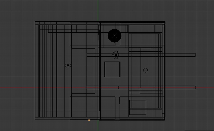

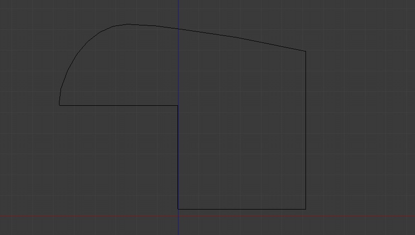

    How much work have you done in Blender? I ask, because it's likely you'll need a bit of engineering to address loading and laminate schedules. Can you post more images, say a profile, plan and sectional view and any others you think may describe your structure a little better.

    If you look at the top view picture, the rectangles coming out to the right is the truck frame rails. This is not intended to be a slide in type camper, but bolt to the frame. This is more like a non-integrated sleeper on a semi truck. You can find them used for under $1000 but they don't have the interior volume and are over 600 lbs.
    Slide-in truck campers are easily 1000+ lbs dry weight, likely to have damage in the cabover section from water leaks and would require major modifications to fit between the cab and trailer.
    Since it is intended to be a rather permanent install, maybe I would be ahead by building something that is attached with bolts and adhesives to the cab itself?

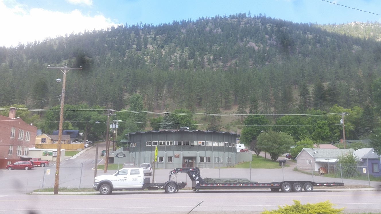

    It is a cab and chassis, not a pickup. Something like this attachment is what I am working with.

    What is the width of the frame, and the overall width of the cab?
  15. Auntie Frannies
    Joined: Mar 2014
    Posts: 32
    Location: Michigan
    Auntie Frannies Junior Member
    Outside frame width 34"
    width of cab ~76"
