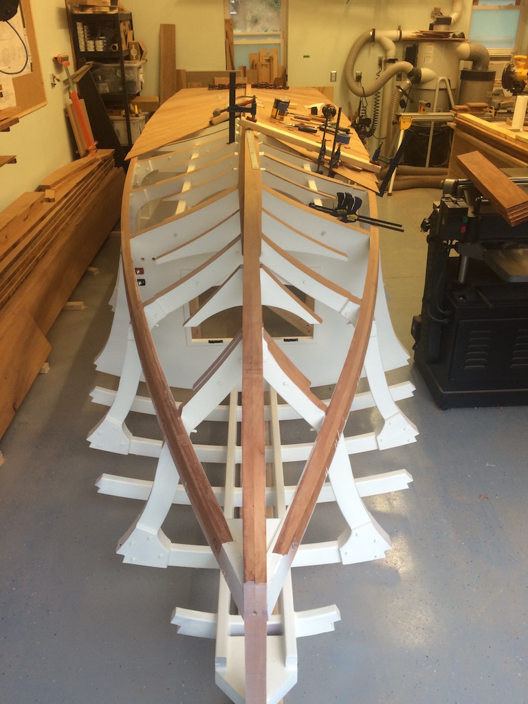

    Hi OP, I was wondering if you have any updates to your build for this forum or anywhere else? I am also planning to start building the Palm Beach when I finish my house remodel project. I saw a Hacker Miss APBA mid-construction this summer and developed an itch but decided the shorter Palm Beach would be a better build for me.
    I was also wondering how thick your frames are and why you chose solid timber in lieu of a CNC cut plywood sheet? I was thinking a 3/4" okoume plywood CNC cut frame (yours seem much heavier?) with doubler plates where required? If it is a matter of resources then I understand the other approach. Would the 3/4" plywood be enough? It seems to me as though it depends on the builder which construction method is used.
    I see you are planing on using 1/2" solid planks for finishing the outside of the hull? I was wondering if builders might use 1/2" thick mahogany plywood cut into planks for the outer wood layer and if there are issues with the finishing?

    I have not been posting updates for the build, It has been enough work building her let alone documenting and publishing updates online ;)
    The frames are 5/4, I was planning to make them 4/4 but the lumber I ended up getting was a litter thicker and I did not see the benefit of nocking off the addition thickness. As far as 3/4" plywood being adequate, I do not have the experience to give you an answer, but i know for sure much more info about the planned construction method would have to be known to give an answer.
    I chose to build her with solid mahogany from the frames to the planks based on conversations I had with some of the builders at Hacker Craft and information gathered on other proven construction methods. There are pros and cons to this as with all construction methods, and in my opinion, the comfort level of the builder with the method used plays a role as well.
    Again, i am not an experienced builder, but I would think that using plywood outer planks has too many negatives: possibility of burning through the outer layer of ply when fairing and the same thing for refinishing down the road are just a few that jump out at me.
    Best of luck with the build and feel free to reach out with any questions you think i could help with.

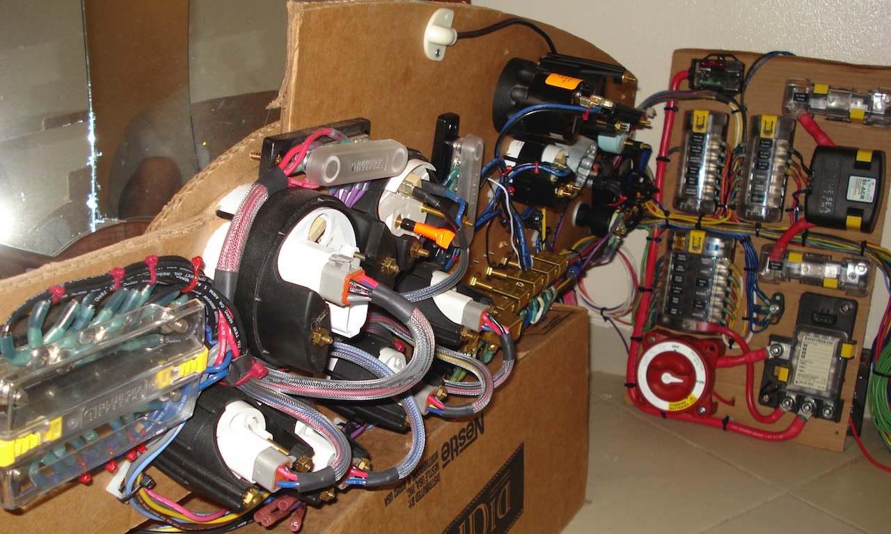

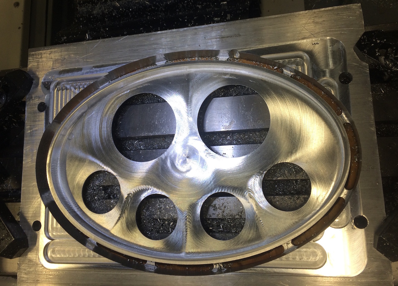

    Here are a few pics: one of the gauge pan i milled on a CNC machine a few months back and one of the wire harness mocked up on cardboard.
