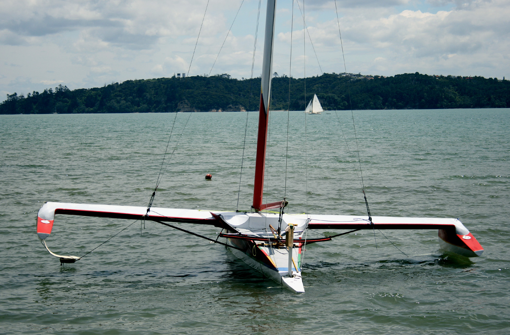

    Why is everything getting progressively cruder?
    Can you imagine bumping the amas (floats) on a dock or land and not having them break off? A couple of flat pieces of ply?
    PVC tube amas? Great shape, ought to have lots of extra drag so you don't go too fast.
    But you probably don't have to worry about burying a lee bow, doesn't look like it will hold up to that much load.
    Can't say I really have confidence in 13 knots, either.
    Bolger would have been proud.
    Anyone actually seen one of these?
    Interesting that you have to be stuck with paying for the plans before you can find out anything on his forum site.
    Any reason why this wouldn't be just as good? Same plans site.
    http://www.duckworksbbs.com/plans/gumprecht/drifter12/index.htm

    Hello,
    I have build this tri and sailed it a lot during the last year.
    The boat sails nice, and the PVC floats have given no problems.
    Some might say the boat looks crude, but I happen to like the quirkyness.

    It's not better per se, but for me the Little Tri is better than the Drifter 12 because
    - it's bigger
    - it's got a self draining cockpit
    - it's got alu beams (less construction/maintainance)
    - it's got pvc floats (idem, and I don't have to be too cautious docking etc.)
    - it's got a simpler to step/unstep rig
    - it's got a practical outside leeboard and open back cassette rudder
    - I like the look and the squareness, it's more fun overtaking people when you're in a strange looking boat (a bit childish, I know).
    I guess for you the Drifter is better because the floats look (and perform ?) better, and the whole boat in general looks neater.
    Cheers, Hans

    Zilver,
    Thanks for responding. But....
    - it's bigger - So look at the 16' of the same design
    - it's got a self draining cockpit - Got me there I think
    - it's got alu beams (less construction/maintainance) - A single plank of wood is pretty simple, and cheaper
    - it's got pvc floats (idem, and I don't have to be too cautious docking etc.) - Not sure I'd call this a benefit with the poor shape, low stiffness, and low strength of PVC. My other concern was how it is mounted. Looks easily damaged
    - it's got a simpler to step/unstep rig - They both have an unstayed rig which can be removed from the boat by pulling upward. Mine has roller furling - easier to reef (actually most rigs like Little Tri can't be reefed), and there is no separate sail to store.
    - it's got a practical outside leeboard and open back cassette rudder - generally a leeboard will work but not as well as a centerboard (the leeboard might be a benefit to some) and I don't know what actual benefit an "open backed cassette" is.
    - I like the look and the squareness, it's more fun overtaking people when you're in a strange looking boat (a bit childish, I know). That's completely your choice which I'm happy with. Its just not my choice - I just want to pass them.
    Obviously you like your boat and I am reacting to my prejudices.
    Glad it works for you.
    Actually the one I showed does not suit me, I would prefer something not flat sided with more sail capacity. :)
