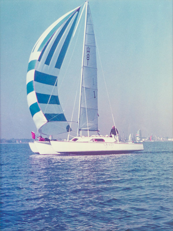

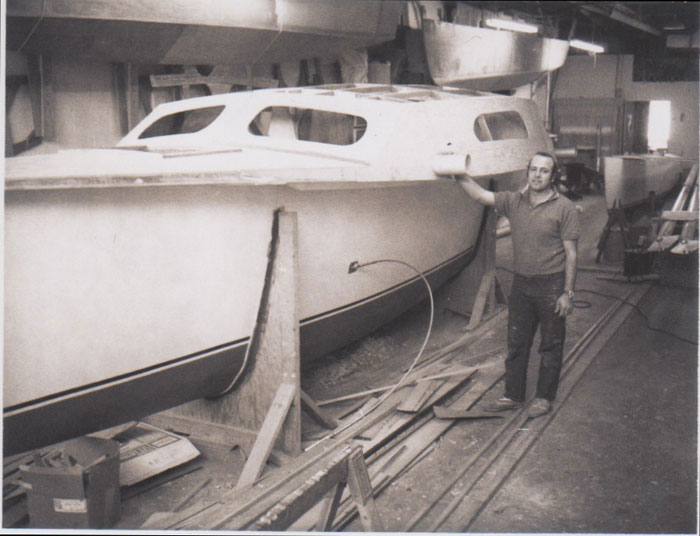

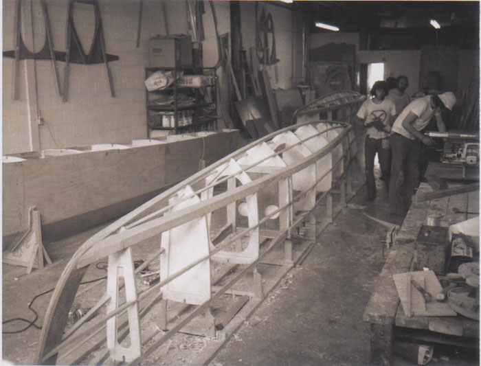

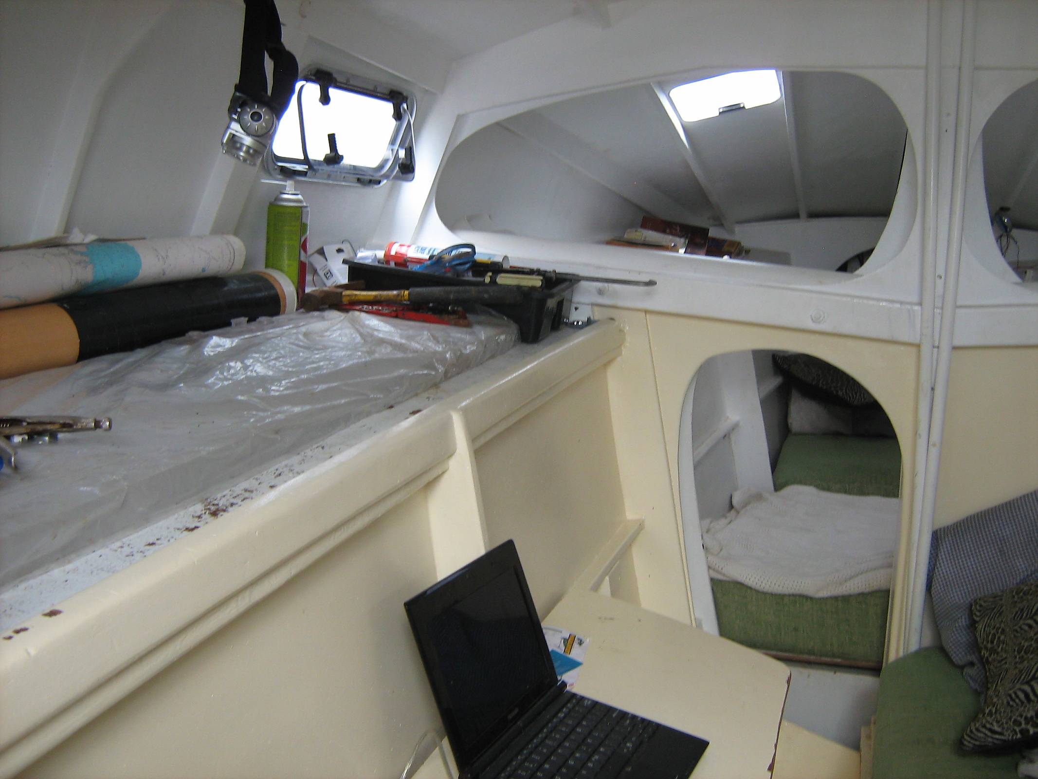

  12. redreuben
    Joined: Jan 2009
    Posts: 1,778
    redreuben redreuben
    Here, are some 28 pics I have gathered.
    The blue and white spinnaker and the black and whites are Oldsailers photos (I think).
    The boat cruising with the dinghy on deck is Mark Pescott' boat.
    The interior photo is from a boat advert I think.
    Hope they inspire.
