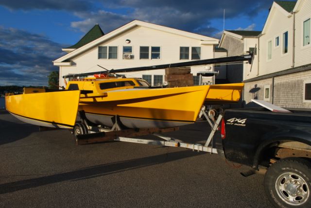

  13. Headharbor
    Joined: Mar 2010
    Posts: 67
    Likes: 4, Points: 8, Legacy Rep: 26
    Location: Boothbay, Maine
    Headharbor Junior Member
    Hi Barry,
    Unfortunately, I have been spending more time thinking about selling my Bucc than sailing it as my family has grown, and "my time" is nill. But! a sudden change of plans from the commodore has me thinking I will launch the boat in a couple weeks. Lovely change.
    Re Floats: I had angle Al welded on to the beams. I will bolt through the deck to a backing plate below. Shims can be added to raise or lower the pitch of the floats.
    Re water stays: I had beefy 'eyes' welded to the beams for the water stays. I replaced my flat bar water stays with short lengths of SS wire, and will use lashings instead of turnbuckles. The only reason I am using SS wire is for abrasion, we have a pile of lobster buoys that occasionally get hung up on the stays.
    I do like the wide deck. I think on my glass/foam boat there is minimal weight penalty, but you gain considerable footing, and the spray over the bow is a non-issue. I have only noticed wave slap once.
    When I get everything back together I will post more pics.
