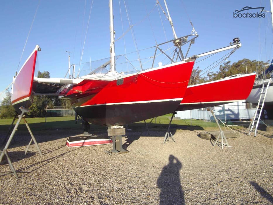

    bruceb,

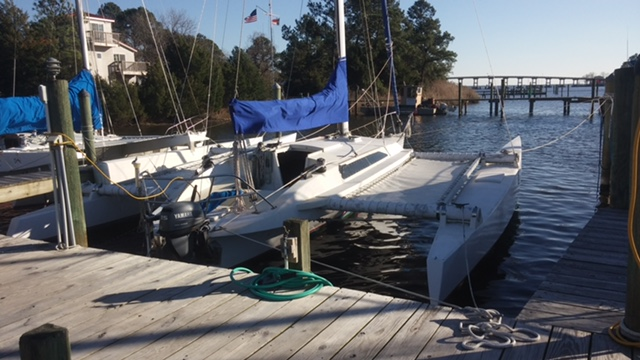

    She look great! - Here is a picture of "soon to be mine" Sagras....Note outboard rudder - swing up style which I'm thrilled with. Outboard was also moved to the transom which helps maneuverability immeasurably according to the owner but the boat clearly is stern trim down. Previous location was along side with an access door from the cabin. I may relocate....but probably not this season. Swim ladder. Clearly close to the main hull would be my preference and I get your point about the transom esp in waves. I'll prob be hanging a crappy one over a ama or use the flop into the inflatable then transfer...but I'd like a quality ladder. Tell me more about speed..if its blowing 15-18 what will your boat do? Assuming reasonably flat water and reaching no spin. I'm told the mainsail isn't original and a bit short...Do you subscribe to a bridle method to anchor/moor?
    http://www.boatdesign.net/forums/attachment.php?attachmentid=112906&stc=1&d=1492449108s
  2. bruceb
    Joined: Nov 2008
    Posts: 1,280
    Likes: 59, Points: 48, Legacy Rep: 214
    Location: atlanta,ga
    bruceb Senior Member
    "New" 33
    I like your outboard rudder, and since you will be sailing in "thin" water, it is a really good idea. Just make sure you have a way to hold it ALL the way down. I expect the transom mounted engine does help control. I have a side mount engine that I can link to the tiller which helps, but a crosswind can still overpower mine at low speeds.
    Powered up jib/main reaching will give you 12-15 kts without over pressing the Buc, but it will keep your attention. You definitely want to be able to release sheets if it starts to bury the lee float. The Buc's don't lift off and semi plane like a Corsair so the top speeds are lower, but the Buc's are very good upwind, are fast in light air and also seem to handle waves pretty well. Mine is very well balanced and only requires very light pressure on the tiller.
    I like a full size main on these boats, it helps keep them balanced and they can handle the power. If you have much wind/current where you anchor, a bridle helps keep the boat stable, but like many multis, they still will hunt around some.
