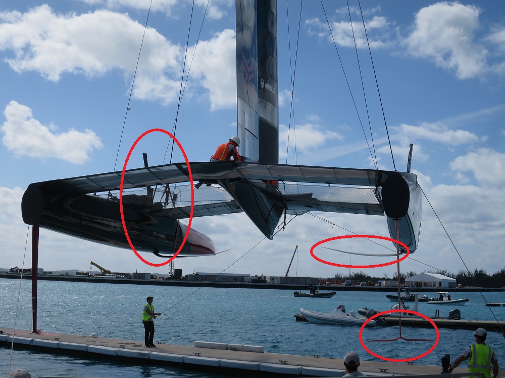

  5. brian eiland
    Joined: Jun 2002
    Posts: 4,962
    brian eiland Senior Member
    I agree with you Pogo, back to bridgedeck board ideas
    I had to go all the way back to page 25 of these discussions to find this...
    And I just found another good image to go along with those I posted..
