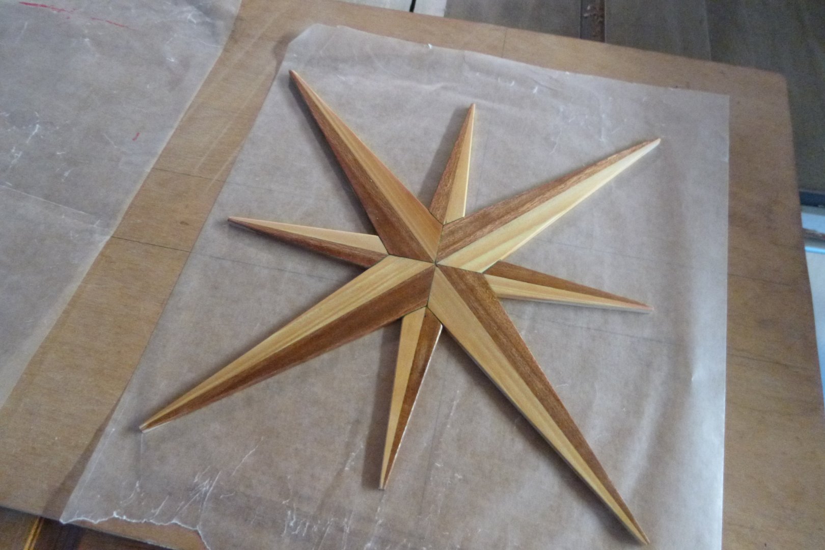

    The virus has kept me close to home, cloistered actually. To relieve some of the boredom I have messed around in my garage workshop. It is too small to build a full sized dinghy so I am building a one meter model. It is made mostly of 4mm ocumee that I had on hand. The model is an original design that presumes to be a planing dinghy under sail. The fiddly bits that hold the servos, receiver, and batteries took almost as long to build as the boat itself.

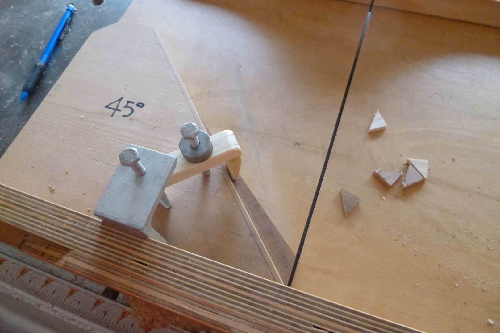

    I have been at that for a while and became distracted with a notion that I might make a compass rose. That one needed some trig to figure the angles of all the intersections. Another exercise to occupy my mind. I made some inserts for the table saw sled, hopefully to get the angles of the parts somewhere near what I had in mind. That method seems to have worked.

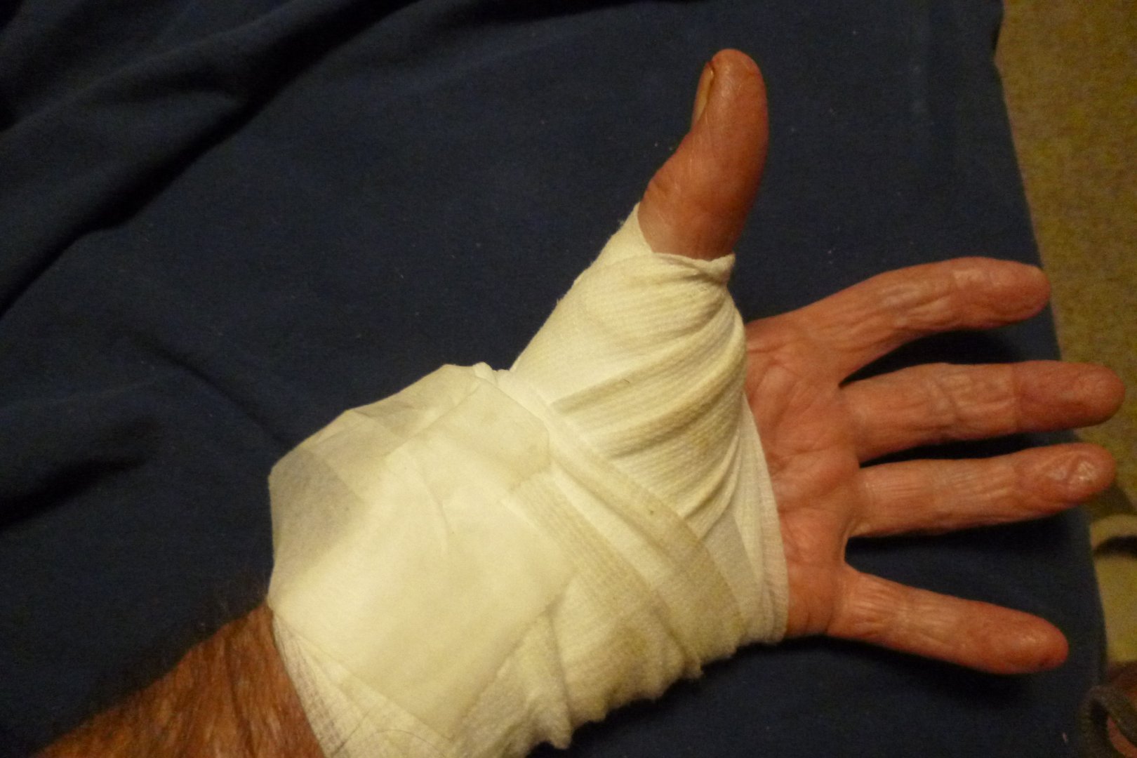

    That last picture is evidence of the stupid mistake I made. I am an experienced woodworker and a journeyman machinist. I'd ought to know better, and I do.
    I was cutting a large square of oaken 4mm ply on which to mount the compass rose. I have done that sort of things countless times, no problem. WHat happened is that I had not pushed the ply panel fully out the exit end of the blade. I then released the pressure on the rip fence. Bad *** mistake!!!! the blade grabbed the ply sheet and propelled it at warp speed toward me. It hit my hand and lifted a 25 mm flap of flesh that became pretty bloody. Seven stitches later I will live with the injury and damned well remember the stupid mistake that even a skilled craftsman can make. To this I admonish my forum friends to never trust a table saw or any other mindless machine that is capable of inflicting injury.
    You can see that I had contrived a hold down clamp for the small pieces of the compass rose. I was trying to be careful of potential finger injuries from the close proximity of the blade if I had hand held the little pieces. So I was careful with the small cuts and stupidly careless of one large cut. I do hope that my forum friends will take note of the caution P1020802.JPG P1020805.JPG P1020804.JPG P1020799.JPG P1020806.JPG they must make when building or repairing their boats.
