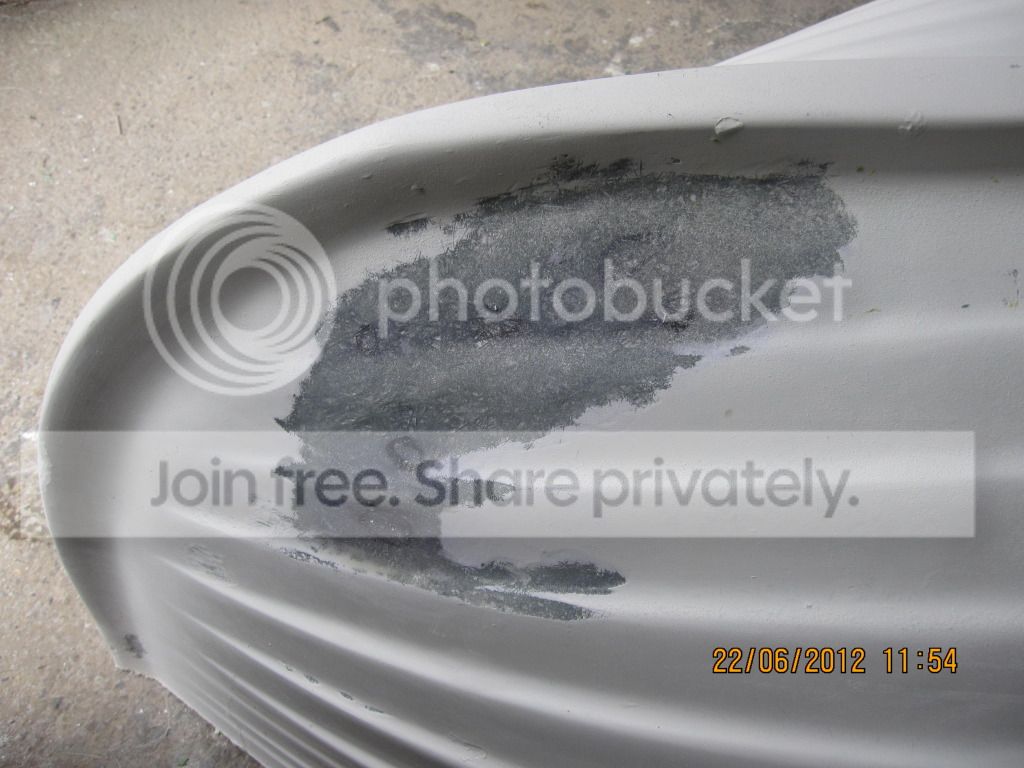

  3. whacker82
    Joined: Sep 2011
    Posts: 146
    Likes: 2, Points: 18, Legacy Rep: 33
    Location: ireland
    whacker82 Senior Member
    i might know why it got stuck second and third time. more testing will confirm my suspicion

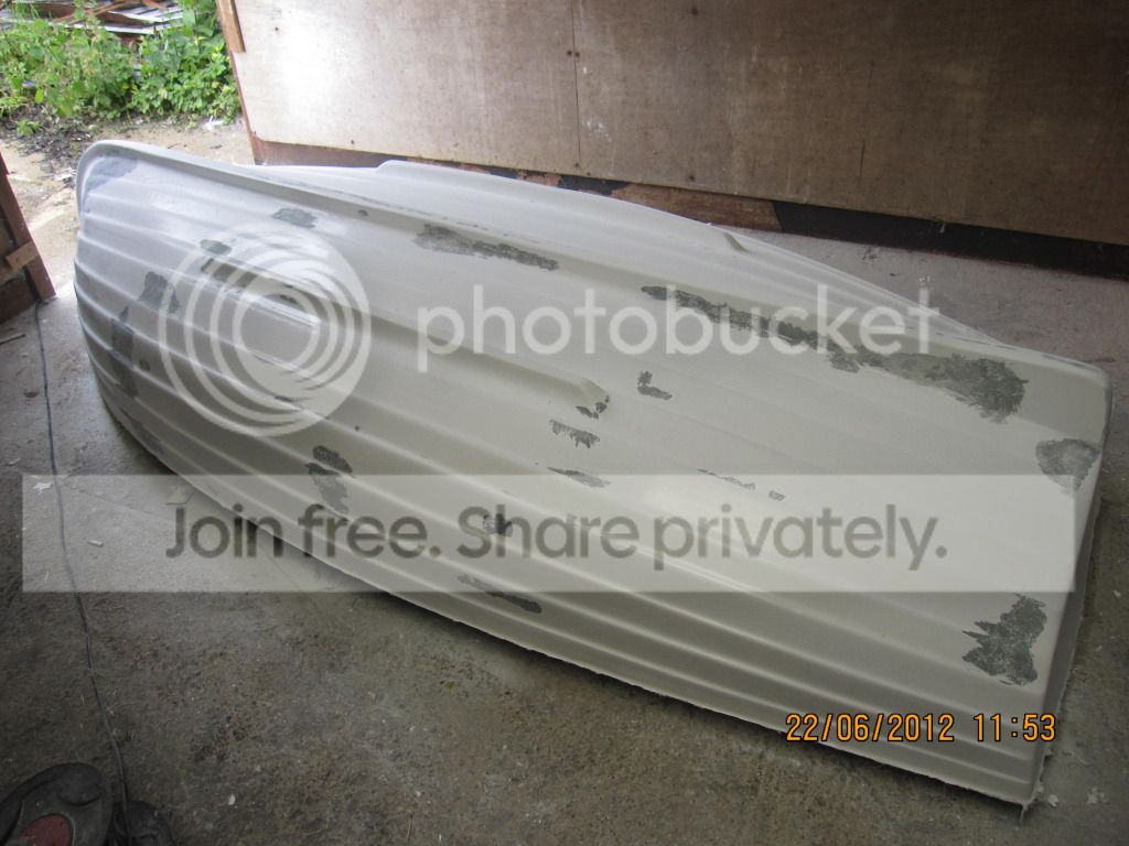

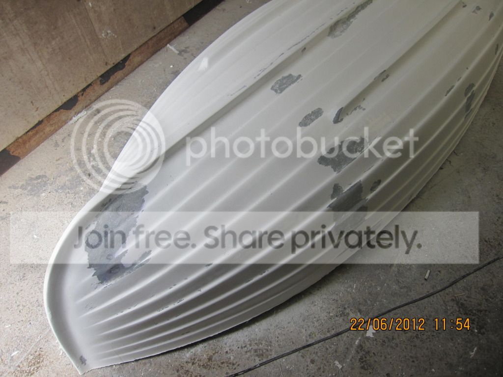

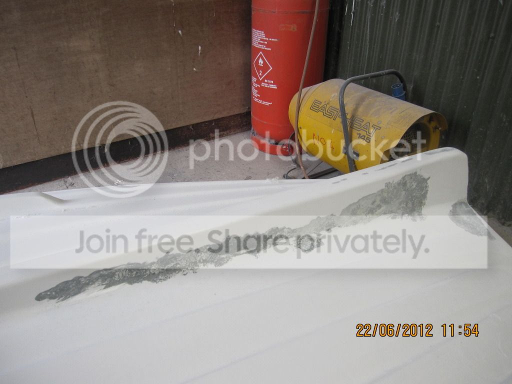

  6. whacker82
    Joined: Sep 2011
    Posts: 146
    Location: ireland
    slow down, money is tight with me, so boat is sanded and repaired, wont be ordering the materials till wed should get them fri, then ill be rebuilding the new mold. its gonna be very slow from now on. when the boat is repainted it will be left for ten days to make sure it had cured properly. before applying the tooling gel. achually plus seven days so seventeen days before tooling gel is on, due to a wax a day.
    ok as for the testing, in one area i applied the gel coat filler and waxed it about six times. when it was time to pull it from the mold it was stuck, after giving it a good old thug it came away ripping with it the gel coat filler from the mold.
    in another area i applied pva just by wetting some cloth and putting it on no added wax here. when it was time to pull it away it almost slipped off with litter or no effort whats so ever. same for the spray with no added water just pva on its own.
    final thoughts. what bugged me the most about the whole ordeal was that why did the first boat release from the mold so easiely, simple answer really because the boat mold was not damaged in any way or form.
    when it was time to release the boat from the mold the first time i should never have hit it with a hammer that was my mistake that cost me so dearly, in saying that i never knew not to hit it with the rubber hammer, it was what i was told from the fellow i bought the mold off of. i took his word for it and though no more about it.
    once the mold was hit with the hammer the damage was done and with my little knowledge of it did not no how to go about fixing it properly. i should have came here and asked straigh away.
    why did the second boat get stuck, well another easy answer. i repaired the mold using gel coat filler and it was repaired where the keel meets the stem and in one of the stringers using the filler which had no wax solution, so it was doomed to get stuck in these two places and it did badly.
    so why did the third boat i built get stuck in the mold. easy answer again.
    i have a new motto now, if it worked the first time why change it.
    when it was time to lay up the first layer of fiberglass strand on the gel coat i changed the fiberglass from 300gsm to 450gsm it was just too heavy to apply and bubbled with plenty of air pockets. it was just too heavy for me to manage it. so then why did one side of the boat look grand compaired to the other simple again. for the side that looked well and free from defect was because i put down on roll of fiberglass cut to size on the mold and applyed the resin. on the other side that got the damage i cut out two foot my three foot strips and layed them on the boat mold and over lapped the 450 fiberglass big mistake it then became 900gsm fiberglass. i have the boat up and band stands upside down so the hull is facing the roof. and when i go under the boat and look up at the damage its all in straight lines where i doubled up the fiberglass.
    now this dose not mean the other side was done right because the fiberglass did not stick to the gel coat and had to be sanded off and repaired in some places.
    this is why it stuck on me because the gel coat was not attached to the fiberglass there fore when it was time for the release it was just stuck.
    i remeber when i was cutting out the boat from the mold on the second one i was admiring how well the fiberglass had stuck to the gel coat so well. but there was one or two places where it did not so its extremely important to roll and roll that fiberglass into the gel coat. and by no means use a rubber hammer on a mold, trust me i know what im talking about. hope i wrote this as clear as possible. if you stare at something long enough it will tell you its problems.
