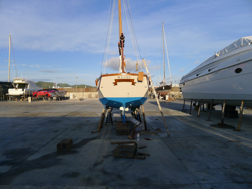

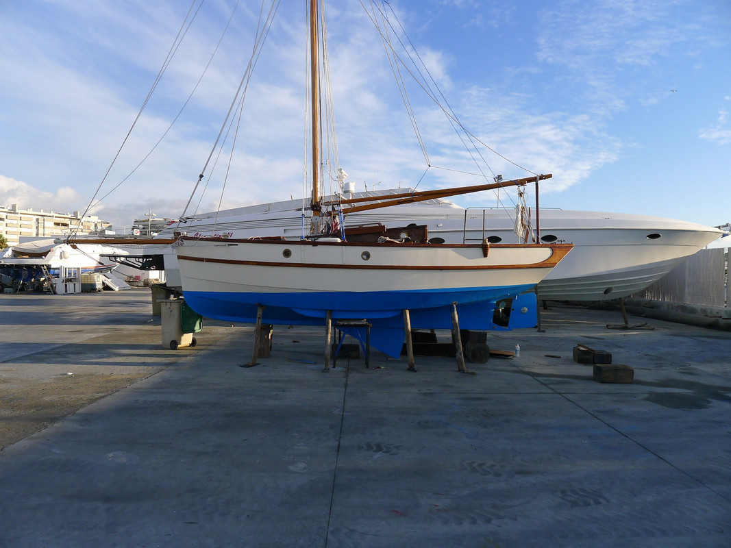

    If you live near a shipyard with boats hauled out of the water, a good way to stimulate young folks progress on their foam shipmodels is with a camera .
    Tell the kids to take pictures of a boat that interests them.... side on, stern on and bow on.
    Take these pictured and blow them up to " model size" on a photocopier .
    With scissors chop the profiles out and use these profiles as a beginning shape and reference for the model building.
