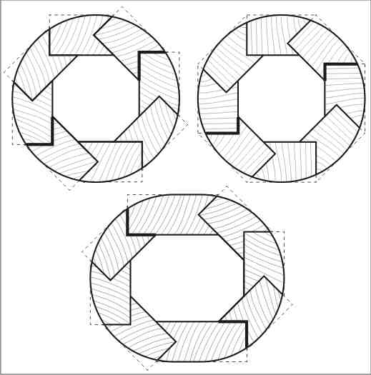

    I apologize for the crude drawing. I didn't want to take the time to draw a bird's mouth type of construction where the edges get rounded off and there is adequate glue lines to hold everything together. I was more interested in showing the difference between what I would think would be panel loaded verses edge loaded. Maybe a hypothetical mast was not a good choice. I was just thinking of something nautical instead of beams in a building.
    SamSam
    I have a fair amount of woodworking experience. Everything from making furniture to general construction to finish carpentry to making my own dinghy's and helping a friend build out the interior from a bare fiberglass hull and deck. I don't know which would be stronger in my crude mast drawing. I do know that edge loaded plywood has a significantly higher bending strength than panel loaded plywood.

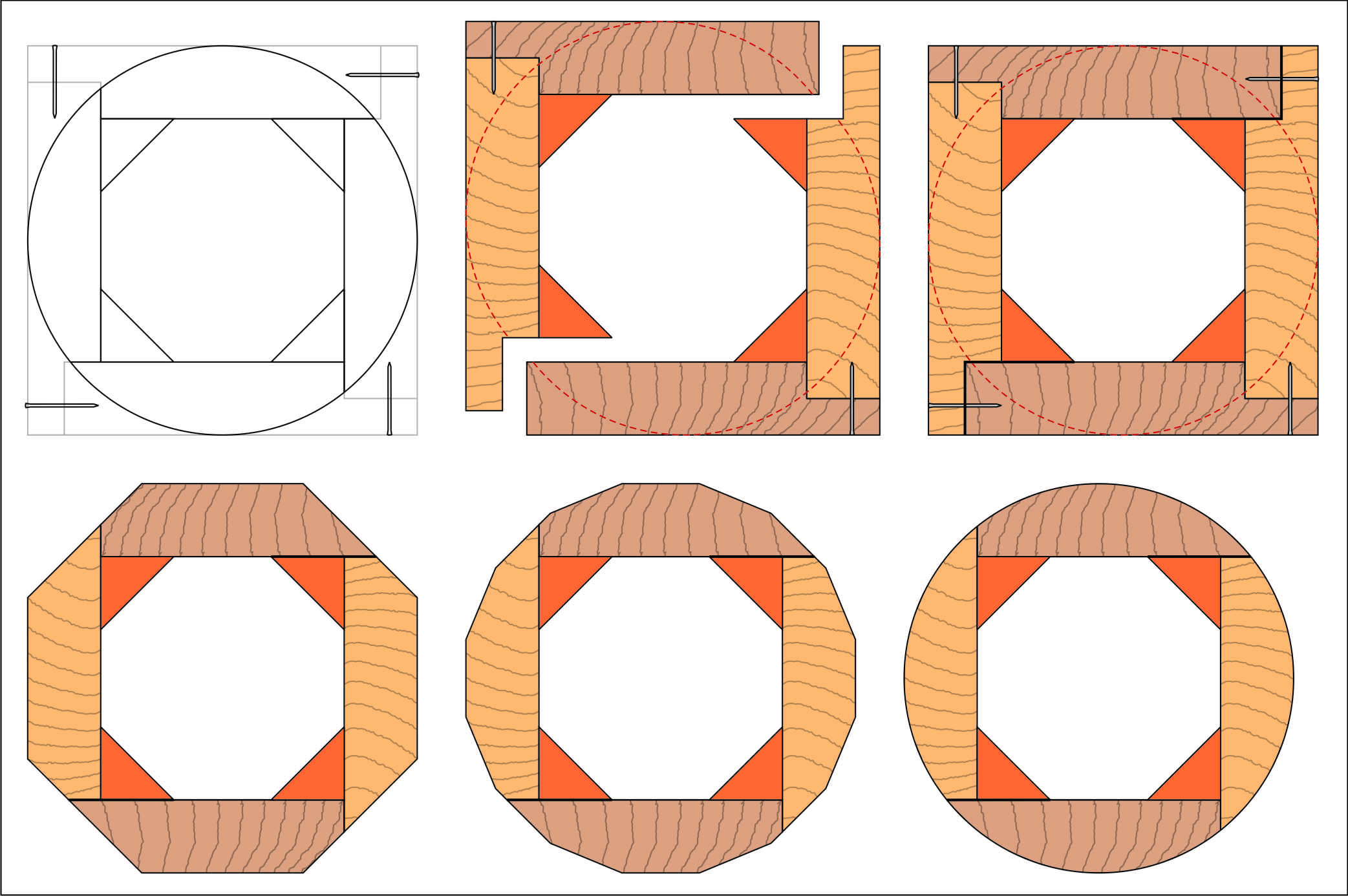

    Some interlaminate shearing can be expected in loaded plywood structures, particularly the cyclic nature of a freestanding mast. This rolling shear is yet another reason to avoid a plywood mast, in all but very small craft. Weight is another concern, comparatively with modulus and strength over solid lumber, built the same way (birdsmouth).
    Attached are a birdsmouth section and a more traditional solid lumber arrangement. Now picture the end grain arrangement on the birdsmouth build, with plywood. On the symmetrical stave notch layout (upper left), 2/3's of the glue line will be on end grain and the asymmetrical stave layout will 100% end grain in the joint, neither of which is desirable, regardless of building material physical properties. If the more traditional "built up" method was employed, there'd still be a fair bit of glued end grain, but the internal corners could be solid lumber helping to tie things together.
    If absolutely bent on building a plywood mast, use a mandrel and cold mold 1/8" over it in very slow, long, opposing (naturally) spirals. A damn difficult way to do it, but I have seen solid veneers used this way, with very good success.
