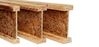

  4. rxcomposite
    Joined: Jan 2005
    Posts: 2,842
    Likes: 677, Points: 113, Legacy Rep: 1110
    Location: Philippines
    rxcomposite Senior Member
    Typical example.
  5. Barry
    Joined: Mar 2002
    Posts: 2,052
    Likes: 644, Points: 113, Legacy Rep: 158
    Barry Senior Member
    ''If you edge load a plywood, you will get only half the strength. If you look at the fiber alignment half would be vertical and half would be in the horizontal position (assuming equal plies). This is because the top portion will be in compression and the bottom portion will be in tension. The middle portion will be in shear.''
    This is not correct as the vertical plys are glued to the plys that are horizontal and contribute to the strength of the beam.
    ''"The middle section will be in shear.""
    This is misleading as there will be a constant shear load across the length of the beam within the end supports. If you are meaning shear flow, the middle section will have the highest amount of shear flow, diminishing to the edges
    ""In shear, it would be best to cut the plywood in bias cut, at 45 degree angle. This way, the fibers are criscrossing each other like trusses on a bridge.""
    You cannot equate putting the plys at 45 degrees as acting like a trussed bridge. In a truss system, the truss components are either in tension and compression,( mainly) but your 45 degree plys that are glued to the other plys, will be under mainly compressive/tension and shear flow due to the beam load (excluding vertical shear for now) AND IN THE DIRECTION OF THE BEAM.
    To suggest that orienting the strands at 45 degrees will make the plywood act like and be under the same loading/stresses as a truss is not correct
  6. Barry
    Joined: Mar 2002
    Posts: 2,052
    Barry Senior Member
    ""you will get only half the strength""
    If this were true then all the Parralam beams and other plywood beams used in construction would have the plys flat to the load. Which they are not

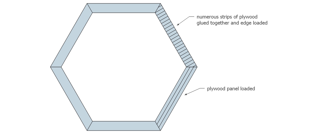

  11. Chuck Losness
    Joined: Apr 2008
    Posts: 361
    Likes: 50, Points: 28, Legacy Rep: 135
    Location: Central CA
    Chuck Losness Senior Member
    Here is a hypothetical application. Let's assume you are making a 20' catboat and the design calls for a wooden mast. No wood is available but you have plywood. Everything I have read says that plywood is not good for a mast because plywood only has about 2/3 the strength of wood due to the cross ply's providing little or no strength. But what if you cut the plywood into strips and edge glue the plywood together to form the staves for the mast. Now the plywood is edge loaded which should be stronger then the original wooden mast called for in the design. See my crude sketch showing a top view.
  12. SamSam
    Joined: Feb 2005
    Posts: 3,899
    Location: Coastal Georgia
    SamSam Senior Member
    I don't think so. The 'panel' orientation would be much stronger. Have you much experience with wood working?

  14. Barry
    Joined: Mar 2002
    Posts: 2,052
    Barry Senior Member
    This is a different from the original post
    If the original mast called for say a 6 inch diameter solid mast of fir but instead you built a 6 inch diameter, not exactly round due to the ply constraint as per your drawing, the six inch solid mast would be stronger.
    Additionally, it would be difficult to get the strength in the joints to carry the loads with glued joints as shown
