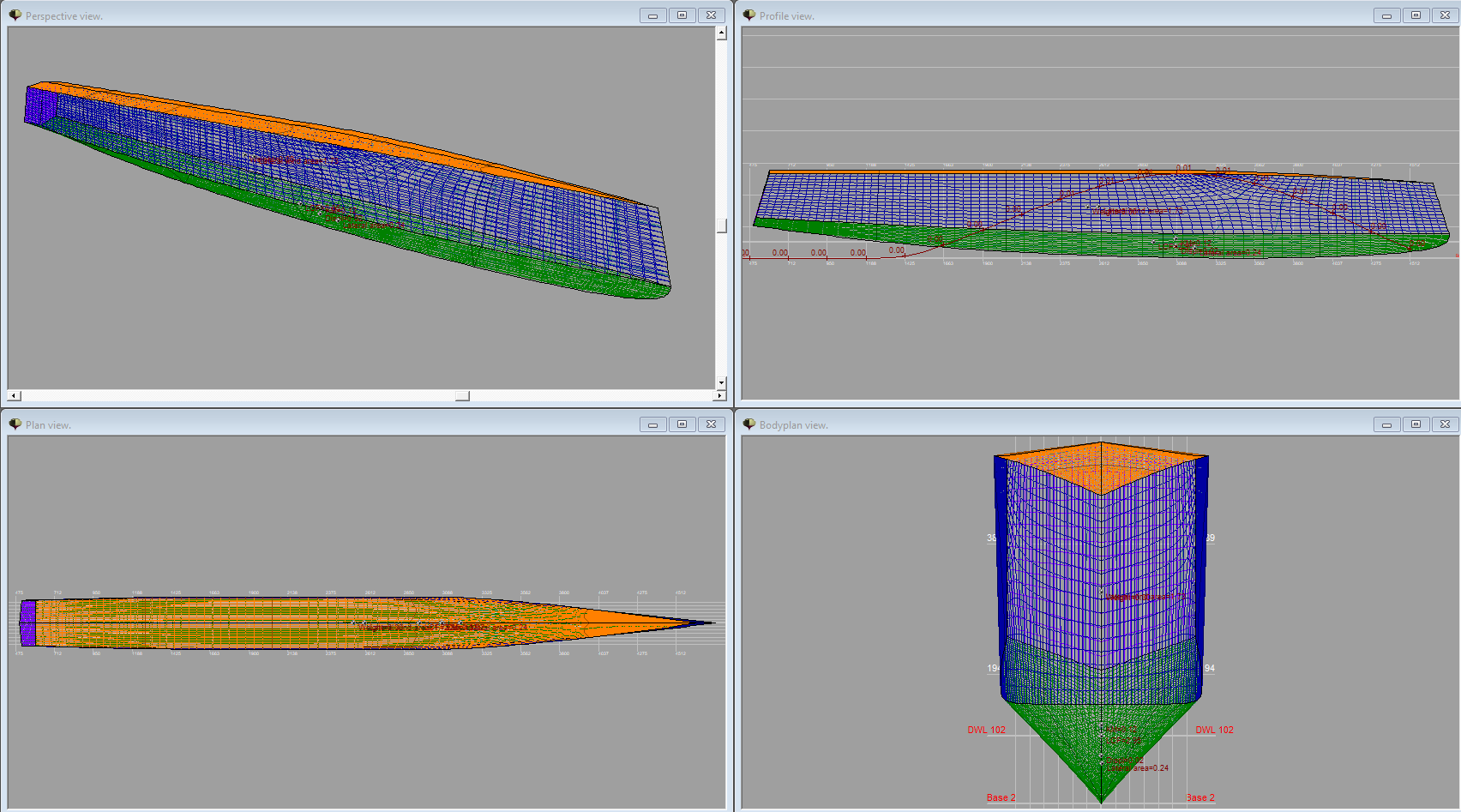

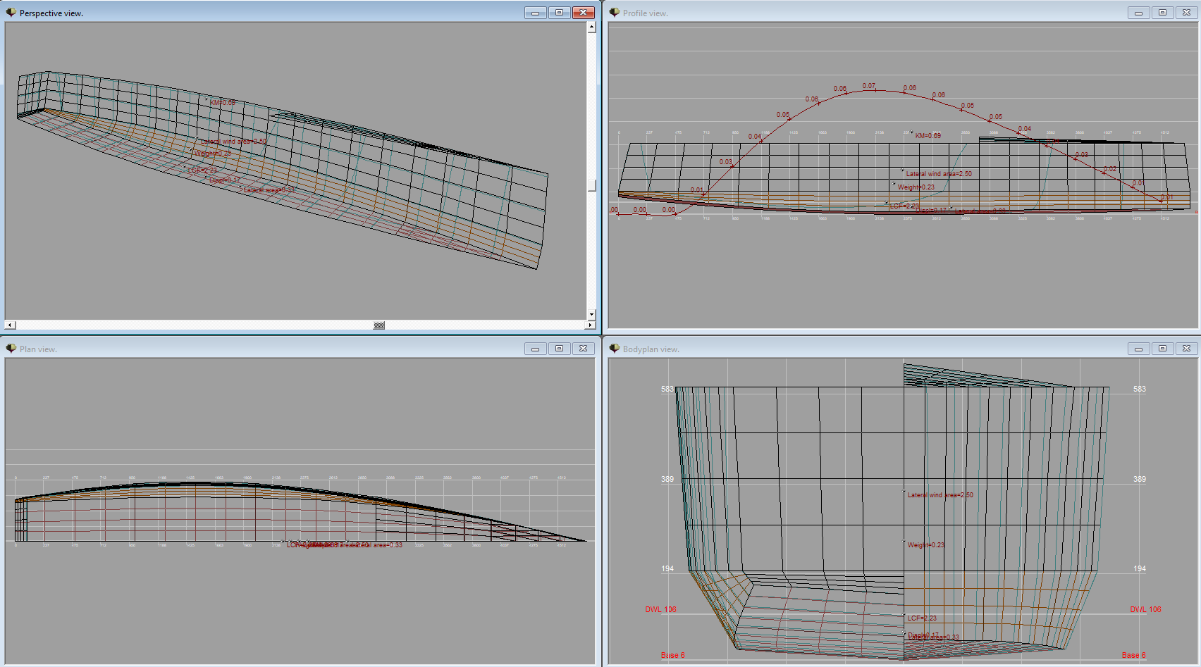

    I've attached the outline of the proposed hull shapes which will change and be refined some but basically this sort of thing.

    For the folding system I have sketched up the beams at the main hull end will fit into snugly fitting round moulded sockets and locked in place with rounded bolt down clamps so loads will be well spread there.
    The biggest weakness in the test bed was having to drill locating/holding holes and I have found some weight / strength tables for ally tube which suggest going from 70mm 1.62m to 100mm 1.62mm increases the weight by about 35% but decreases deflection for a given load by about 60% which sees like a good trade off. Before anyone dives in to point out I don't know what I'm talking about, this is just a basic indication for me that a small weight gain helps a lot with the deflection nothing more.
    At this moment I think will be looking at mocking up 100mm beams in wood again to get rough dimensions and test the folding mechanism then can rebuild it in ally once it can tested and proven to work. I can always use a thicker wall then, make changes etc.
