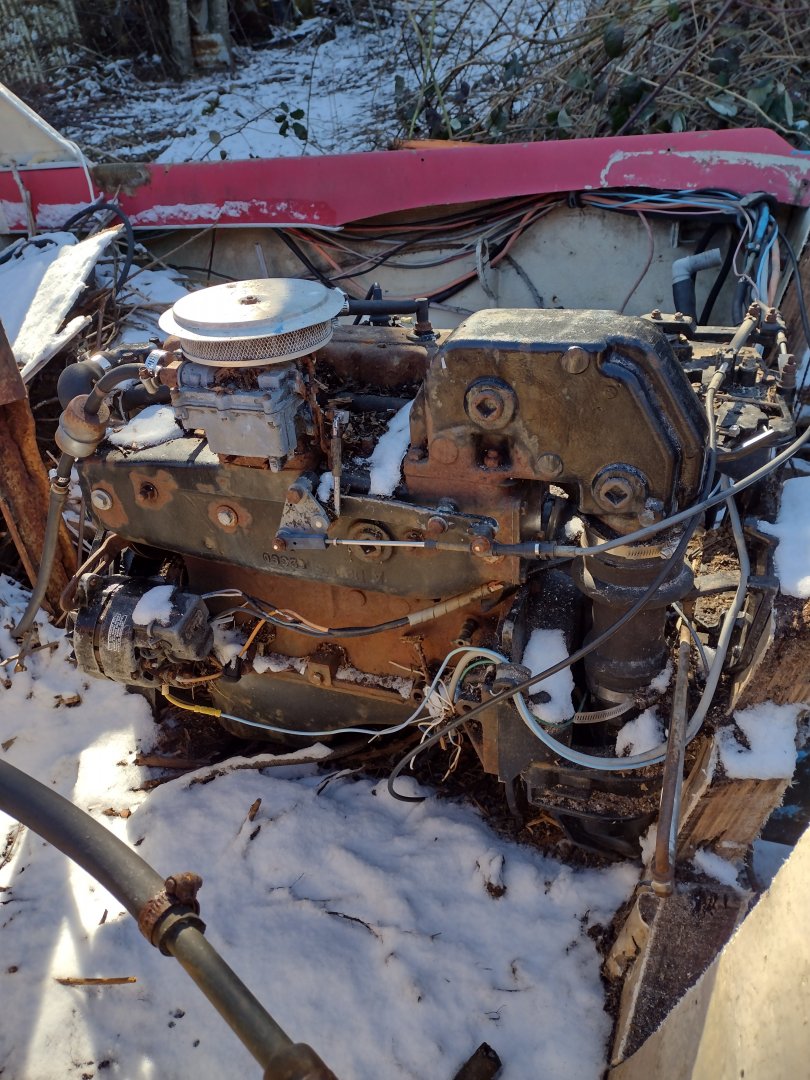

Might be permanent, Martin. The cost of repair will buy an equivalent outboard, at less than half the weight. The 3l block is around 550#, and then there's the leg, and the manifold, etc. The weight of the entire assembly, to deliver 101hp to the prop, is around the weight of Mercury's 450hp outboard.
Yes, right around 4 miles.
It is a do over John. Find a good skiff. Around here, $1500 will get you a working rig. Might be a wet ride.

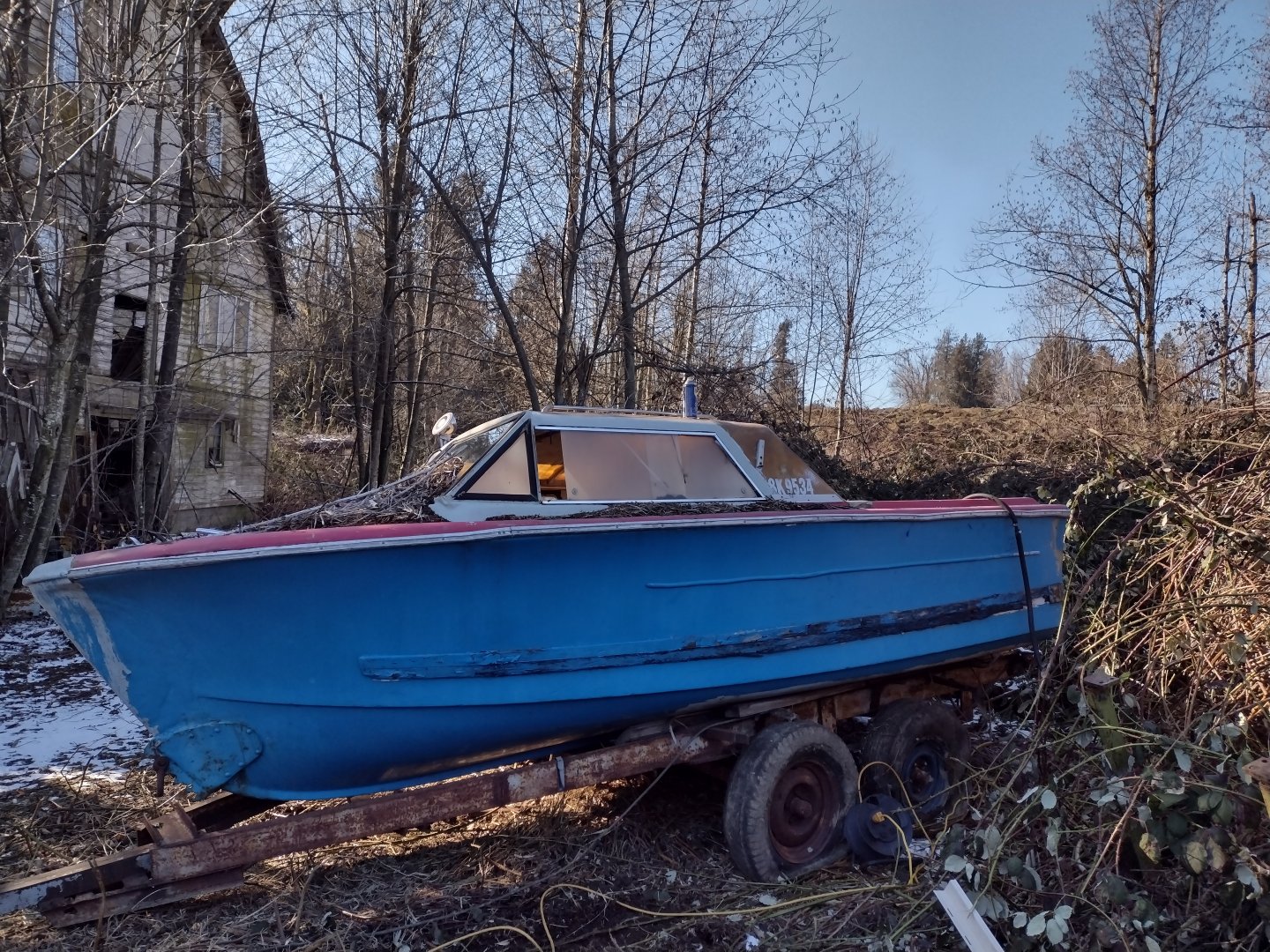

Your Binliner (sorry, Bayliner) looks nice John - good potential there, but that is a bummer about the engine.
Having a cover over the bow seating area is a wise move - and I doubt that you would be using that area much anyway, at least not until summer rolls around.
And the canvas enclosure over the helm looks very sensible, especially for use in winter! Might be difficult to arrange some type of heating, but then I know that Canucks are hardy creatures, and not phased by temps below freezing.
If you can find a smaller diesel knocking around, could that be feasible to install, rather than trying to find another similar size petrol engine?

Honestly, I have no idea. @gonzo is the man with the answers about that sort of thing.
Diesels usually run at lower rpm, so the gear ratio does not match properly.
It seems to me the issues around physically mounting a completely different engine, which custom engine mounts, shaft alignment, shaft adapter issues, and other things I haven't thought of, would be harder than reinforcing the transom to take a bracket and throwing on an outboard. But I'm sure plenty of binliner owners have learned what it would cost to replace their "iron duke", and explored other options. Maybe there are kits.
The transom is the most critical piece in a powerboat. If they fail; you swim.
