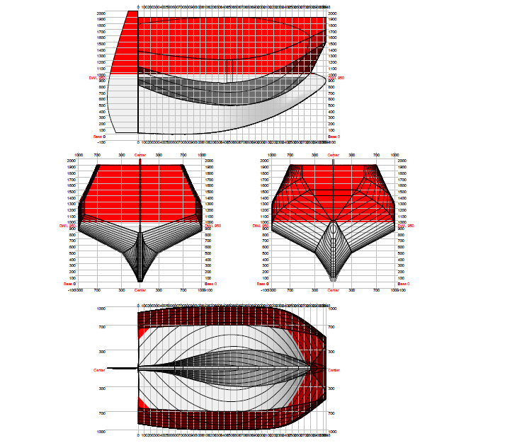

    I suppose you realize that the keel, especially in the area of the bulbous bow, is not developable.
    In my opinion, keel's are very complicated shapes, too complicated, for a boat trying to be very simple.

    I assure you that the keel is easy to achieve also by non-professionals

  9. TANSL
    Joined: Sep 2011
    Posts: 8,029
    Likes: 976, Points: 123, Legacy Rep: 300
    Location: Spain
    TANSL Senior Member
    Great, I'm glad you think I was wrong because it would have been a big problem for your boat: the newest part of the design, impossible to build. Fortunately you think I was wrong.

    the final part of the bow keel that you seem difficult, is a tapered development
    However I do not tip to anyone to build himself a steel boat to navigate the oceans, but incaricate a professionist to build the hull.

    maybe this is impossible to build
  12. TANSL
    Joined: Sep 2011
    Posts: 8,029
    Location: Spain
    TANSL Senior Member
    What do you think?. Is that the final appearance of your design?
    But it is very sad that a boat, pretending to be so simple, must be "incaricate to professionist" (whatever that means) to built the hull.
    However, that does not agree with what you say in post # 112: "I Assure You That the keel is easy to Achieve Also by non-professionals"

    It is questone of professionalism with welds

    But before welding, it is necessary to bend the plates, do not you think so?
