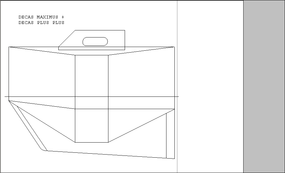

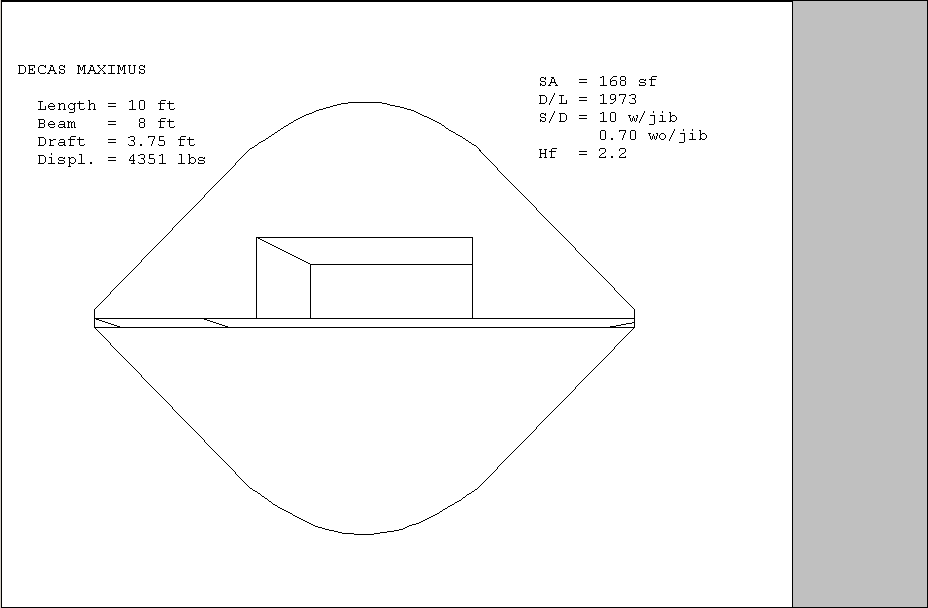

    With some embarrassment, I realized I made an error in my calculations with my DECAS boats. The smaller ones will be somewhat heaver than I originally stated.
    While fixing this, I decided to raise DECAS MAXIMUS's chine by 3.0 inches (7.6 cm).
    (See first attachment)
    This gives her slightly more volume below the chine than above it, which should allow her to move through the water easier. Her new displacement now comes in at 4351 lbs (1978 kg), which makes her other numbers a whole lot less scary.
    (see second attachment).
    She can now make do with a somewhat smaller rig of about 168 sf (15.6 sm). I decided to ditch the Chinese Lug like main and go with a gaff main instead. This way all of the main is behind the mast and the jib (really just a down wind sail) only needs to be re-sheeted with every beat.
    The rig I came up with has an 11 ft (3.35 m) Boom, an 8 ft (2.44 m) Gaff, and an 11 ft (3.35 m) hoist, netting a SA of 118 sf (11 sm) for the main. A Boomkin, which extends 2 ft (0.61 m) past the stern post provides a sheeting point for this main. The jib goes all the way to the top of the mast. Its tack attaches to a bowsprit which extends 4 ft (1.22 m) past the stem post. This nets a jib SA of about 45 sf (4.18 sm). This combined with the main falls just 5 sf (1.52 sm) short of my 168 sf goal, but I think it's close enough. The mast height had to be limited to get decent angles for the shrouds. As it is, it towers almost 17 ft (5.18 m) above the deck. The shrouds, as does the head stay, which attaches to the stem post, not the bowsprit, attach at bout 15 ft (4.57 m) up.
    Because of the head stay, The latter rung like design of the bowsprit had to be abandoned. It still hinges upward, but is now a mere pole. The jib will be set flying.

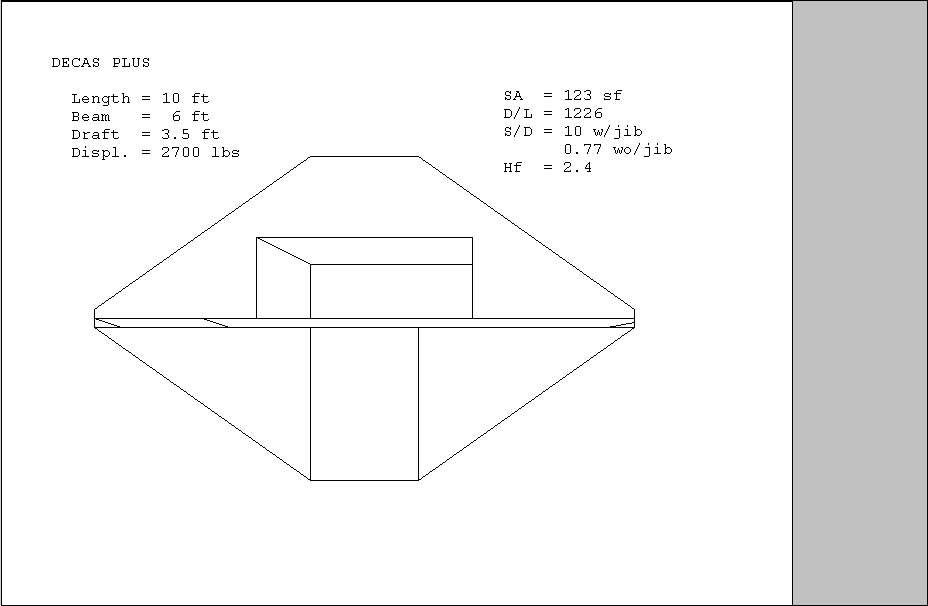

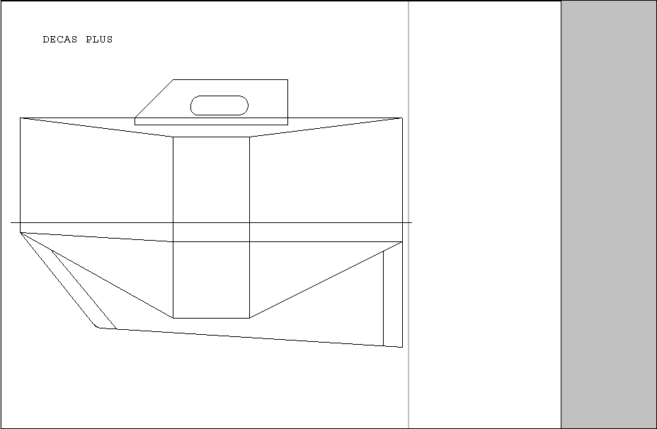

    DECAS PLUS PLUS
    ( See third attachment)
    would have a similar rig, but somewhat smaller, due to her somewhat smaller 3807 lb (1730 kg) displacement.
    For DECAS PLUS, the chine had to be raised another 3 inches (7.62 cm), to retain what I consider workable initial stability.
    (See fourth attachment).
    Even with this change, she still has a 2700 lb (1227 kg) displacement.
