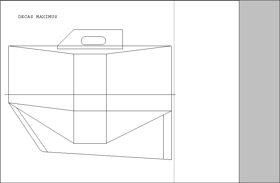

    Thinking about the Around-In-ten "rules", I realized That Hull Length is restricted, but Draft and Beam are not (as someone recently wryly pointed out, with the sailing pillar).
    So I thought up an ark like Ten, which would be good enough to be a real sailboat, but not all that good otherwise. (see attachment)
    What I have here is an 8 ft wide, 4 ft deep Ten, drawn as a facet boat.
    Comical as I'm sure it looks, I'm pretty sure it would work.
    Being a high sided double ender, with its Water Line equal to its length, it should be somewhat difficult to flip, either sideways or end wise.
    The Long keel acts as not only ballast but a means of keeping it sailing straight, despite its global lines.
    Its great Hull depth helps insure ultimate stability.
    The rig (not shown) would be similar to a Chinese Lug, but with shrouds.
    It would have a jib which would really be a flat cut asymmetrical spinnaker. It's job would be to keep the bow pointed mostly down wind.
    It would have to be lowered and raised again with each down wind tack.
    This boat would have an 8 ft bowsprit, which would extend 5 ft past the bow, and a 5 ft boomkin, which would extend 3 ft past the stern. Each would be "V" shaped, in top view, and would be able to hinge upward when in port. Each would have rungs like a ladder, and would be held down with locking pins and a single stay, with a lanyard.
    The mast would be about 23 ft long and extend 18 ft above the deck.
    Top speed would probably be around 3 kts down wind and maybe 1.75 kts upwind. Such might improve as stores are consumed and the boat reaches a more Svelte like 3,000 lbs :)
    I think it's an interesting intellectual exercise to guess the upward limit of D/L for a workable sailboat. This has to be pretty close to it.

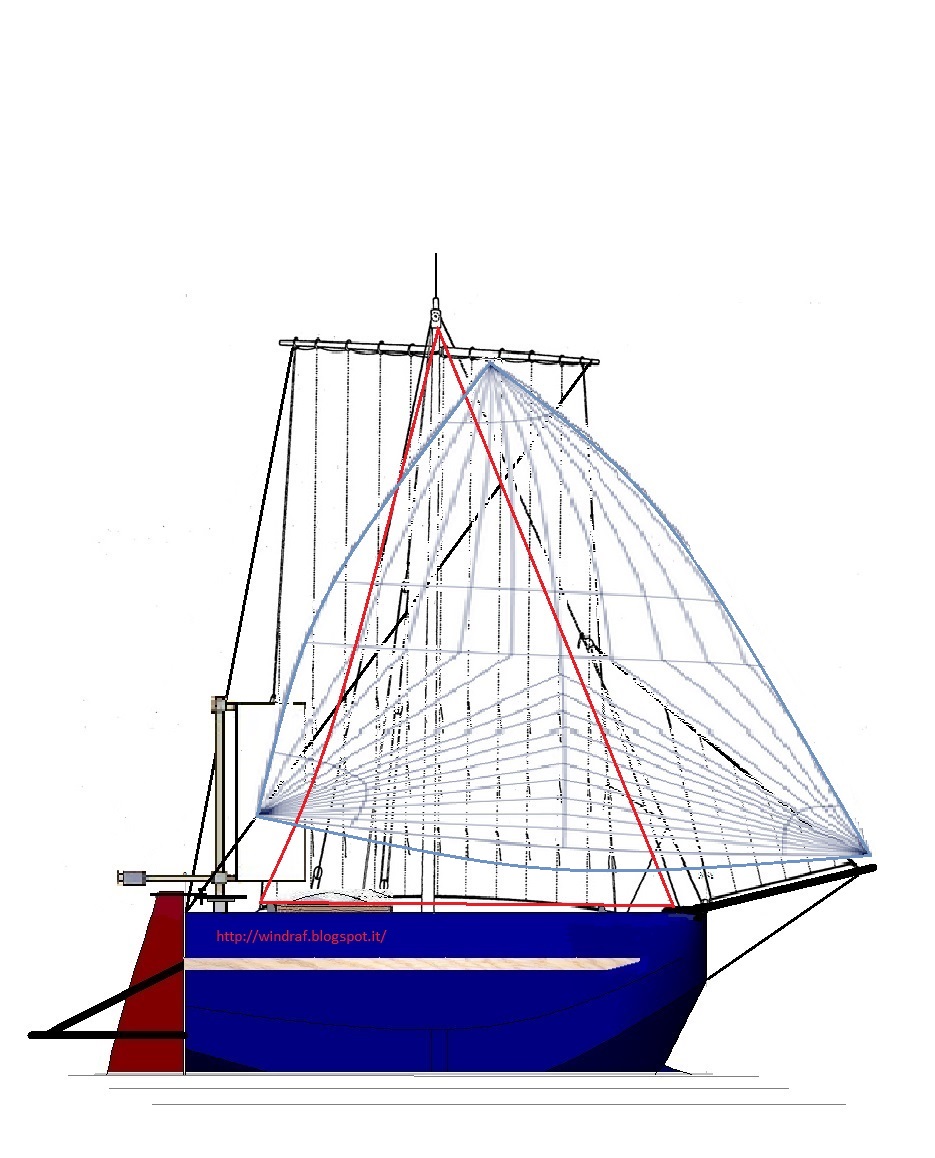

  10. WindRaf
    Joined: Oct 2014
    Posts: 343
    Likes: 5, Points: 0
    Location: Italy
    WindRaf Senior Member
    Design length : 3.048 m
    Design beam : 2.000 m
    Design draft : 1.000 m
    Displacement : 0,750 - 1.503 - 1,750 tonnes
    sail area 6 - 12 mq

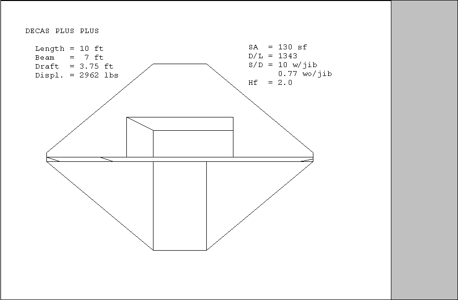

    Mostly true but not entirely.
    What you need is a boat that will sail adequately.
    For a controlled drift like voyage around Antarctica, ability to carry a vast amount of supplies, internal volume, and ability to weather storms, trumps sailing ability to some degree.
    It should be remembered that almost all of the world was explored by what today would be considered very poor sail boats. These boats (ships) could barely make windward progress, but they mostly rode the winds and currents to get where they had to go.
    Such would be the case with DECAS MAXIMUS. She would be mostly a ballasted buoy with sails. After half of her stores were consumed, she would improve somewhat, but maybe not enough.
    So I thought of trimming her down a bit. (see attachments)
    The first thing I did was trim her Beam from 8 ft (2.44 m) to 7 ft (2.13 m) then re-named her DECAS PLUS PLUS.
    Then I trimmed her draft by 3.0 inches (7.62 cm) by raising her chine.
    This cut her displacement down to less than 3,000 lbs (1364 kg).
    Due to her lower displacement, I was able to cut her SA down to 130 sf, (12.1 sm) but I left her keel the same size. This would make her a bit more of a sailboat and a bit less of a buoy with sails.
    Keeping the same profile, I reduced the Beam again, this time to 6 ft. (1.83 m) I re-named her DECAS PLUS. Her new displacement would be around 2,500 lbs (1136 kg) and her new SA would be 117 sf (10.9 sm).
    Now she looks a lot more like a boat, but displaces less than half of her biggest sister. But she could probably not do a non stop voyage around Antarctica.

  13. Angélique
    Joined: Feb 2009
    Posts: 3,003
    Too fat in length to width ratio and so with it's in ratio small lateral keel surface area not directional stable. To make it worse the mid section of the keel is inclined outwards from below to above and so when sailing at an angle this reduces the keel's ability to provide effective leeway resistance, this reduction is beyond what you whould have with a in front view vertical keel. And it has a bulb that makes the build complicated but, with the to be expected low speed of the boat, doesn't add anything as a very little extra bow buoyancy which will hardly compensate for the extra weight of the bulb. And there is a nice looking but hard to operate rig that will prove to be ineffective on this kind of boat. End conclusion: a silly design of a layman in knowledge about the subject.
