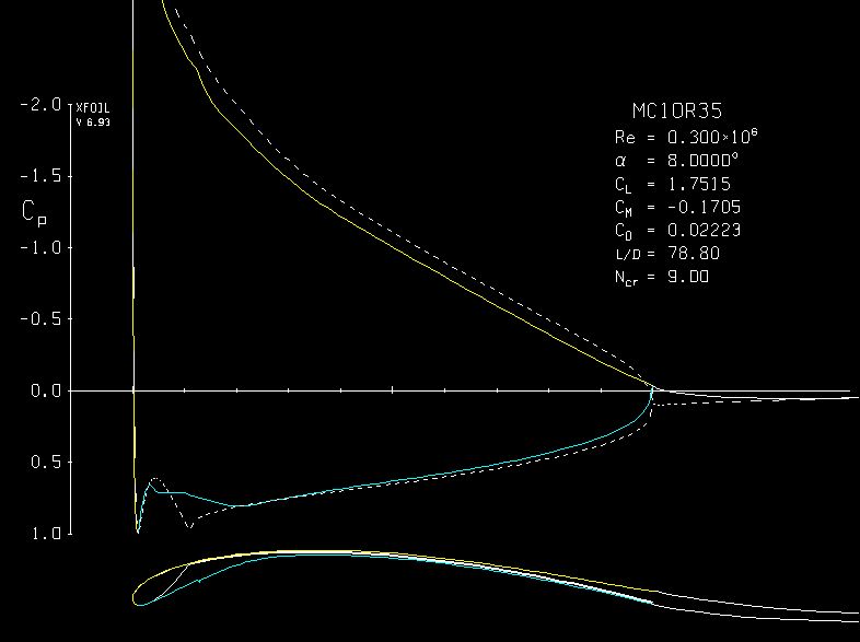

  6. tspeer
    Joined: Feb 2002
    Posts: 2,317
    tspeer Senior Member
    Double Surface Sails
    I think the Powerfoil sounds like a good idea, and I believe the Dynafoil folks are finally headed in the right direction. But I'm not sure that the explanations they give are all that accurate.
    The typical argument goes something like this, "Aicraft wings are more efficient than sails. Aircraft airfoils are thick, double surface sections with modest camber. If a sail has thickness and a double surface it will be better than a single surface sail." The problem with this is that it doesn't take into account the different requirements for wings and sails. Plus, aerodynamic tests and calculations invariably show that for any given design point, a thinner airfoil will outperform a thick one. So why use a double surface sail?
    I can only think of three reasons to have a thick foil:
    1) The depth is necessary for structural stiffness,
    2) A sharp leading edge loses out on leading edge suction, which results in an increase in drag,
    3) The airfoil has to operate over a wide range of angles of attack.
    Other than these factors, a thick section will generally have more drag and less maximum lift than a thin section.
    An aircraft has to operate at a very low angle of attack in cruise because it can't change its wing area, the lift has to equal the weight, and the only way match the weight at high speed is to use a low lift coefficient. It's the optimization for cruise that drives the airfoils to a semi-symmetrical shape. However, for landing, airplane designers do everything they can to change to a highly cambered shape to produce high lift. And when the wing is configured for high lift, drag is actually helpful because it makes the landing glidepath steeper.
    The requirements for a sail are quite different. The sail needs to produce high lift with as little drag as possible. The sail doesn't need to operate at low angles of attack because if you are that overpowered, you'll reduce the area by reefing. It's much better to use a smaller area near its maximum lift than a large area that's lightly loaded, because the smaller area has less parasite drag (less wetted surface). The sail does have to perform well for a certain range below max lift, but that range is nowhere near as great for a sail as for an aircraft.
    The ideal shape for high lift would be a thin, highly cambered airfoil. This is provided very well by traditional single surface sails. Such a sail has a narrow groove, however. If the sail is operated at too high an angle of attack, the flow separates on the lee side and the sail stalls. If the sail is operated at too low an angle of attack, the flow will separate on the windward side, just behind the leading edge. This causes drag.
    http://www.tspeer.com/temp/wm10m35r10a08.JPG shows the pressure distribution and boundary layer displacement thickness around a wingmast/sail airfoil, as calculated by XFOIL. The angle of attack is 8 degrees, and the section is close to lee side separation (stall onset). The mast and sail shape were created by taking the lee side contour of the Clark Y airfoil and reflecting the leading edge to form a teardrop wingmast comprising 10% of the chord. The white dotted line shows what the pressures would be if there was no boundary layer. The yellow line shows the pressure on the lee side and the blue line shows the pressure on the windward side. The difference between the blue and yellow lines is the normal force on the sail You can see similar flow features in wind tunnel test pictures such as http://www.wb-sails.fi/news/Stallpics.HTML
    The pressure on the windward side of the wingmast would have a steep increase approaching the mast-sail junction. But the flow separates there, as you can see by the flat constant pressure segment and the way the boundary layer stops following the contour of the mast. But the flow reattaches to the sail at about 20% chord, as seen by the pressure returning to the inviscid pressure distribution and the boundary layer getting thin again. In between the separation and reattachment points, the flow recirculates forming a separation bubble. Essentially, the flow bypasses the mast-sail junction. But there's drag associated with the separation bubble.
    This drag could be reduced if the sail had a pocket luff that was about twice the size of the mast. Then the sail could take up the shape of the blue contour. The lift on the sail wouldn't be affected because the flow outside the boundary layer would have the same shape. But you wouldn't have the losses due to the separation bubble.
    If the double surface were extended much farther aft, that would raise the velocities on the windward side and reduce the lift, just as it does nar the mast-sail junction. The lee side pressures are assumed to stay the same, because the lee side pressure distribution is already stressing the boundry layer there as hard as it can without stalling. Cutting the Reynolds number by 70% (light wind condition) doesn't enlarge the size of the separated region very much (http://www.tspeer.com/temp/wm10m35r05a08.JPG). So some double surface is useful, but not a completely double surfaced section.
    http://www.tspeer.com/temp/wm10m35r10a04.JPG shows the same section at 4 degrees angle of attack. The same general picture holds for the windward side pressure and boundary layer development. But now the reattachment point at the end of the separation bubble is closer to 30% chord. So a bit bigger double luff region would be in order here. Such a shape wouldn't reduce the maximum lift very much, and it would widen the sail's groove. And a flexible double luff might actually provide the ability to adjust this somewhat, especially if tied to mast rotation.
    Although the leading edge of this mast is fairly rounded, it isn't circular. It's still important for the sail to have a leading edge whose shape is dictated by the required lee side pressure distribution. The change in curvature between the round mast and the luff pocket will lead to a spike in the lee side pressure distribution that will promote early separation and stall, as well as a thicker boundary layer for higher skin friction drag. That's why the partial ribs forward of the mast found in some of the double luff concepts are important. Another way to get the same effect would be to have an egg-shaped or D-shaped mast inside the luff pocket.
    Finally, for another application of a partial double surface sail, take a look at Spitfire's rig (http://marine.bdg.com.au/spitfire_gallery.html). It was designed by an aeronautical engineer well versed in airfoil design, and sports a pocket that extends less than half way along the chord.
    So I think we're seeing a convergence on a sail shape that has a properly formed leading edge, smooth lee side contour, a double luff for 20% to 40% of the chord, and a single surface for the remainder of the mast-sail section. And the purpose of having a double luff is to cut the drag asociated with the windward side separation bubble.
