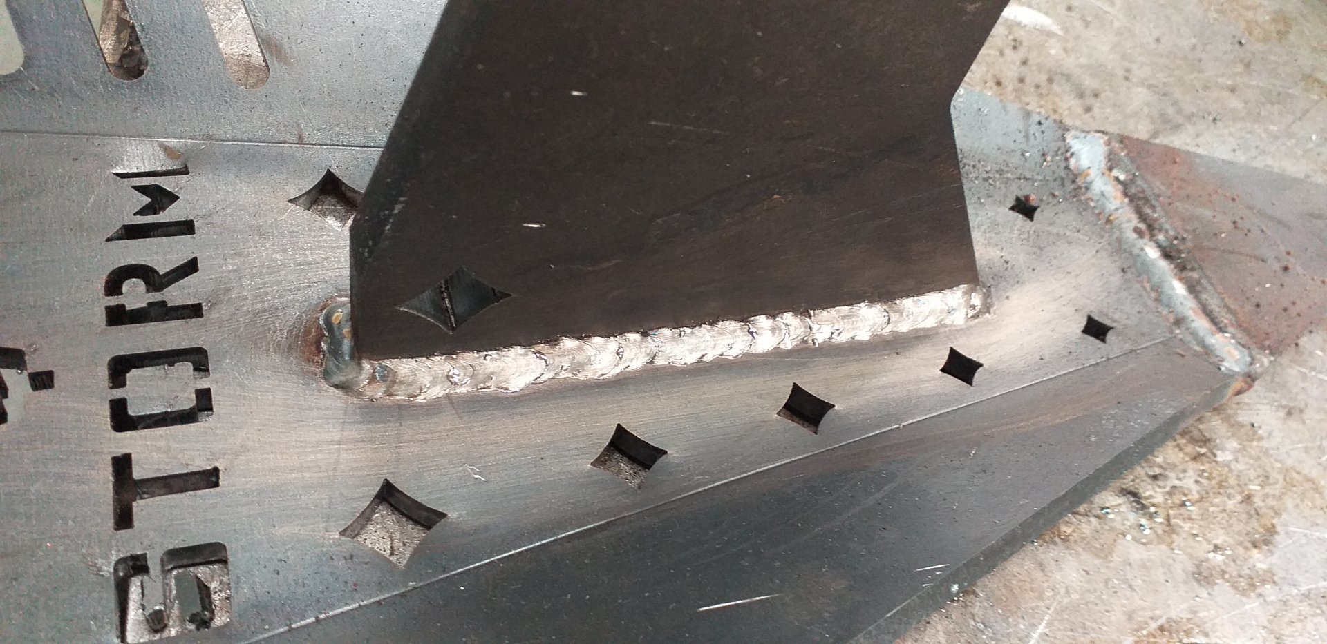

anchor "STORM" DIY
Shank= 20mm
Thorn= 20mm
Roll bar = 22mm
Fluke = 12mm
Wings (important parts welded on roll bar - not included in dwg) = 2mm

Great job. Compliments.
But if you cut here claw
And turn claw for 180 degree and weld it again. The anchor will dig much better.
Like this:
Or iven beter if you bend claw
You can not bend it because is small peace and it is strong.I cuted it to help me with bending it.

The V form tip you've posted looks like it's made of two parts. But why would the anchor dig better when the top side of the tip is even with the fluke ?
It looks to me like when the fluke top surface is lower than the top side of the thicker tip, then the fluke will have less resistance when the anchor is digging in . . ?

Is that last ‘‘lower ear’’ addition meant to put a brake on it, so the anchor won't dig in too far ?
Because wnen the boat pull chain, chain pull anchor and allways anchor firs turn to side and then dig inside.
