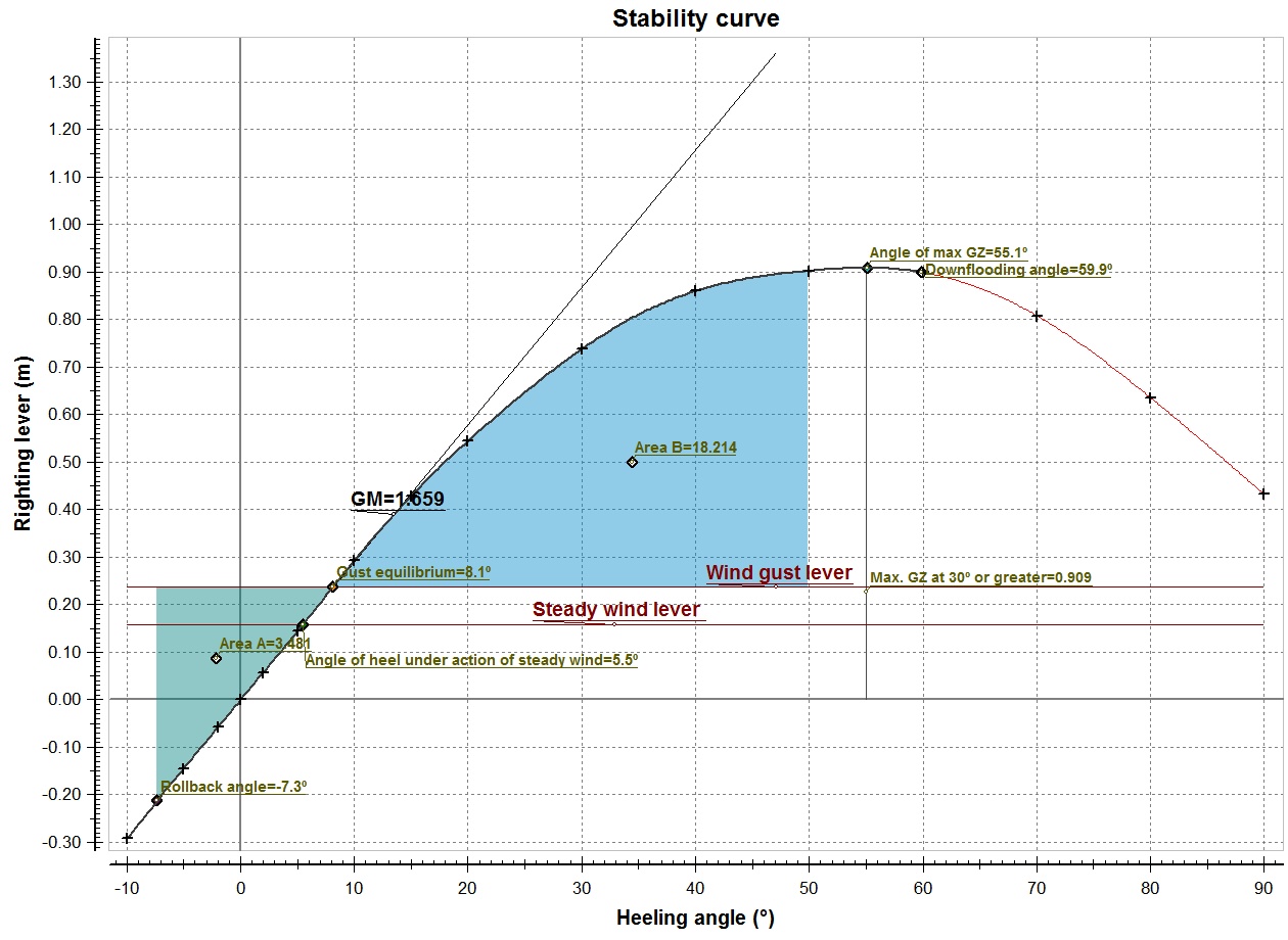

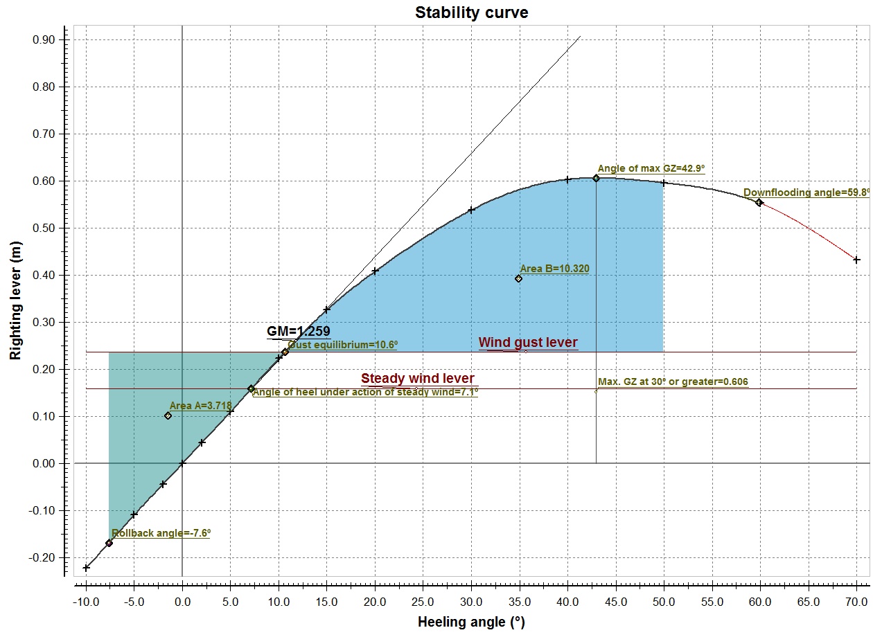

    All already know that IMO A.749 has new edition: IMO Resolution MSC.267/85/ which has come into force from 01.07.2010. In it roll back angle is determined for each vessel and for each concrete event of a loads / that is with different VCG / separately. Values, different than 25deg will obviously be received.

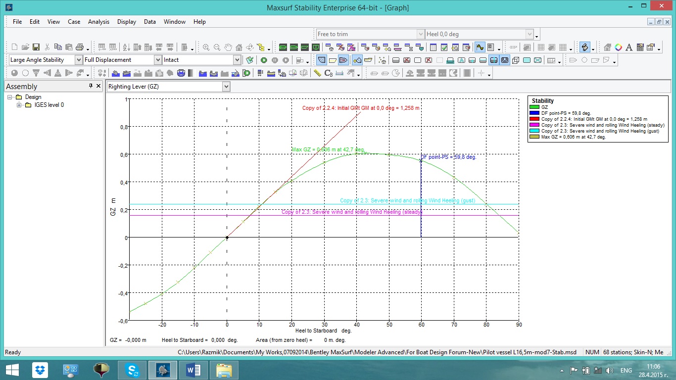

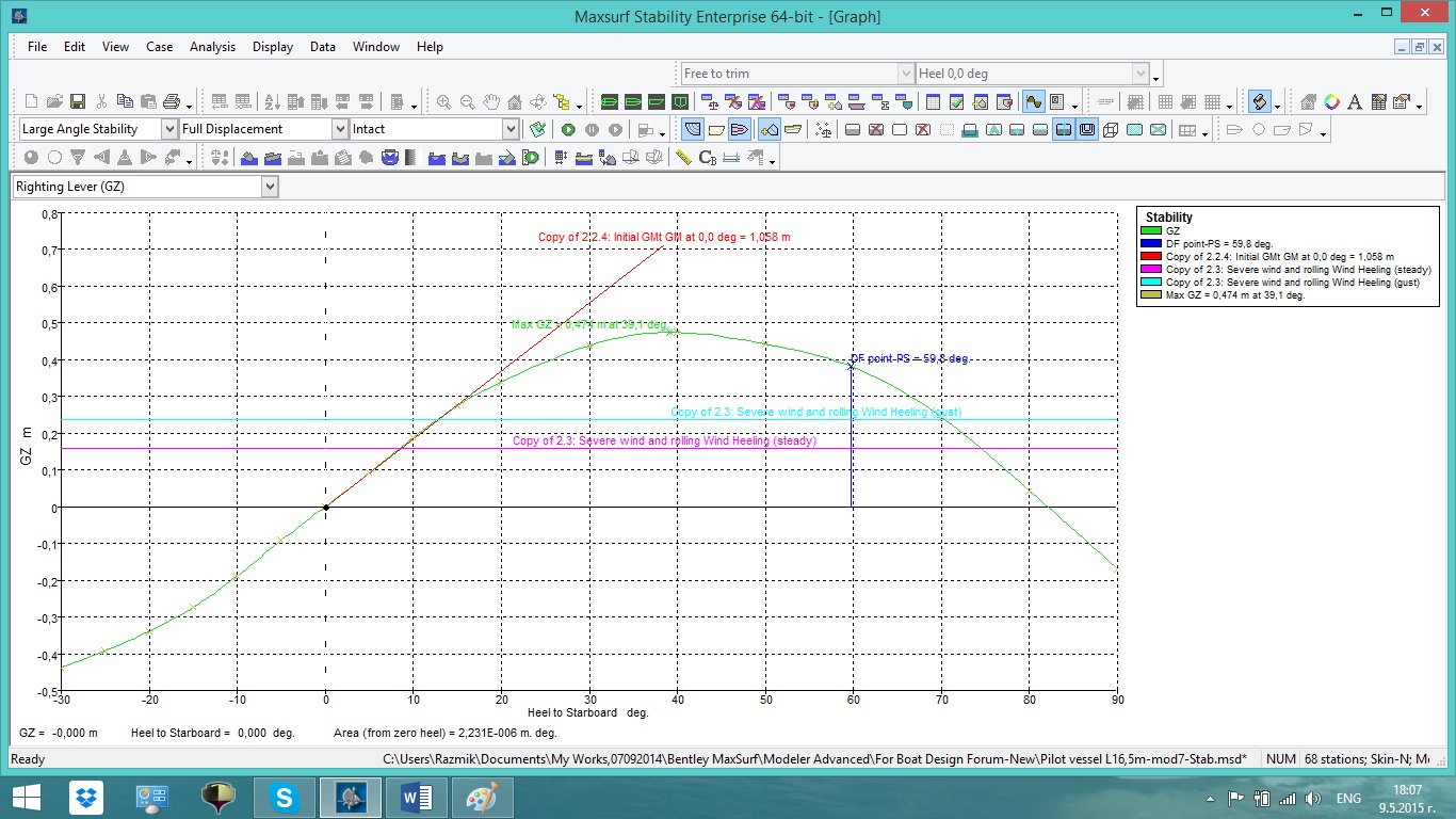

    In program Maxsurf Stability and Delftship Professional this angle is calculated automatically.
    Let's see what the position of the program Orca3D is.
    Here roll back angle is fixed on a constant 25deg as it is made at calculation of Intact stability for vessels of US Navy.

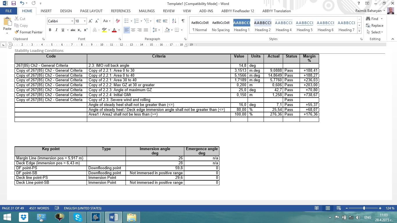

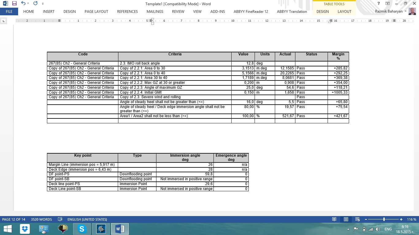

    To be approximated to requests MSC.267/85/ I have used the value received by Maxsurf Stability for model which I publish here.
    With the received value 12,8deg I have tried to create criteria, similar created in Orca3D /see attached PDF file/. I consider only criteria which concern to all types of ships. Not consider about intact stability at circulation or simultaneous congestion of all passengers to one side /crowding/.
    But in Orca3D v.1.4 WIP there is no capability to make a new criteria just so as they are required on MSC.267/85/.
    You see, that in my version there is only one heeling moment from a static operation of the wind /steady equilibrium/. There is no second heeling moment from a dynamic operation of the wind /gust equilibrium/.
    Therefore when it is compared coefficients of weather criterion K=Area1/Area2> 1 under the three programs, we shall see that at Orca3D /see Fig 6 and PDF file/ K=7,538 at VCG=1,0m from BL /i.e. 1,705m from the lowest point of keel/, and at remaining two programs accordingly: K=5,217 with Maxsurf Stability /see Fig 7 and Fig 8/ and K=5,235 with Delftship Professional /see Fig 14/.
    Calculations carried out for the model specified further in "B".
    This variance is received owing to the fact that Area1 and Area2 are defined in Orca3D concerning horizontal line of Steady Heeling Arm, but according to rules of MSC.267/85/ it is necessary to define concerning horizontal line of Gust Heeling Arm.

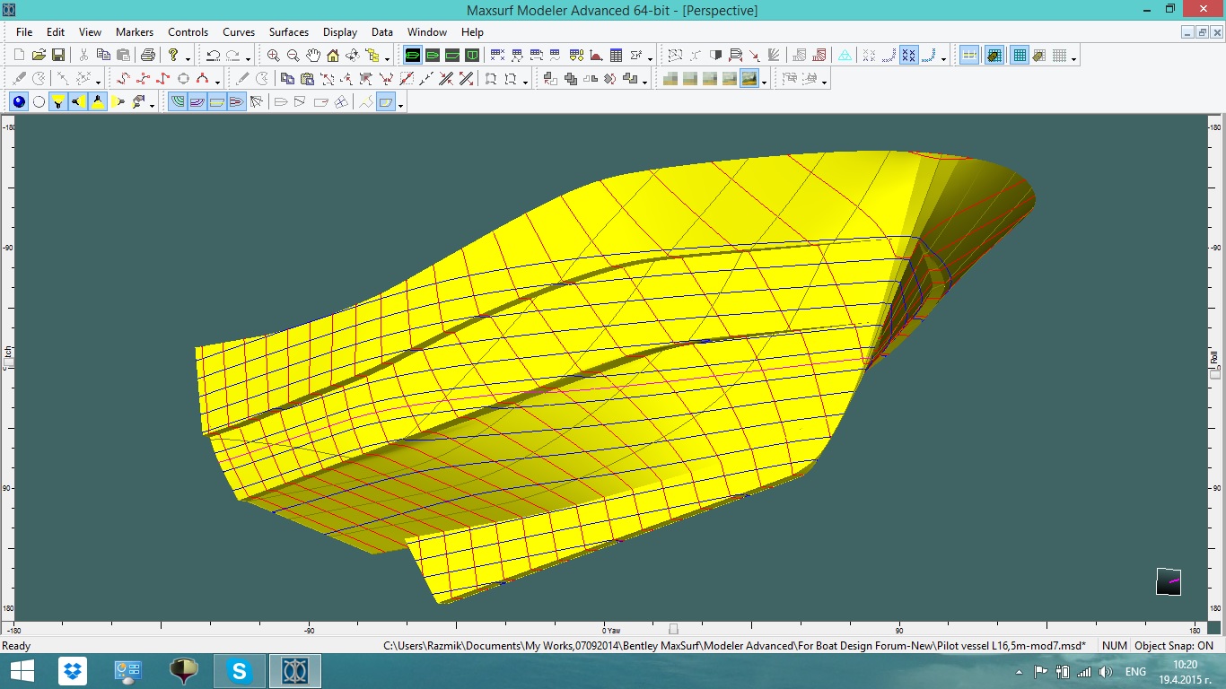

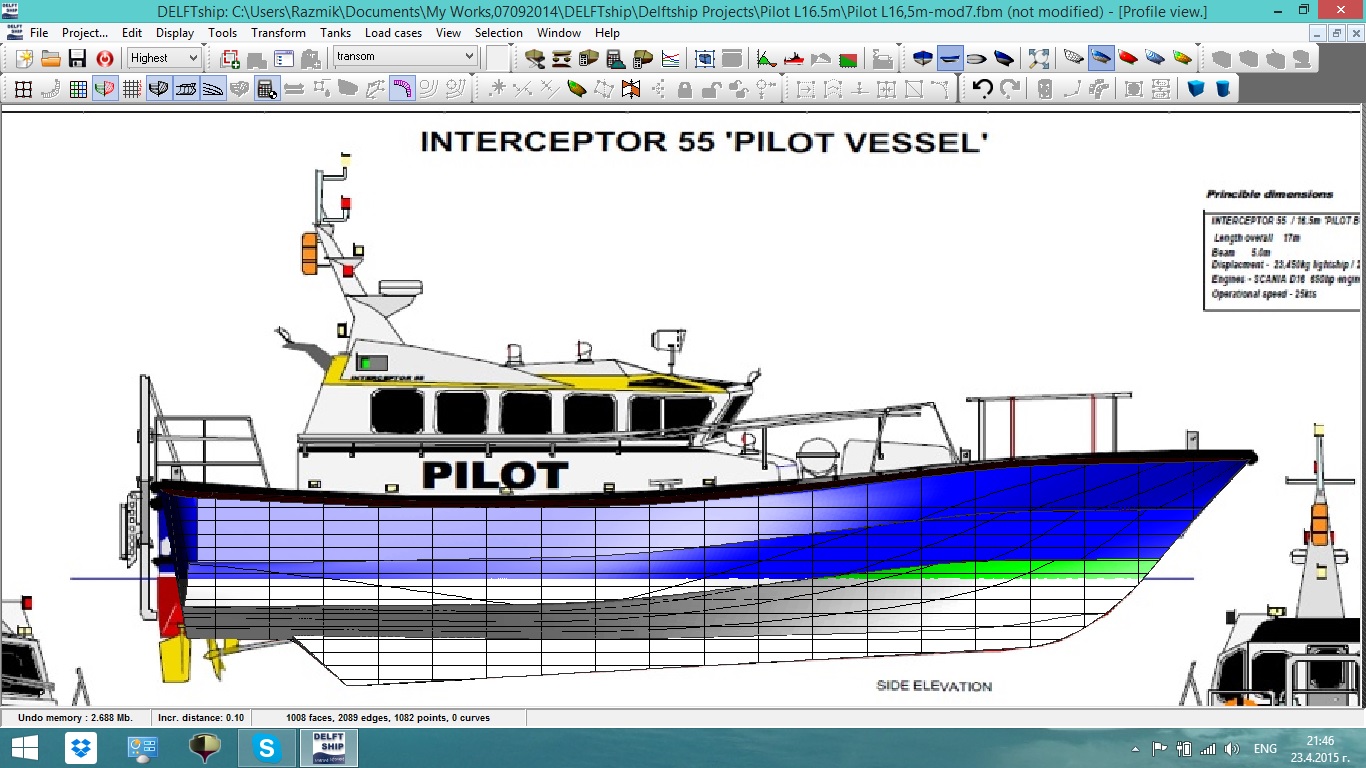

    When the Intact stability on Orca3D is calculated there is one more extremely unpleasant moment. But that it have understood, firstly it is necessary for you to meet with model. Published here model Pilot vessel L16,5m-mod is created by me under the drawing General arrangement /without Linesplan/, published in site Boat Design.net, as modification from prototype „Safehaven Marine” pilot vessel “Interceptor 55/16,5” for port Aden /see Fig 1 till 5/.
    This model has the following characteristics:
    Lightship 24t, Full Displacement 27t, material GRP
    L=16,5m; B=5m
    Maximum operational Speed 25-26kts
    Engines 2xVolvo D16, 650hp each
    CLASIFICATION of prototype “Interceptor 55/16,5” - Lloyds Register of Shipping (LRS) SSC Rules as applied to Pilot Vessels and United Kingdom MCA Category 2 offshore Pilot boat code /up to 60 miles from a safe haven/
    I have accepted BL apart 0,705m up from the lowest point of keel.
    If you want additional information about hydrostatics of this model and calculations on water drags and capacity /Planing analysis report/, see on site Boat Design.net: <http://www.boatdesign.net/forums/boat-design/creating-maxsurf-model-existing-design-52575.html>

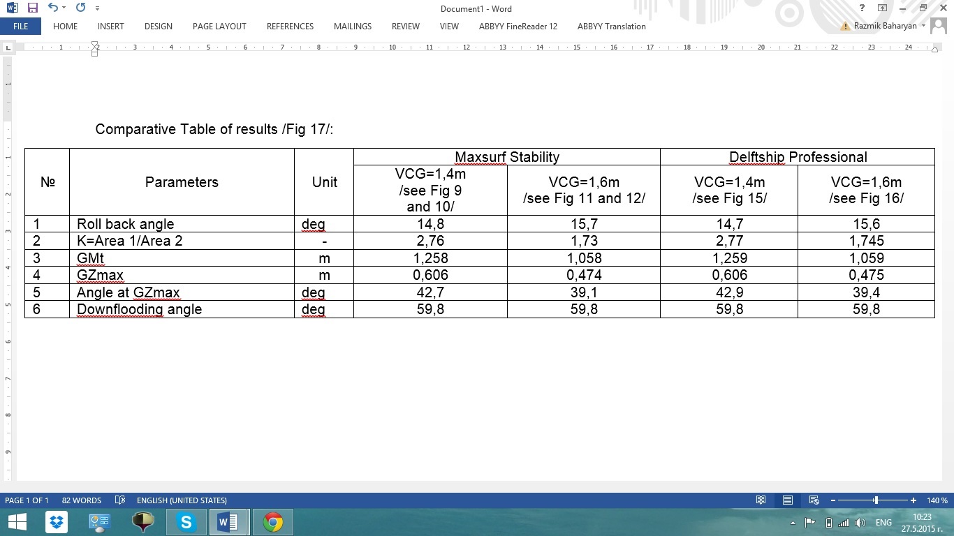

    As there is no information about CG of Full Displacement, I have tested on Delftship Pro how much there can be maximum value VCG that criteria of the International code about Intact stability IMO-MSC.267/85/ were executed. For calculation I put LCG=LCB=5,717m at D=27t /i.e. T=0,923m/.
    The maximum value was received VCGmax=1,75m /see Fig 13/.

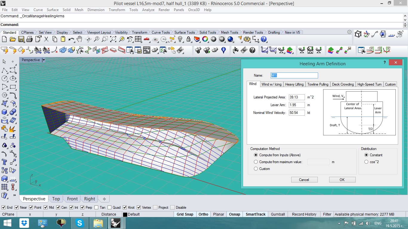

    But each attempts to make calculations of Intact stability on Orca3D with VCG=1,4m or VCG=1,6m blocked the program, but at other two programs acceptable results were received:
    Shared data at Т=0,923m are:
    - Windage area Aw=39,3 m^2 /see Fig 4/;
    - Center of Windage area VCGw=2,412m from BL /see Fig 4/
    - Coordinates of Downflooding points /Ventilation Openings for hull/:
    X=2m; Y=±1,55m; Z=2,57m
    - Full Displacement D=27t
    - LCG=LCB=5,717m
    Comparative Table of results /see Fig 17/
