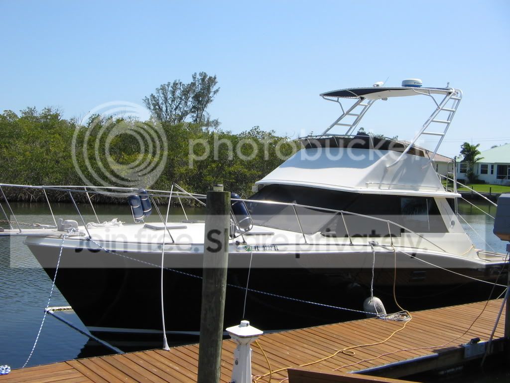

    Well, my boat is a 1982 F-36 Trojan with "flag blue" awlgrip. In person, you can clearly see the fabric in areas of the sides of the boat. The hull is 7 layers of glass below the waterline and 5 above with no coring.
    I hate the dark hull anyway - shows every damned drop of salt and dirt - but it sure looks good in pictures.

    Indeed - that boat is a beaut! Well, as long as it's perfectly clean, eh?
