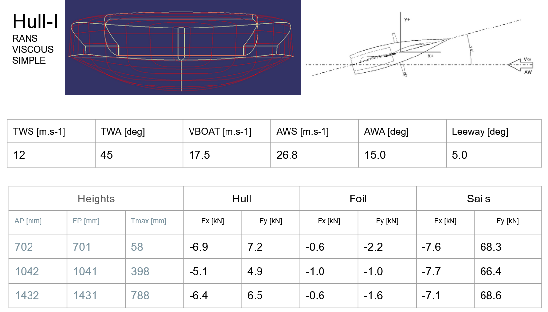

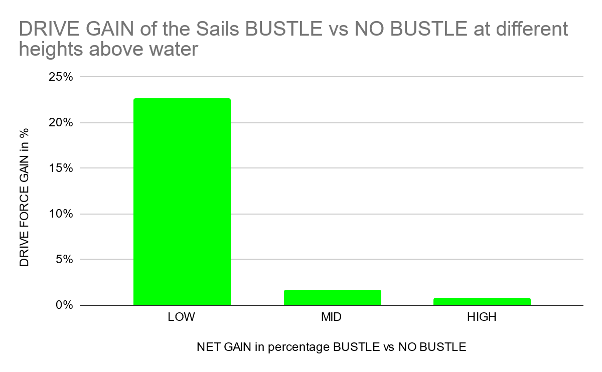

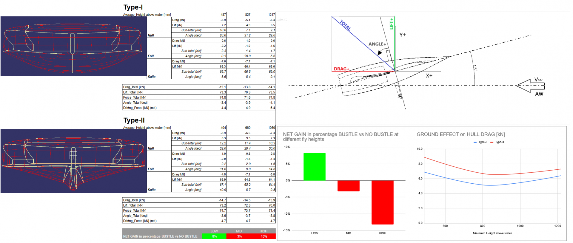

    Second serie of calculations. Same outline, same volume, same sails, same foils, keel line modified to integrate a "bustle".
    I'm preparing a precise comparison analysis between the two set of datas, and for that, some detailed post-processing of the results are still to be done. But for now, and with regards to the global table given down below, I anticipate the following conclusions, with regards to the aerodynamic behaviour of the AC75 plateform :
    - The AC75 hulls do produce a significant lift, and, consequently, an induced drag.
    - "Bustles" increase the ground effect on the plateform.
    - Without "bustles", the higher the better, from an aerodynamic point of view.
    - With "bustles", the lift produces by the sails is increased at low altitude, but the drag of the plateform is increased. The net result is approximatively neutral, in term of driving force left to equilibrate the hydrodynamic forces
    - Hulls equipped with bustles should fly low on the water to be better that hulls without bustle, at the same altitude. When fly height increase, the hull without bustle will tend to be more efficient than a hull with bustle.
    How can we conciliate the view of the AC75 designers with this study ? "The Lower, the better", from Benjamin Muyl, could be verified by this study, from an aerodynamic point of view. As pointed out by Mikko, the foils and the rudder do produce a high amount of wave drag and spray. We can then assume that the increase of these hydrodynamic drags with the fly height has a negative effect on the AC75 performances, by bringing the lifting surfaces close to the waterplane. Re-enforcing the principle of "the lower fly height".
    However, this study demonstrate also that the ground effect on the plateform create an additionnal parasitic drag, in order of magnitude equal to the drag generated by the sailplane itself. Without "bustle", at an optimal fly height, nearly half of the drag of the hull can be spared. Since "bustles" do also play a significant role in the take off and landing behaviour of the boat, their use seems "mandatory". In that case, can a good management of the flow around a "bustled" hull, brings the better of the two world ? My feeling is "yes", and I will show it in the next post. Stay tuned... Cheers,
    EDIT : In the file Results.PNG, second chart, in abscisse, it is not the "minimum" height, but the "average" height that should be read...My bad..
    Paul Scott likes this.

  10. Alan Cattelliot
    Joined: Jul 2021
    Posts: 524
    Likes: 220, Points: 43
    Location: La Rochelle (Fr)
    Alan Cattelliot Senior Member
    I agree with you. This point of view is also shared by Mikko. Calculations made tends to the same conclusion. The lower the better.

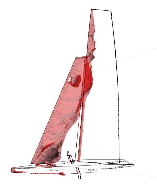

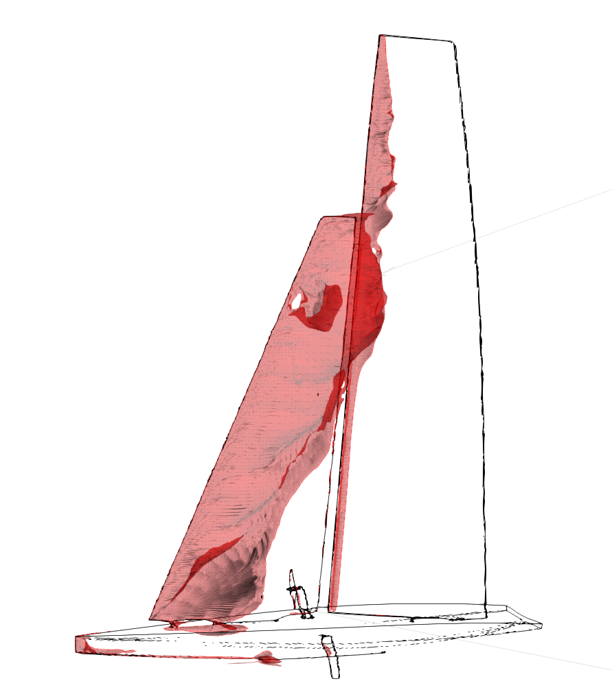

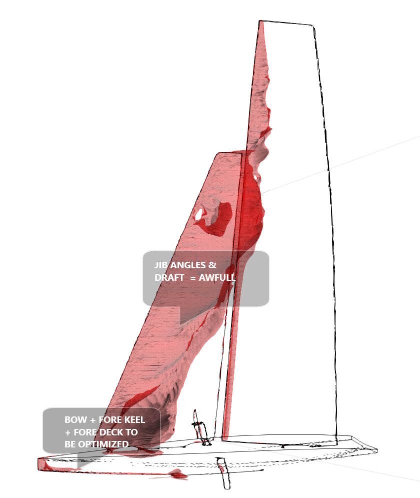

    On the other hand, the bustled hull drag is, in average 35% higher than a un-bustled hull. This additionnal drag comes mainly from the bow region, in way of the stagnation point, leeward side - a red region among the others in the picture down below -. I wonder if there is a way to minimize the aerodynamics of this region, seeking a -35% in the aerodynamic drag.

    Wow! :) That was unexpected . What does it look like without a jib? :rolleyes: Or no bustle under the bow? And the bustle moved aft under the main? Or would the stagnation point just move aft? What happens if the jib isn’t endplated? This is way cool!
